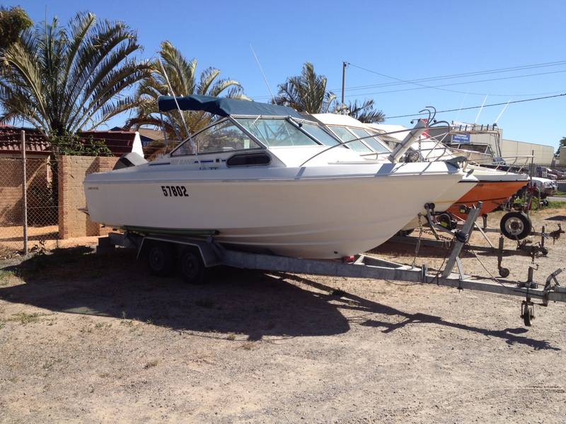

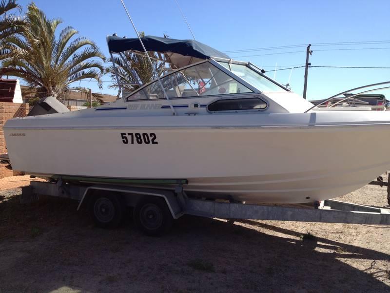

Currently in the process of buying an early 90's Caribbean reef runner 6.3m with a 225 Optimax on the back of her..
Im thinking of downsizing and putting a 4 stroke on the back.. Would a 130hp - 150hp 4 stroke be enough to power this baby along??
Looking at her, Id say she would weigh a fair bit.. Pretty solid boat!!

If it was me i'd be putting a 200 on it.
Its an Older, heavier fibreglass boat. With a 200 there will be power there if you need it and the motor would probably be more economical as it wouldnt be working as hard a  smaller one.
You dont have to use the power just cause its there, but it is handy to have. Would be worth the few extra $$ rather than have a smaller one fitted and find out that the boat doesnt perfom right.

That thing would be a pig of
Fri, 2013-01-11 13:22
That thing would be a pig of a thing if underpowered. I agree sight he other opinions. Really wants 200hp.

Keep the opti and see how you
Fri, 2013-01-11 15:13
Keep the opti and see how you go. Even a 225 hp 4 stroke wont have any where near the mid range torque the 225 hp opti has, so a 150 hp 4 stroke will be hopeless, and will chew juice!!!

agree with the general consensus. oversize is better than undersize in this instance. you would want a bare minimum of 200 horses on that hull.
its better to have it and not need it, than need it and not have it.
