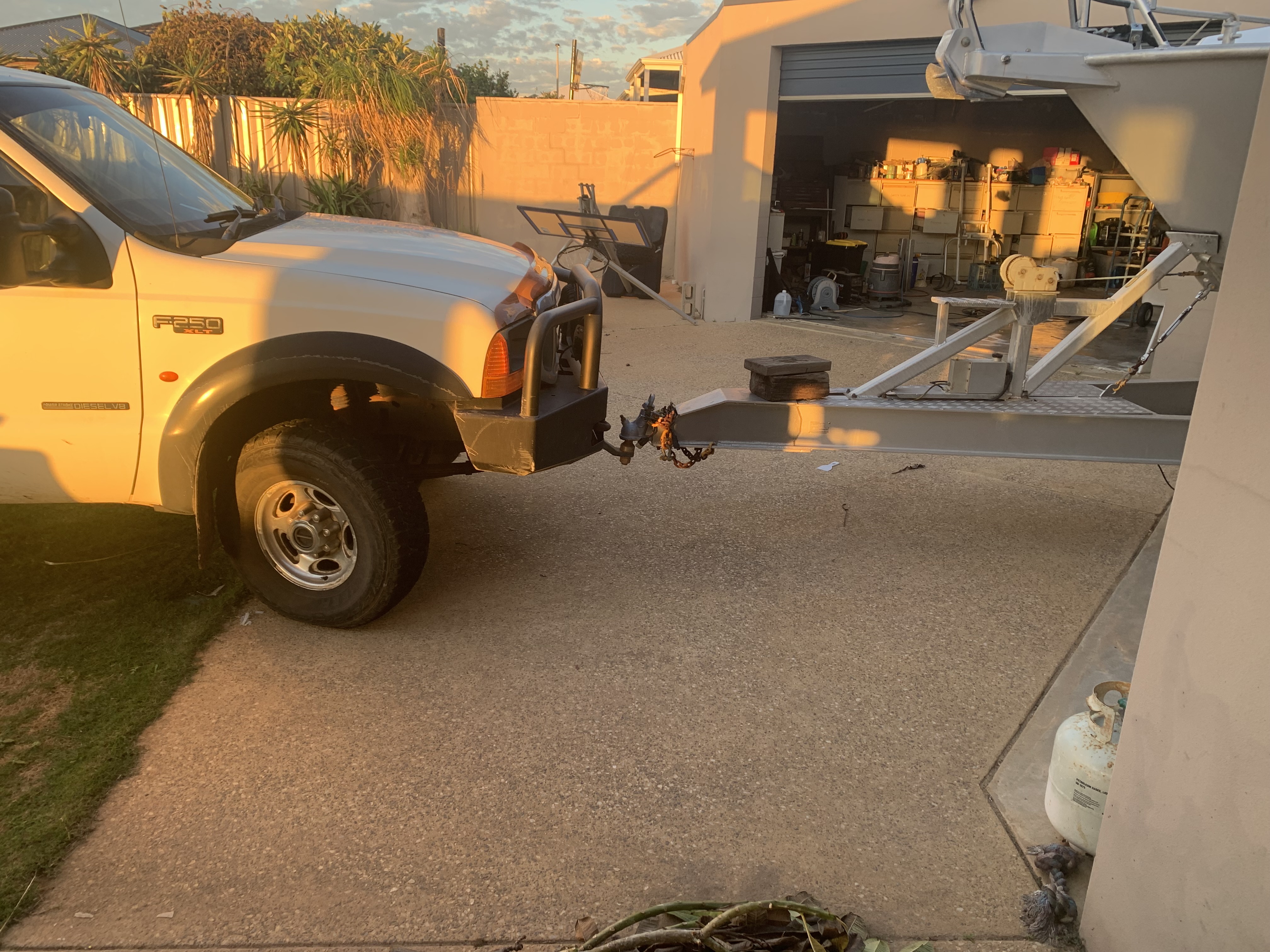

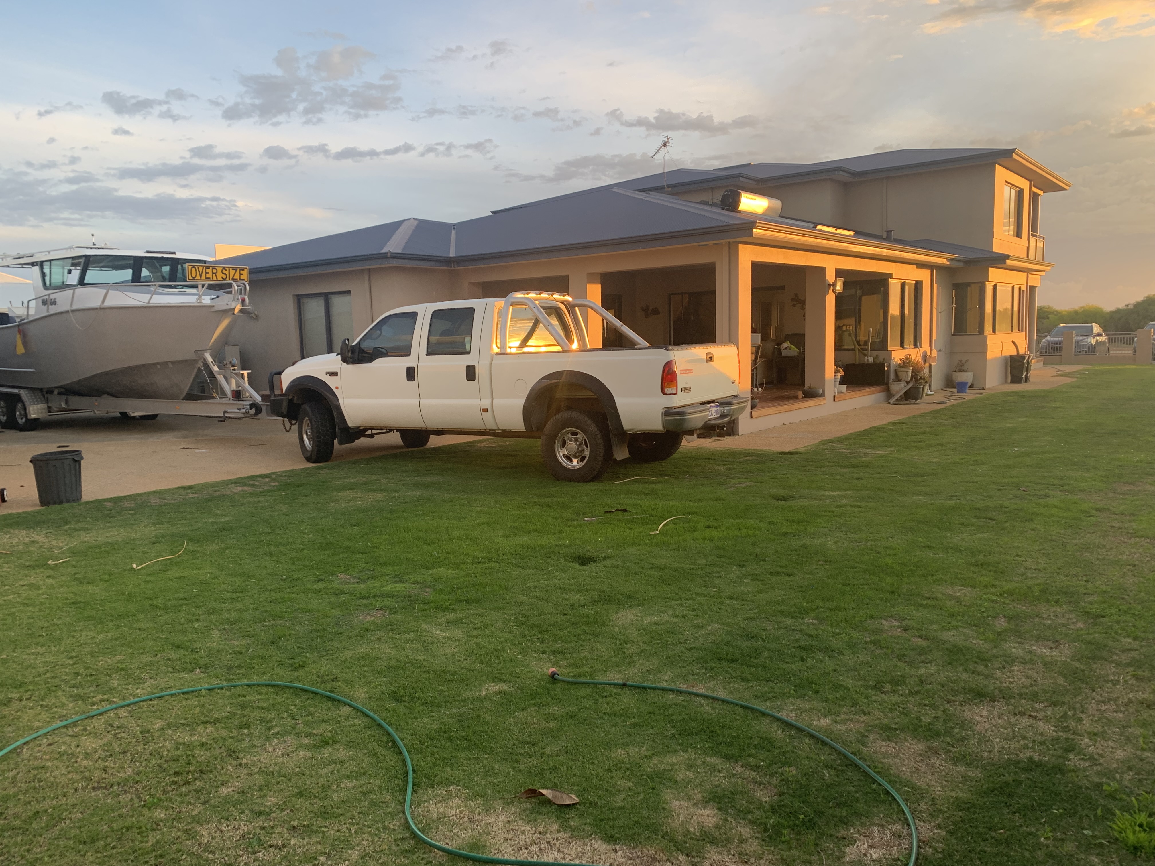

 I've been looking for ages in trailer movers etc, working out how to get my boat around a tight corner with the F250.
Impossible, and always needed to put the Landcruiser on it and even then a few goes to screw it around and flogs the grass.
Brain fart, fitted a tongue mount on the front.
Unbelievably easy, car wheels don't chew the grass, straight in first try , no backing up.
Im certain it's been done before, but I haven't seen it.
Went to scrap yard and got a brand new tow bar bracket and cut it up.

 Have had this set up for a few years, makes it insanely easy.

What about a draw bar extension to keep the car motor out of the salt water?
Hinge with removable pin off the side rail/beam of the trailer and a offset tow hitch that goes into the existing trailer hitch so its solid.
Have seen it add about 2m of distance and can be easily removed, great for the bay also..

 I've actually been
Sun, 2025-07-06 10:11
 I've actually been considering that type of set up for Gnaraloo mate.
But this works so bloody well at the Bird. Not having to turn on the beach is a big plus as that's where many go down.
Also like Rob pushing the boat back into my fairly tight boay bay makes it a cinch
