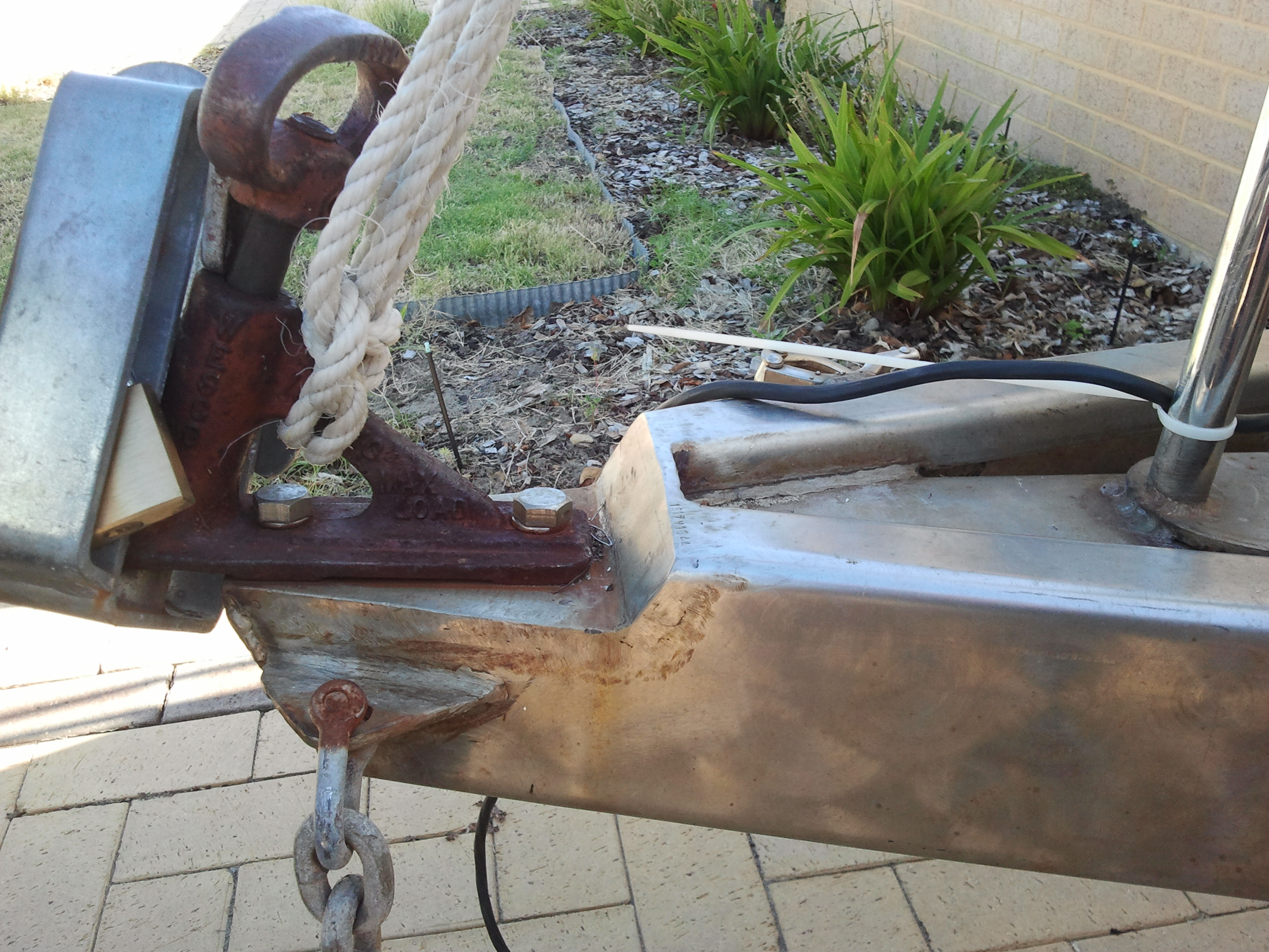

Trying to get the trailer than is under my project boat over the pits and licenced so that I can more easily (legally) move it around. It is a really solid looking stainless steel trailer so I'm pretty keen to keep it, but don't want to blow too much of my project budget on it. The problem comes in that the trailer (1980s built) was registered under the old rules where gross mass could be up to 1000kg without brakes. Because licence has lapsed a couple of years ago I need to put it over pits, and the new rules require brakes for over 750kg (rig is about 920kg dry).
I was initially not too worried as I'm handy with the tools and have replaced the whole running gear on my tinny trailer last year. Then I noticed that the hitch was offset downwards (see pic) from the top of the drawbar, and the mounting area is built for an unbraked hitch that is shorter than the braked hitches and has only 2 bolts down the central line rather than 4 (one in each corner) on braked hitches. So basically I need to figure out a way to mount a basic mechanical brake hitch securely to it so that it is level with the top of the drawbar.
Any ideas from some engineering, welding, diy types on the forum? Ideally ones that won't blow my budget out the water (so to speak).

i would probably
Thu, 2013-01-10 17:47
cut a piece of 10mm stainless plate to sit along the centre line of the bolt holes that are there now.cut another piece of stainless plate the shape you need to mount your
tow hitch onto.weld the piece of flat plate onto your tow hitch piece and then sit the whole thing on the trailer and fully weld it on.
probable doesn`t make sense but i can see it in my head LOL!!!!!!

 Hey Keg, kind of get what
Thu, 2013-01-10 22:33
 Hey Keg, kind of get what you mean. However, the words stainless plate and welding present a problem from a DIY point of view. Was hoping I would be able to sort this myself, but probably going to have to turn it over to a professional and just cough up the cash.

Posts: 8691
Plates
Fri, 2013-01-11 06:56
What you need is 2 pieces of 12mm plate, wouldn't bother with stainless because the hitch won't be stainless either, bottom one to use the same bolt holes for the hitch to secure it to the trailer and the upper one have 4 holes for the new hitch and two large holes to accommodate the bolt heads for the bottom plate so they are concealed between the 2  when all bolted up. Use the two stainless bolts to secure the bottom plate , that way you won't have to worry about them rusting away.

That actually sound pretty
Fri, 2013-01-11 21:07
That actually sound pretty good - and you're right, no real difference between attaching mild steel hitch to the stainless or mild steel adapting plate. Might see if I can pick up some suitable steel plate... any ideas on somewhere that I won't have to buy a huge section of plate or long length?

You can easily weld "Normal"
Fri, 2013-01-11 09:53
You can easily weld "Normal" steel plate onto SS even with an arc welder, just get the right welding rods.

 Mild steel or stainless, the
Sun, 2013-01-13 10:29
 Mild steel or stainless, the welding process is identical, just need the correct 316L rods and youd need to buy a packet at couple of hundred bucks maybe

If you are going to weld a
Fri, 2013-01-11 10:06
If you are going to weld a plate onto the trailer , I would use stainless.
You could tow it down to any fab shop and they'd put a run around it.
