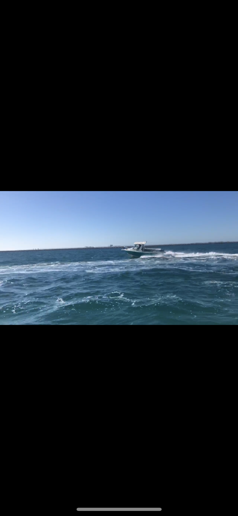

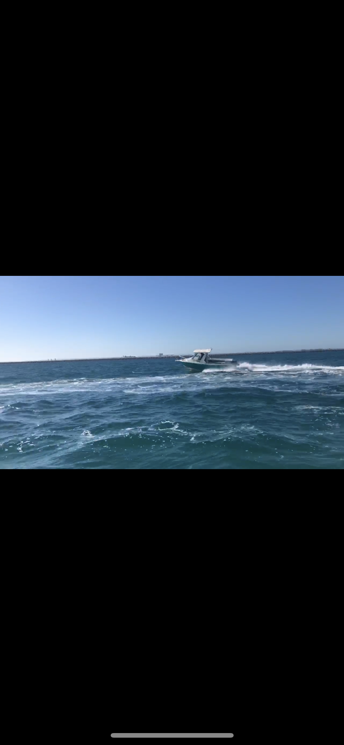

took the project boatbot out on the water this morning, went well but a few thing I need to get my head around.
stability: the boat is pretty much empty. No fuel
tank in it or anything. Just engine and me and my othe rmate who came out this morning with me prob 150kg combine. We found that the boat is a good sea riding hull but I think it’s lacking in the stability region.
not sure that it’s pretry much a empty hull with a 170kg engine on the back only wouldn’t help it’s cause.
would love to get people thoughts and experiences on this and if they think when I add the 250l fuel tank in it that it all. The hullnis 6.2m 7.3LOA. 6mm bottom, 5mm side and transom with steel bar rolled keel
help

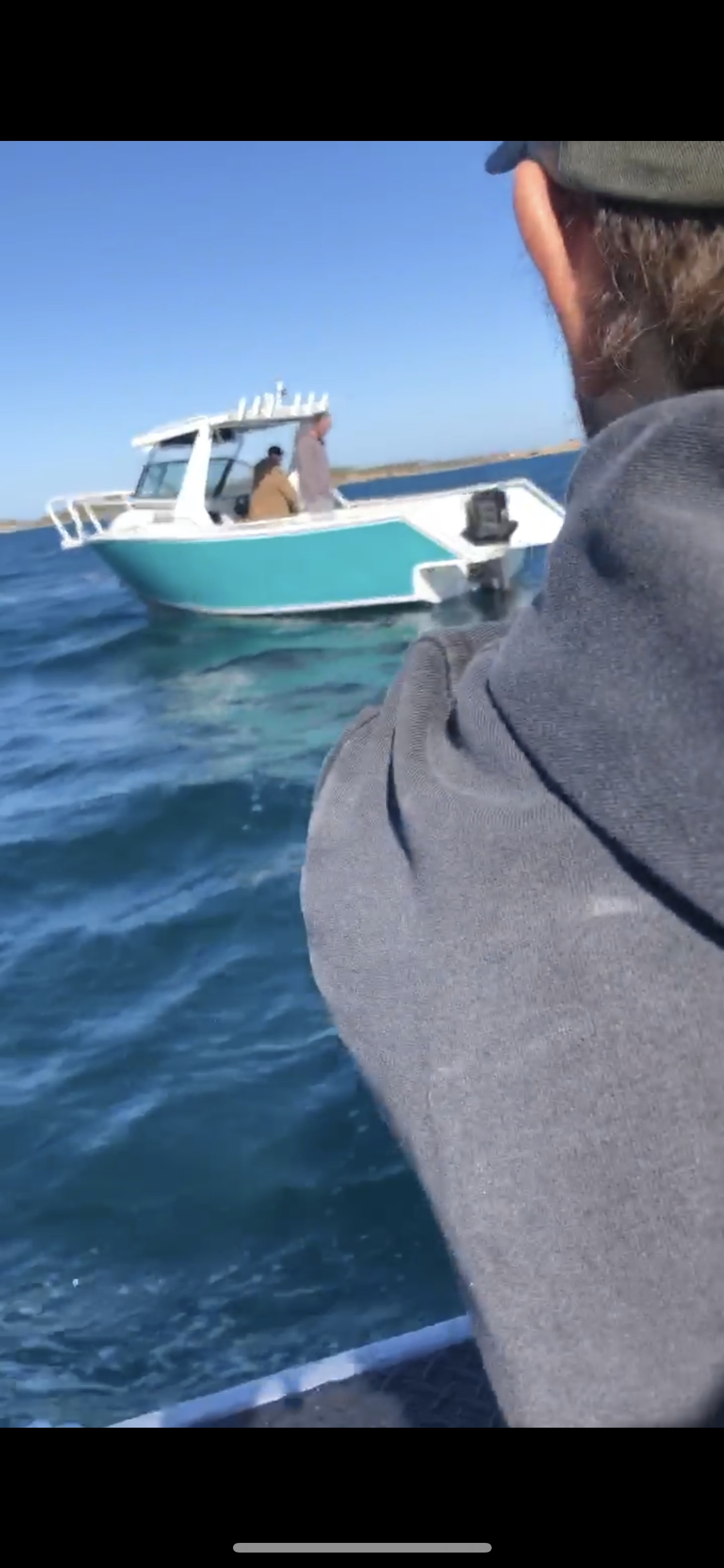

What exactly is it that is causing you concern, when you are at rest is the boat healing over at an alarming angle when you move over to one side with one or two people.
Is the boat at rest moving around wallowing (side to side movement) when you walk around the deck.
Is the boat pitching ie; when moving forward or aft to a great degree which is inconsistent with the amount you expect with the weight movement, bow diving or stern dipping when moving aft
From the photo (2) the boat seems to be sitting down on the chines in the water which to me is where they should be, just my opinion.

 It was just listing over
Sun, 2019-07-14 17:05
 It was just listing over while travelling and a lot of listing at rest when walking around the cabin.
drove well and cut through the water nicely. Just was abit unstable at rest and more listing than I am use too.

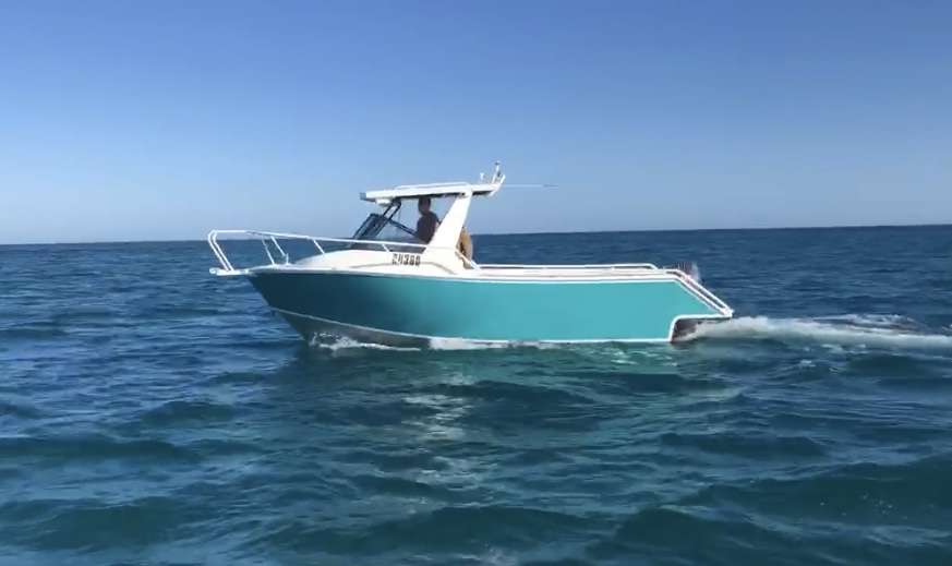

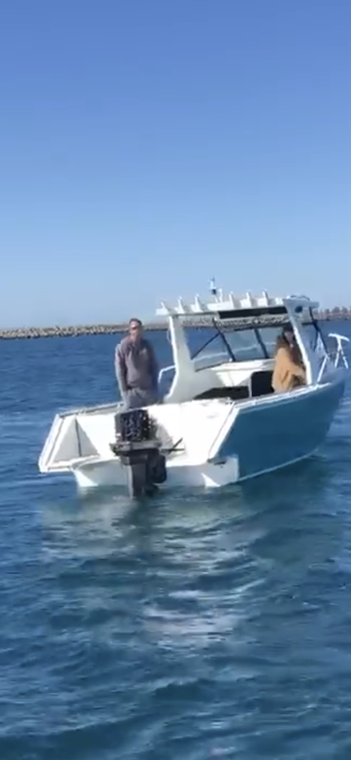

Just added two more photos.
Sun, 2019-07-14 17:09
Just added two more photos. Not the best but you can sorta see how high it sits and also from the transom, how much  does get exposed when rocking.

Weight is as used
Sun, 2019-07-14 17:15
You should put the weight in it that it would normally have before you sea trial like that. If you want to ckeck it before you commit to building tanks and fitting it out then use water barrels.
Think about how bar crusher ads a lot of ballast water to their hulls when in the water so they are more stable. I think you'll find as you add the correct weight to it like interior fitout, fuel tanks (not just the fuel), safety gear, wiring, electronics, esky etc you'd be up another couple of hundred kg and then your fuel, water and passengers would all add more.

 More weight will get the
Sun, 2019-07-14 18:13
 More weight will get the chines sitting in the water making it more stable.Looks quite high out of the water in the photos.
