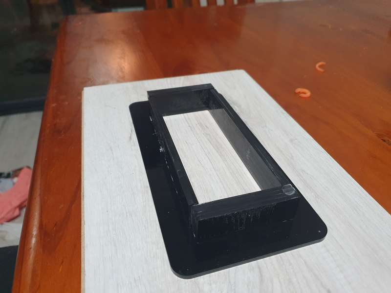

I’m looking at upgrading my VHF as it’s around 12y old and a GME and looking at the Icom M330G. My issue is that the GME has a dash cutout of 157x58 and the Icom is 139x53 leaving me a gap of 18x6 through fibgreglass dash backed by marine ply. Can anyone point me in the right direction of clips etc that I can use to sit the new radio in the existing cutout or would I have to build it back up with ply/HDPE?
The face of the radio is 156.6x66.5 so if there’s a noticeable gap at the front I plan on getting some carbon fibre plate to hide it.
Cheers JF

I had same issue in my ally boat
Thu, 2019-06-27 11:17
used whiteboard .....actually looks pretty good, beveled edges to “merge”

I did the same on my last
Thu, 2019-06-27 11:37
I did the same on my last boat. Made an ally plate that went over the bigger hole.

Carbon fibre looks good.. but
Thu, 2019-06-27 11:45
Carbon fibre looks good.. but white plastic or a jig sawed ally sheet goes just fine

Ally Plate, then get it
Thu, 2019-06-27 12:02
Ally Plate, then get it powder coated.

Ended up getting some black
Tue, 2019-07-23 07:15
Ended up getting some black perspex laser cut and have welded all the pieces together with acetone. Seems to be a stong bond so hopefully she does the trick. Pic is above.
