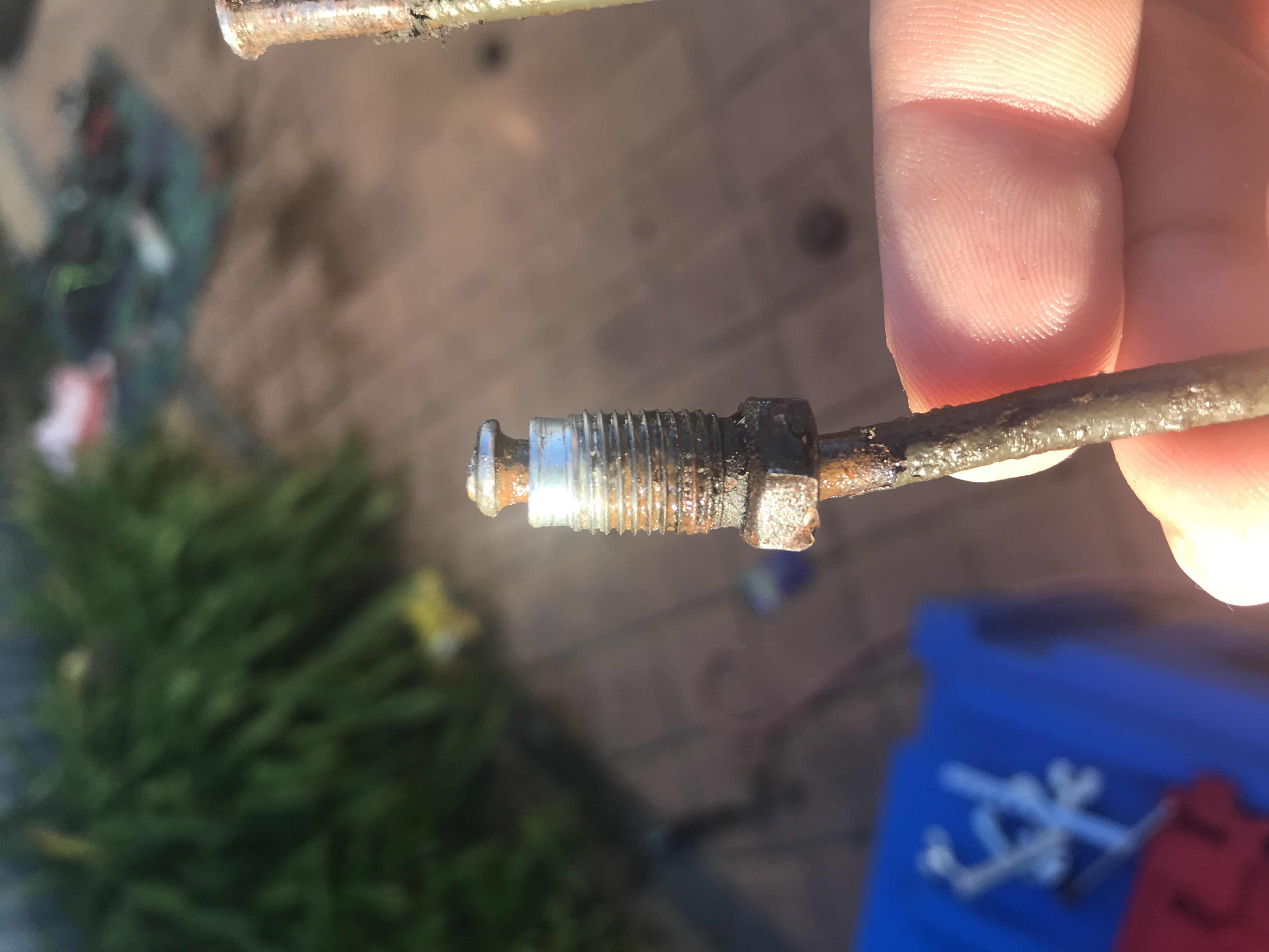

In preparation for our Exmouth trip next week, I changed all of my bearings and brake pads last weekend and noticed that my brake lines were quit badly corroded. I actually decided to crank up the pressure on the handbrake and surprise surprise, identified a leak/weep inside the drawbar.
I went to Martins 1hr before closing yesterday and picked up a stainless braided hose kit. Unfortunately the fittings/nuts on the kit are too short. The treads on the fittings I removed seem about 3-4mm longer so the hose flair is 3-4mm from seating. The thread is the same although there is a slight difference in the female cone of the nut.
I’m not going to be able to return the hoses as new given some of the “trials” to get it working so do you know of anywhere who could re-crimp the correct fittings? Photo of the old fitting that fits the master cylinder and calipers.
or should I just drop the hoses and start again with copper tubing?

do the flex
Is it at all the connections or just the master cyliner?
I seem to recall the master have an adaptor that is needed, but if the old flare fitted and sealed i guess thats not the issue but maybe an adaptor would get you out of trouble.

Cutting and reflaring the stainless could be risky, definately get a pro to do it.

Long thread not that uncommon
Long thread not that uncommon on brakes. Enzed will either have one or make one for you, and be ADR approved. Probably not the cheapest but if you have a tight deadline...Might even swage the correct end on your line, but more than likely want to provide the whole hose to be ADR approved.

i had the same issue
i had the same issue recently, you can get the adapaters from martin trailer parts.

Yep as jng said you can get
Yep as jng said you can get the adapters to suit.

Thanks for the responses
I took the hose to Pirtek to get the one end replaced that we "trailed" the cut a re-flair option. Unfortunately only after cutting the end off did he determine that his crimp fitting wouldn't install in the hose. Hose was now even more rooted
Went to Martins Trailers Parts and they provided me with the adaptors and copper washers. Told them the story about the hose and he asked to see it... Went and grabbed it from the car and passed it over the counter to be thrusted an new one and told to clear off... I question if he was sure, to which I was told to leave before he changed his mind.
Excellent service that went far beyond what he needed to do! Hope it all goes toogther now!
