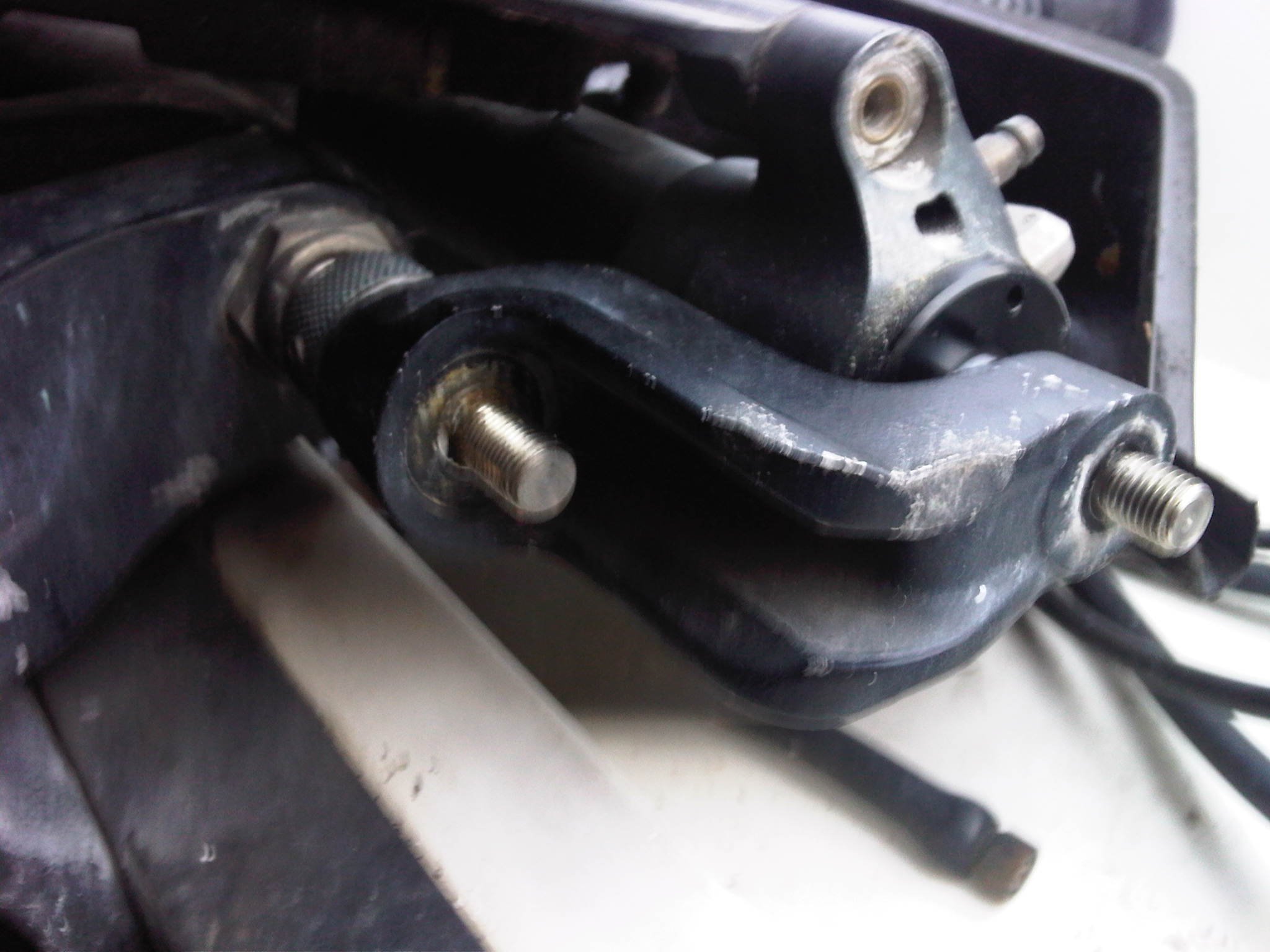

Having some trouble with a steering ram on a boat.
It was weeping some oil, so going to take it off and get it looked at by somebody.
I have unbolted the lines from it, and taken off the bolts that hold it in, but the ram itself goes through a bracket on either end, with a nut on the end of it (see bolt on the ride hand side of the photo).
To get the ram out, I assume I have to remove the bracket from one end, to allow me to manoever it out. I have undone the nut (left hand side of the shot), but the little bracket bit will not come off the shaft.
I've tried persuading it with a hammer and a few other bits and pieces, but it doesnt come off. It doesnt look like it is seized up, and when force is applied, you can move it up/down/left right very slightly, but it wont go forward and backward (ie - come off).
Is there a knack to this?
Cheers!
Dan

Penetrant and rubber mallet?

Penetrant and rubber mallet? Bearing puller? Got some duralac for putting it back together?

Heat
Sun, 2011-07-24 20:19
You may have to heat up the ali not the shaft then crc tap shaft with block of wood and hammer worked for me years ago on old merc
Ok cheers, so it definitaly
Mon, 2011-07-25 09:14
Ok cheers, so it definitaly does just pull off? I didnt want to go all out on it in case there was some knack to it.
When I wiggle the bracket it looks like the bolt that sticks out the end was moving also, which made me think perhaps that bolt was part of the bracket, and some how attached (perhaps screwed on)to the shaft behind it closer to the engine.
I'm going to find out how much a seal kit is for the bloody thing, as it is only $400 for a brand new one from the states, but in either case I have to remove the old one first.

Just womdering
Mon, 2011-07-25 19:44
Looking at the threaded shaft on the LH side of the bracket, there appears to be a knurled (finger adjustable) flange on it. Am wondering if the bracket is threaded the shaft is screwed through it, and that this is some kind of adjusting sytem, set by a lock nut on the end of the shaft. I don't really know, just looking at the pic's.
Yeah I was wondering this
Wed, 2011-07-27 09:29
Yeah I was wondering this also. Thought this might be why the threaded bit was moving when we moved the bracket.
Really not sure, don't want to go all out on the thing if this is the case.

Shaft
Mon, 2011-07-25 21:19
If it is an old merc grease goes had in shaft tilt motor up see if there is a grease nipple in shaft housing take it out apply heat to housing or try pumping diesel into it then tap with block of wood a bit at a time from both sides it's slow but works

I agree with Tomcat
Wed, 2011-07-27 09:39
If the force is applied to one side it will cause a torsion like effect on the other bolt. Unless you can hit it dead centre gently youll need to go bit by bit, left then right to "wiggle" it off.
