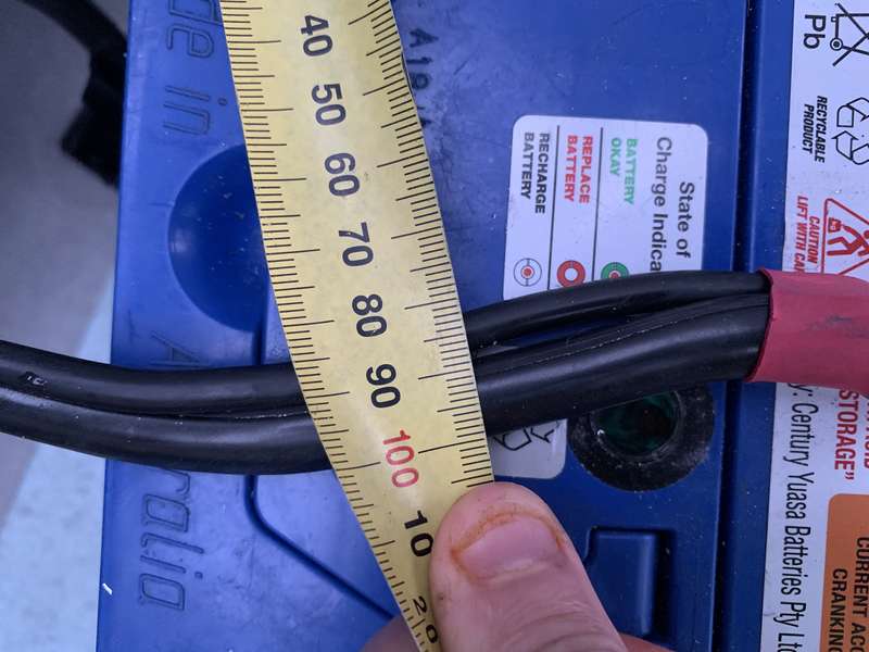

gday guys,
redently got a new 200 Honda fitted to my project boat and I’m half way through moving the batteries Into the enclosed cabin. Looking at around 8m of cable prob around 6 but not too sure about the size of cable to use for the extension. This is the size of the cable that it has already looks about 10mm single core and 5-6mm single core also.
any help would be amazing. Thanks guys.

Hi Paul, it's 2awg on the
Hi Paul, it's 2awg on the large positive and negative and 4awg on the smaller positive
Ideally i would consider running new cables rather than making a join but I guess if it's joined properly and protected from the elements it will be ok. I don't like seeing joins in the main backbone though.
