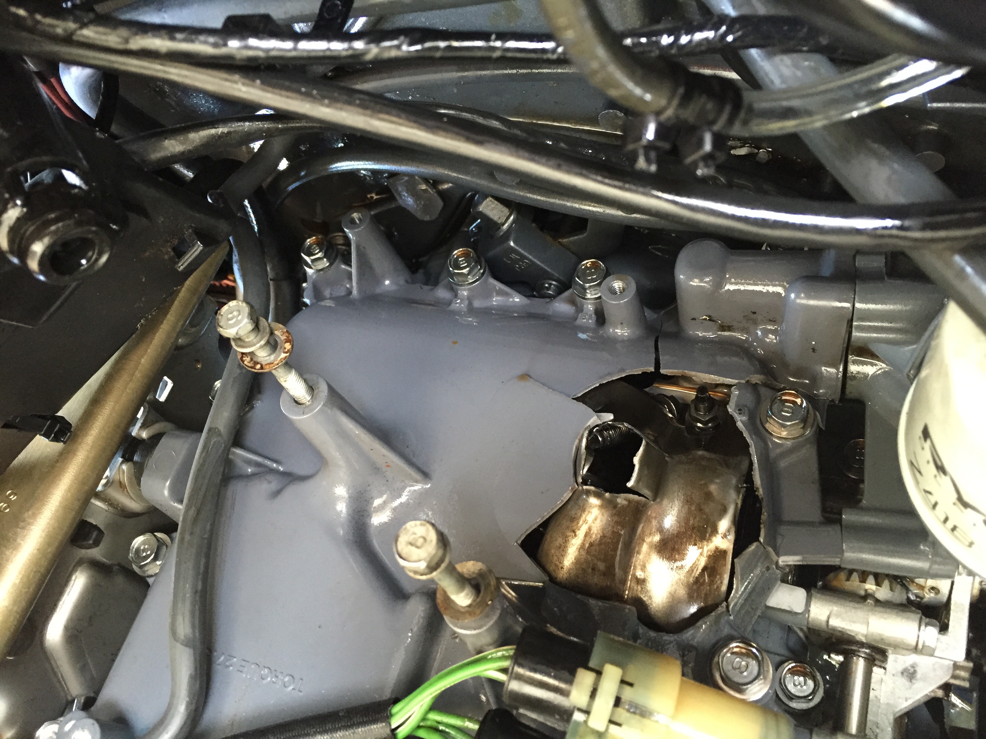

Put a conrod thru bottom of engine the other day which was slightly disappointing to say the least.
Anyone know of a good dealer/trader where i can a replacement powerhead?
Its a F225hp 2004 four stroke.
Cheers for your help in advance.

Hours ?
Mon, 2014-11-17 06:57
therock,
Curious as to how many hours on the motor, and also do you have any idea what caused it to let go ?
The reason I'm interested is that that I'm also running a 2004 model F225.....................
Posts: 33
Date Joined: 30/10/10
Narrowed it down to bolt
Mon, 2014-11-17 08:04
Narrowed it down to bolt fatigue on big end bearing.
Shear the conrod and punched a perfect hole in sump.
This was first trip after rebuilding boat and swapping from IO to OB.
