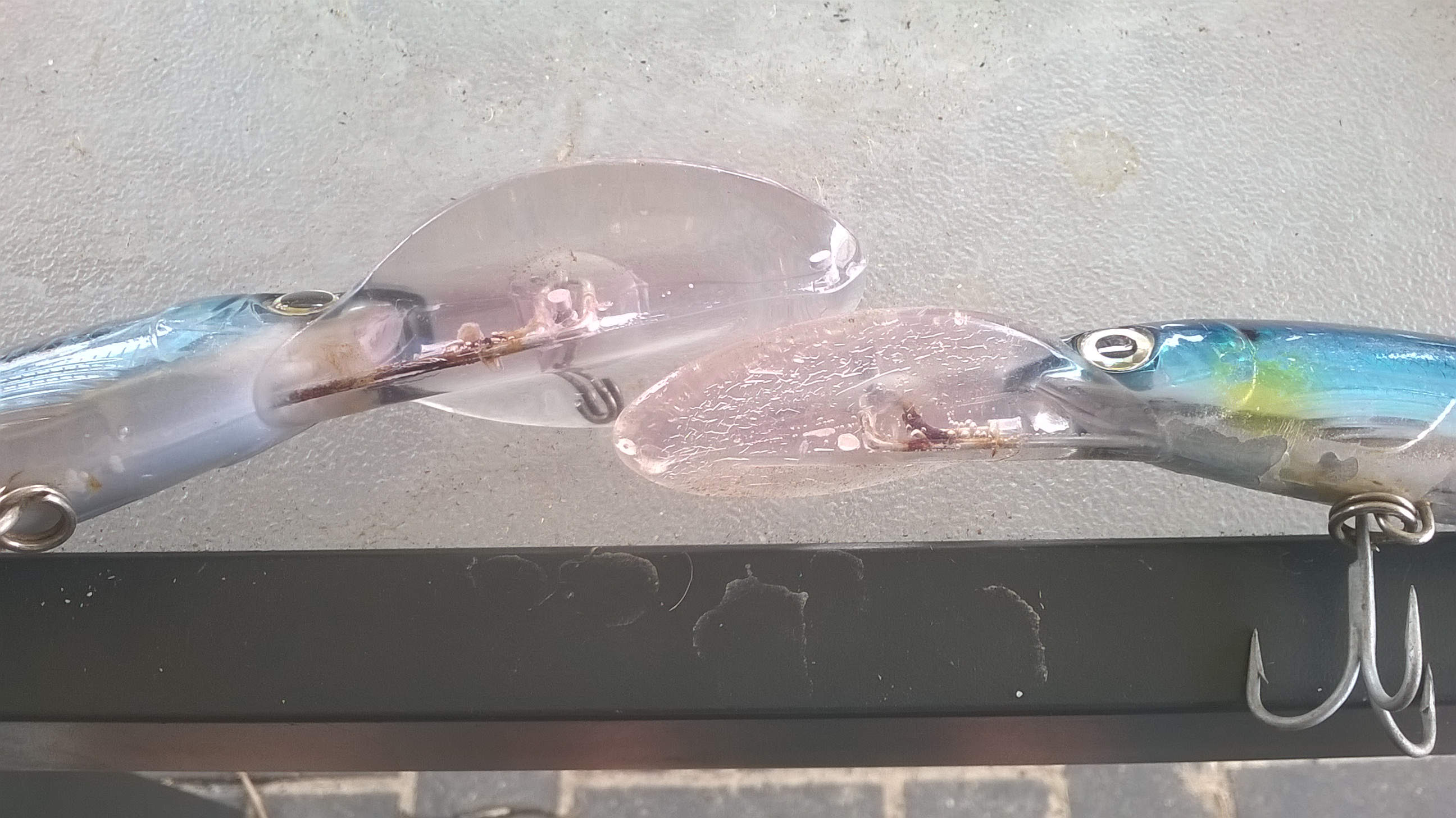

 All of my Xrap Mags, in both 20 and 30 sizes (5 lures) have suffered water ingress and the wire that runs through each lure appears to have rusted through...it seems any future run-ins with any macks/tuna could result in tears.
I wash my gear religiously after every trip, so could very well be the hose water trapped inside. Any similar issues with you mob, and tips on preventing more ingress?

 I've had the same happen to a 20. The actual lure has water inside it.

Even before Xrap entered the market, I found some of my Fat Rap deep diver suffers the same issue. During the olden days Fat Rap Deep Diver comes with wired through construction with the wire loops that extends well into the body of the lure clearly visible from the bib. But since the new plastic Fat Rap came out, it's a just a short looped tow point that's impregnated into the plastic bib. Not wired through at all. Also, the newer loop rusts just like the X-rap and I found that to be true for all lures that come out of Estonia instead of Finland - that's pretty much ALL rapala lures these days.
On the same note, I found some of the expensive Jap lures suffers the same problem. The exposed tow points & hangers (belly & tail) are not sealed properly. Instead of super glue, I use clear nail polish to seal the gap. 2 coats generally works but it is best done straight out of the box brand new rather than after the 1st use because some salt water inevitably remains inside the lure body, corroding the wire slowly. Sealing it is not going to stop the internal corossion.
To prevent rusts on lures hook hangers & trebles, I generally soak the lures for 10-20 minutes in or spray generous amount of diluted SaltX solutions to all lures used in saltwater. SaltX dissolves NaCl to make it into a harmless compound and it seeps well into the nook or cranies of any hook hangers. So far it has worked for me.

As discussed, the surface rusting of the internal wire near the bib had been addressed by the factory in Finland. All X-Rap magnums 20 and 30 now have a acid proof wire that is designed to prevent corrosion. At times, it may look like water bubbles appear inside the bib. However this is only air bubbles inside the resin. If the lure wire happens to have some surface rust, the performance is not compromised, we have had no issues with fish being lost as a result. Always there to support the retailers if there is any major issues with customer dissatisfaction.
If you have any further questions, just let me know.
Thanks,
Rapala Australia"
Cheers,
Todd
CACW Nedlands
Don't forget to Like us on Facebook
Am I reading this right
Fri, 2015-04-24 17:16
I can't see where the question about water being inside the lure has been addressed.
The issue of rust forming on the wire, "suck it up princess" appears to be the answer. What a sad response from a supplier of lures that are not cheap.
This is not the problem of the retailer. The acid process to the wire is failing and the sealing of the wire/body interface is failing and allowing the ingress of water. That's the way I have read things. May be the agent for Rapala should advise the Rapala company quality manager to log on to F/W and have a look at the posts RE: Rapala lures.

Hey know it is an old post but have recently moved to the north QLD coast from WA and bought some x-raps had a bit of success with them but noticed the wire rusting issues contacted Rapala explained the issue was asked to send photos of the lures in question did so then was aked to send the lures so they could send them to Finland for testing which i did. They are sending replacement lures to me these i will be sealing up as best i can. So far Rapala's response has been timely and helpful hopefully issue gets addressed if not done already.

 My xrap's are the same condition, all bought recently. Shame the lure itself is very tough so you expect to get a long life from them.

I wash my lures and gear every day after every trip.
Towing a Brand New Xrap 30 around 6-7 hours up at Exxy i found that the trebles were literally rusted brown when i took them out of water at end of day.
Didn't matter that they were brand new to start with at beginning of day.
https://www.wellsystackle.com.au/_products//TerminalFishingTackle/RIGGINGToolsMATERIALS(BaitOrLures)/ShogunZincSacrificialFishingHOOKANODESPkt30-667-997-.aspx
and so got this Sticky Zinc sacrifical material and cut these little sections down to approx 3 or 4mm wide strips and roll them round both the stainless hook tow points - one "roll" on each hook point or even hook.
Doesn't seem to effect the "swimming of lure" or fish strikes.
It's fiddly and slow process, but I now find that the hooks aren't brown and rusty, not shiny or grey (galv) either, and after two or three days the zinc strip needs replacing or when taken off accidentally by fish strikes.
They don't rust on the day...
I have one of the two XRaps with water in them... - i dry out each season trip (hanging upside down) - but once they fill with water - they don't seem to swim properly, like they got seaweed on it.
Certainly as issue with rusty wire in bib, hooks and water ingress.
Before each Exxy trip I often replace "the rustiest hooks".
Will Inox effect "fish and their smell senses?" In Future I will try SaltX at end of trip.

 I make it a point to seal
Fri, 2020-02-07 14:46
 I make it a point to seal ALL of lures, big or small with superglue or epoxy where stainless steel enters the plastic body. Be it bib, belly or tail hook hangers.
 Before that I use to soak my lures in bucket of Salt-X overnight and hang it out on clothes line to dry. Then I store in back into my lure box.
 What happens is the the deep diver with water pressure during trollig & diving, have salt water ingressed into the body cavity as well as bib. Soaking/dunking in salt-X or freshwater will not remove these saltwater. Then when summer comes and temperature soars, the air inside the lure cavity expands and pushes the semi-dried saltwater out. Thus when I happen to open up my lure box, there's gooey stains all over other lures. The culprit's split ring, hook hangers & trebles all start to rust. Since I keep all the lures in one box, the rust spreads around and contaminate other lures.
This is a lesson I learned after few trips back from Abrolhos and since then, I never encounter the same problem anymore.
