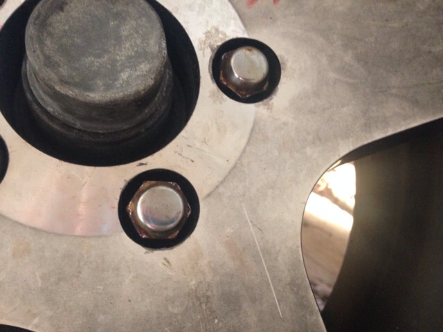

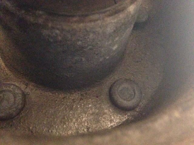

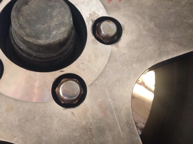

 OK - so I decided that today was the day to do the wheel bearings. Everything was going swimmingly until the last wheel where I could not loosen off the wheel nut on one stud.
Looks like the stud is rotating in the hub. So no worries thinks I. I'll just take the whole wheel off to do the bearing and then I can sort the stud. Nope, disc brake hub is held on by brake calliper. Loosen off the caliper but can't get it off because wheel rim is in the way.
So I put it all back together and retreated inside to post this. Can anyone offer any advice as to how I can loosen this wheel stud, this is a little beyond my limited experience !

 Pics added to original post.
Tue, 2015-09-29 07:00
 Pics added to original post. It's going to be very difficult to get anything in there. Unless somebody has a trick, I could be up for a new alloy rim, let alone a new hub - yuk.

OK - have spoken to a couple
Tue, 2015-09-29 11:31
OK - have spoken to a couple of people about how to resolve. It is very close in there and difficult to get any kind of tool into the inside of the hub to work on the stud. Therefore, the best course of action is to use a MIG welder to apply a solid tack of weld to the stud and the hub.
This should create enough resistance to fix the stud in place and enable the wheel nut to be undone.
Anyone know anyone who has a MIG who could do this, preferably mobile as not keen on towing with bearing being a bit suss.
