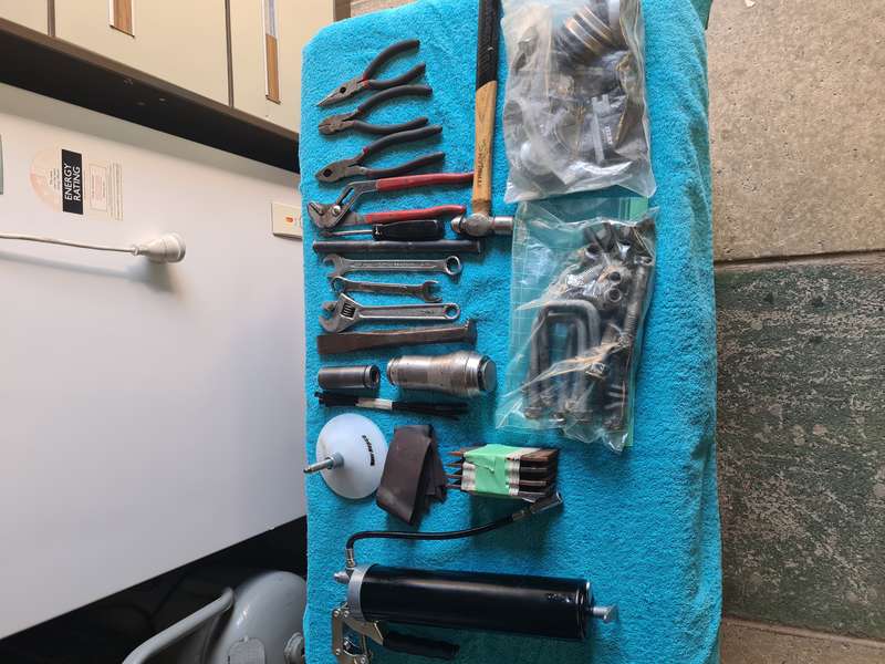

One thing l also have which l take on any trip longer than a local run is a dedicated tool kit with everything to change wheel bearing on the side of the road. l used this kit last Exmouth trip when l can across a guy an hr out of Carnarvon on a Sunday with a collapsed bearing.

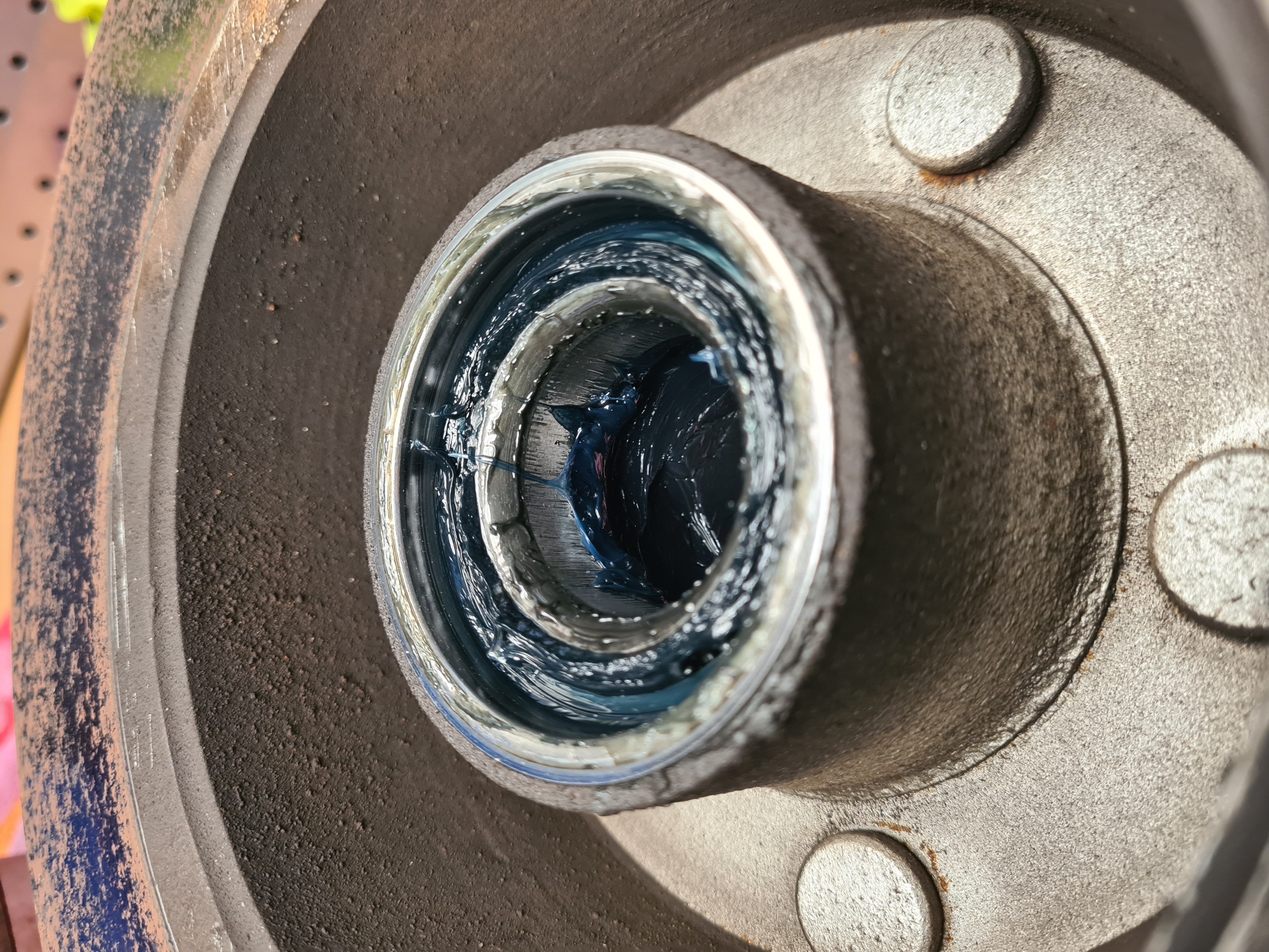

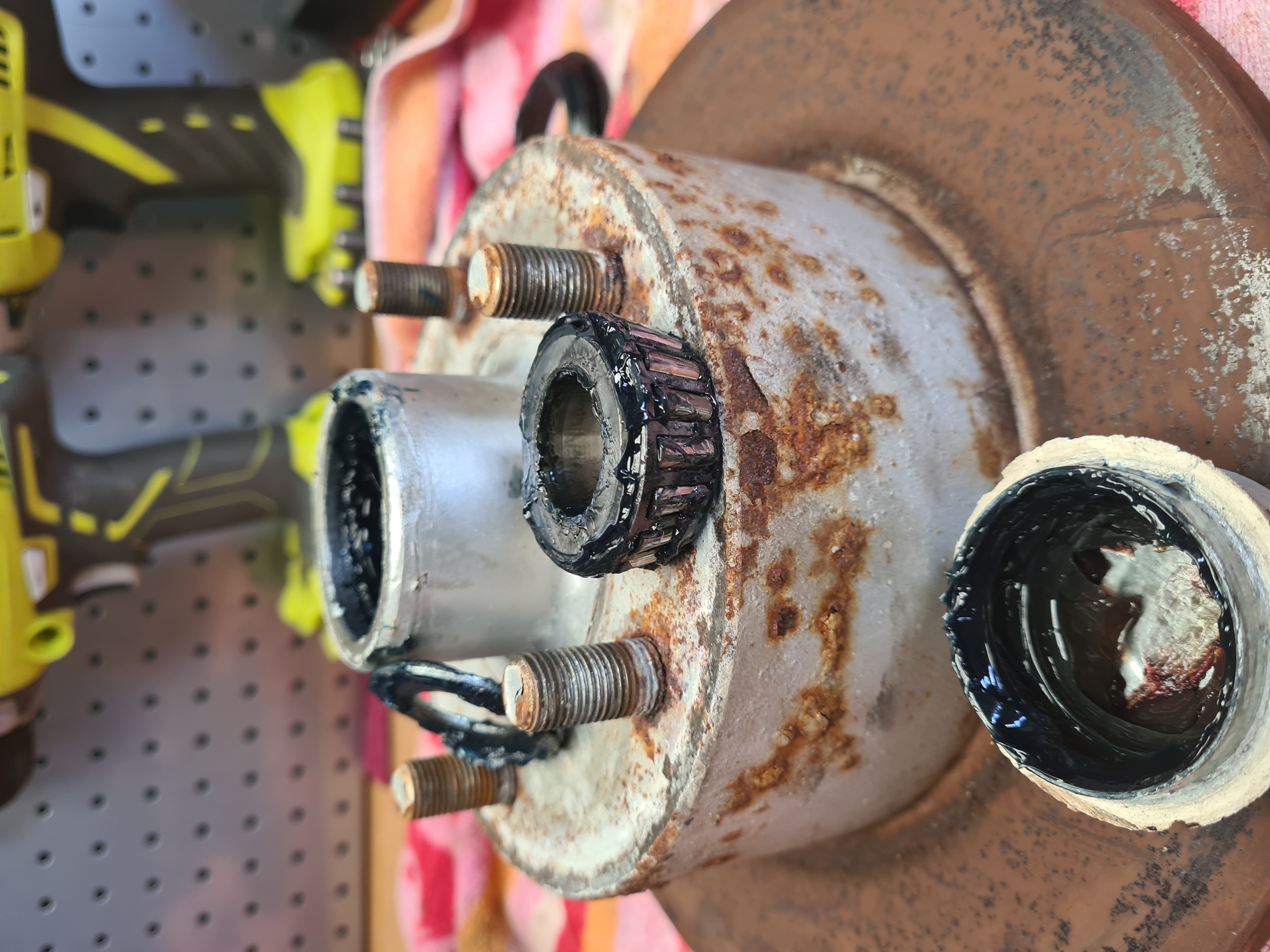

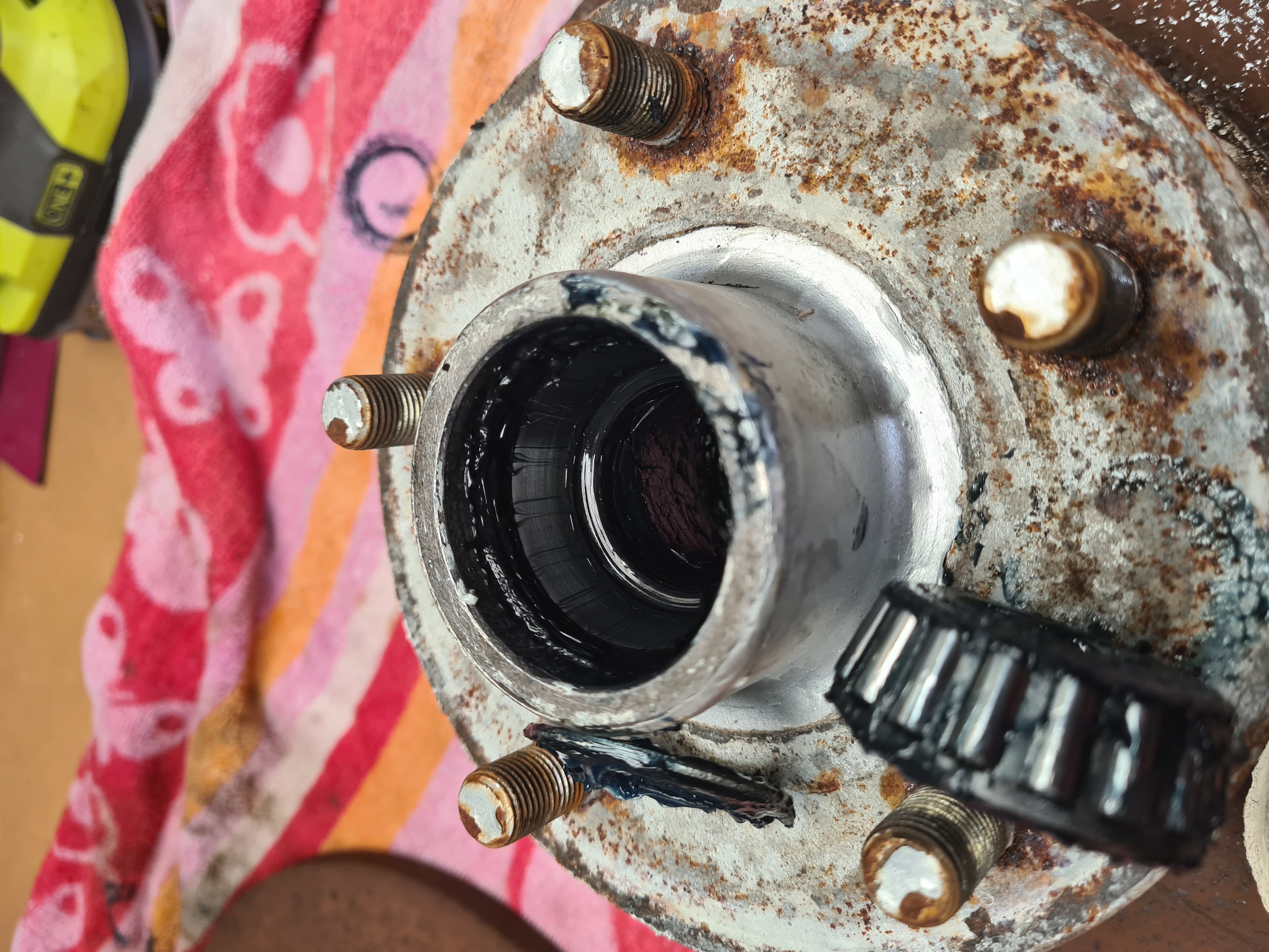

So here's a few pics. 1 of my tool kit,  also my hubs and bearings. You will see the grease still has a good blue colour with no sign of water or heat. Really they could of been used again.
So for me it's caps over B/Buddies, JMO.
My hub discs are 7 years old and pitting with rust which  to clean up l used a flap disc on a grinder,  thus is the down side to long maintenance.
What's in the tool kit.
Pliers, side cutters , 5/8 or 16mm spanner, shifter, multi grips, hammer, screw driver, cable ties, spare bearings, caps ,castle nuts ,split pins, grease gun, bearing grease packer, spring hanger ubolts, wheel nuts, 16mm mild steel rod, race fitting tool, emery paper, wheel nut socket, brake pads

 Good info here mate, I take a very similar kit when heading north too.

You have a good tool selection for the job. We carry about the same when we go away.

Well prepared mate, that tool kit will save a lot of heart ache.
