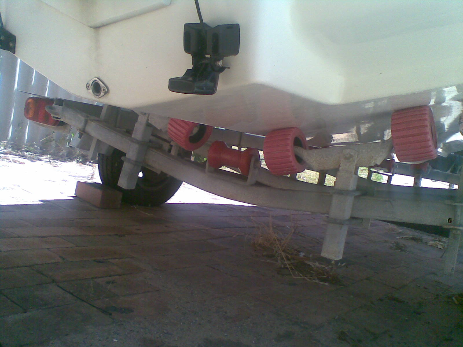

I was wondering if anyone could help me with the setup of my trailer. I find that when I retrieve my boat it can be a bit of a bitch to get it square on the trailer and sometimes it don't sit right. I don't know if the cotton reel rollers are right or the skids. I have 4 cotton reel rollers in the middle and the hull sits on 3 of them. At the rear there is a skid each side and some wobbles.

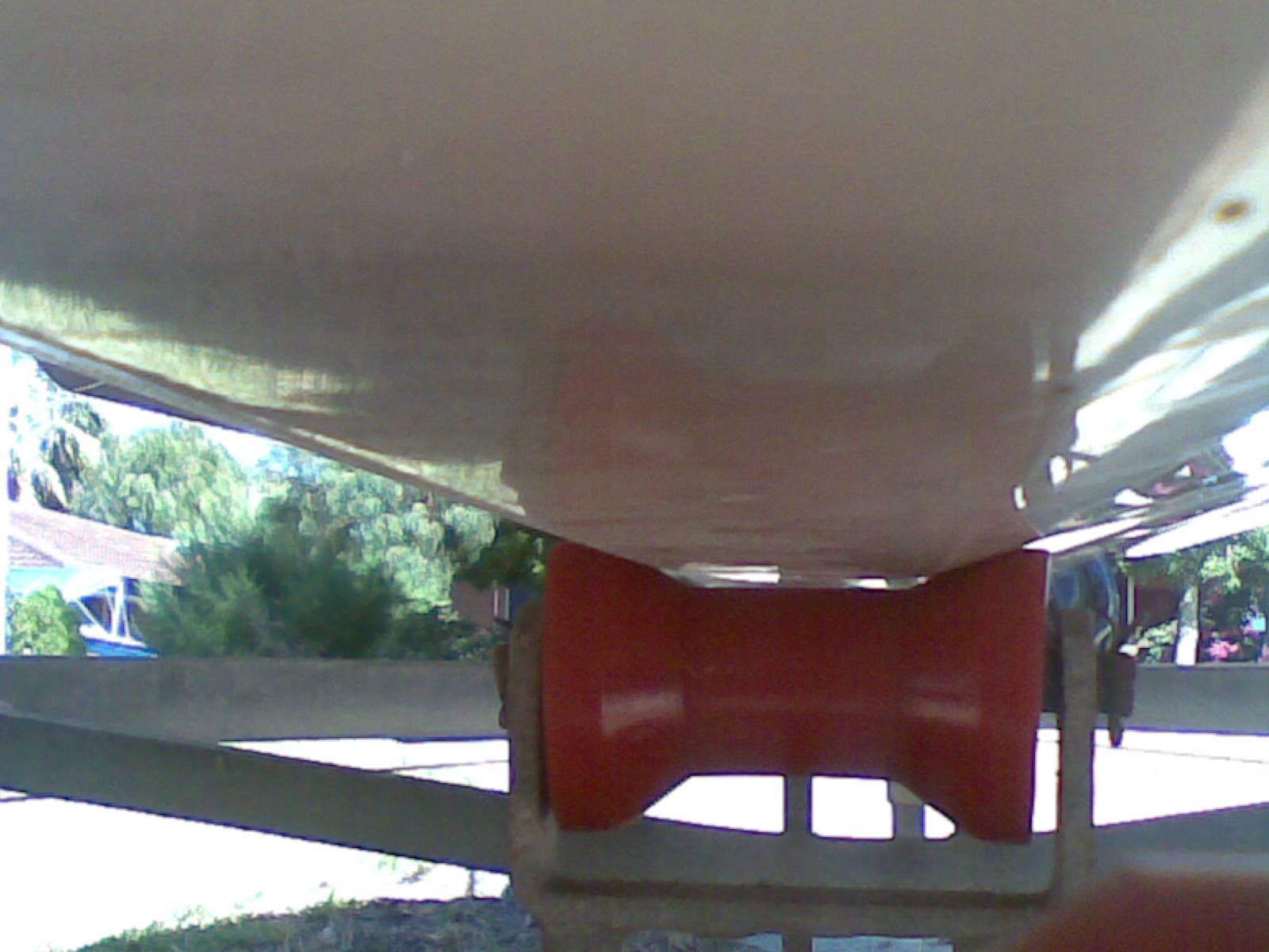

The last cotton reel that the hull sits on. the keel doesn't sit in it proply. it sits on the outside of the roller. if it don't make sense I will take a pic of it in the morning. hey till had it for about 8 months, but i work away alot.

I have uploaded the pic i was
Sun, 2011-01-16 09:50
I have uploaded the pic i was talking about. its the last pic of them. this is  the roller at the end were the hull sits on. notice were the keel is sitting on the roller.

The keel is designed to take
Sat, 2011-01-15 18:09
The keel is designed to take the most weight. Skids and wobble rollers just hold it there. I would move those back wobble rollers out a bit more to allow the hull to sit lower on the trailer. Unfortunately this is going to mean virtually every single roller on that trailer is going to have to be adjusted.

Jeez, I dont like the look of
Sun, 2011-01-16 12:09
Jeez, I dont like the look of that. Needs to have the wider style of rollers to support that keel a bit better instead of just on the shoulders of that keel plank. Is that the trailer the dealer sold with the boat? Looks like a whole lot of work to get it all working properly.

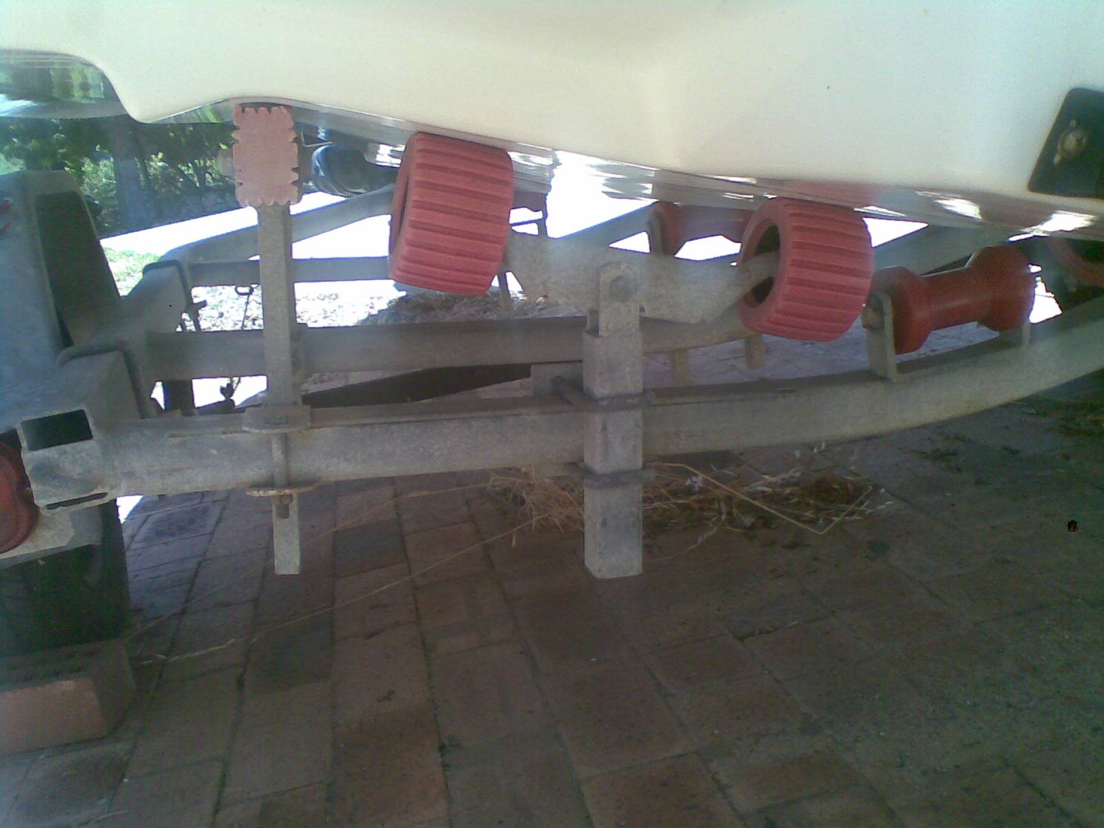

more rollers
Sun, 2011-01-16 16:07
Loking at the pictures , yes the front keel roolers need to be wider to suit the keel, the other thing i would do is install two more set of side wobble rollers as you only have one set right on the transom and the next two croos members dont appear to have anything, the second bar up from the transom , if rollers were installed would give a lot more direct to the hull when winching on , the slide skids i think are to short and prbably only help with stability when the boat is fully up

That last photo of the roller looks like
Sun, 2011-01-16 18:38
it has to much weight on it. It dosent match the hull shape either!
