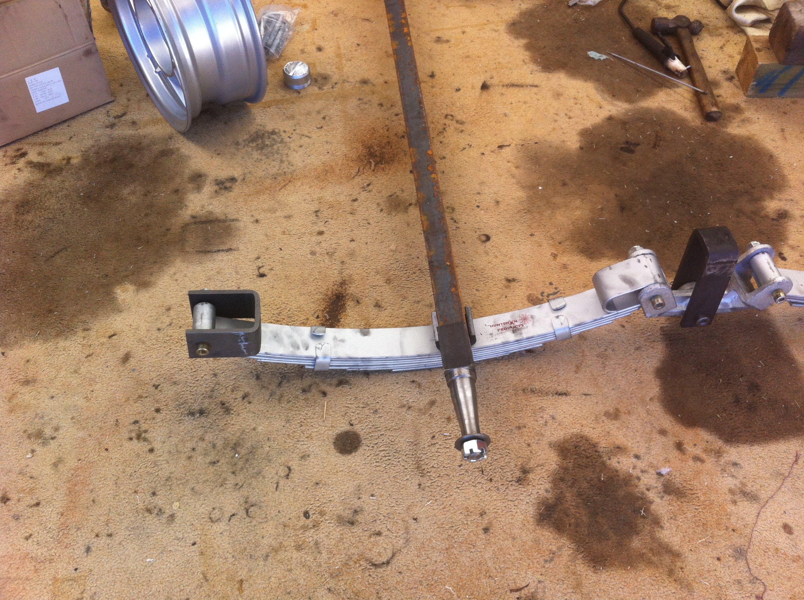

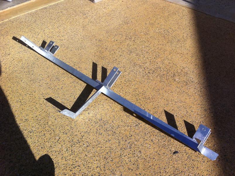

 Its been the elephant in the room so to speak as regards my trailer, in that with the ADR's requiring a 120% capacity with non load sharing suspension, i couldnt get my trailer over the line for more than 2000kg rating.
The frame is in really good nick, so Ive been gathering up the bits to address this for a while, scored used Kodiak SS disc/calipers and Dexter unit.

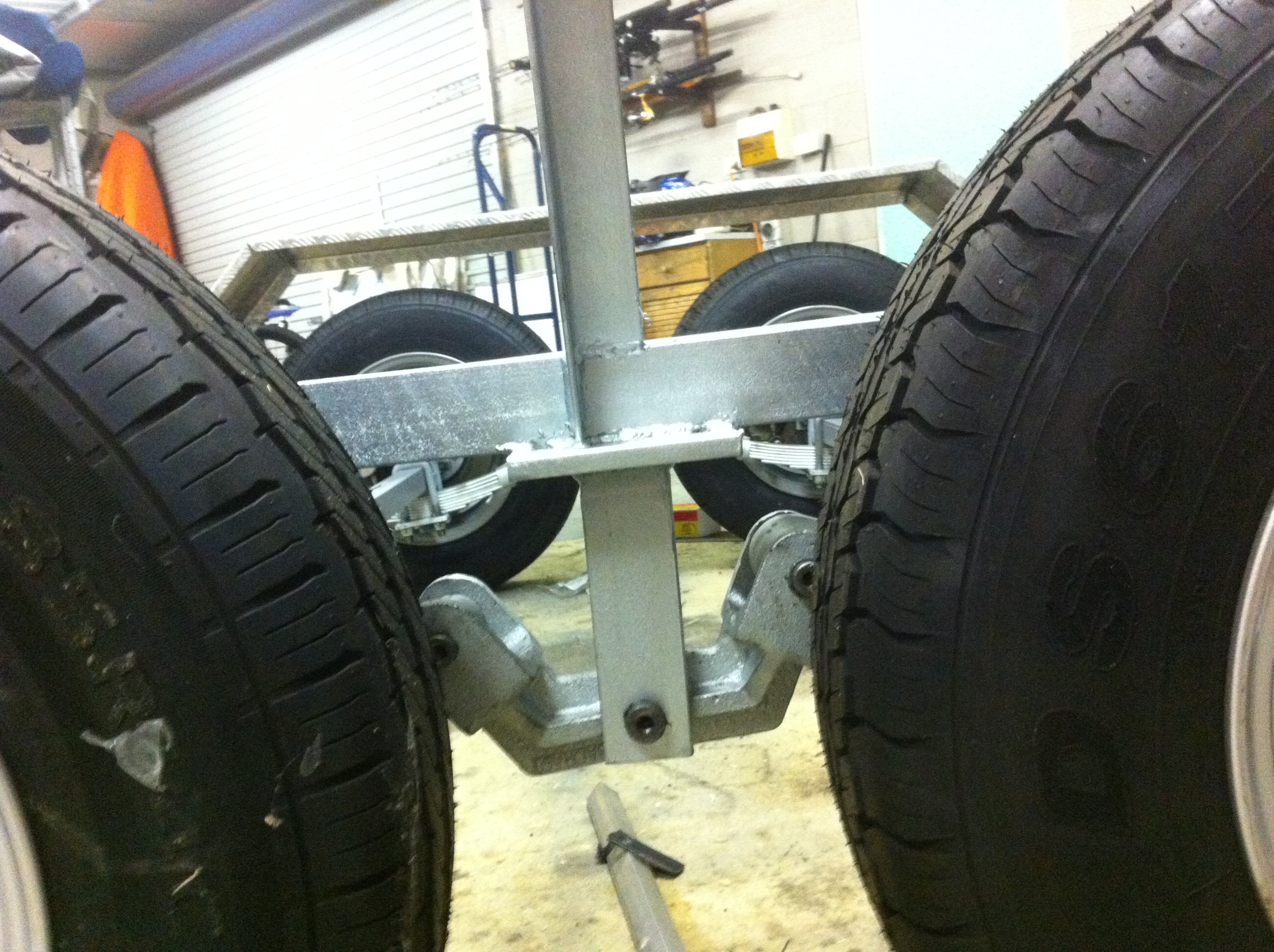

I attacked the frames a couple of weeks back and sent them off for galvanising.

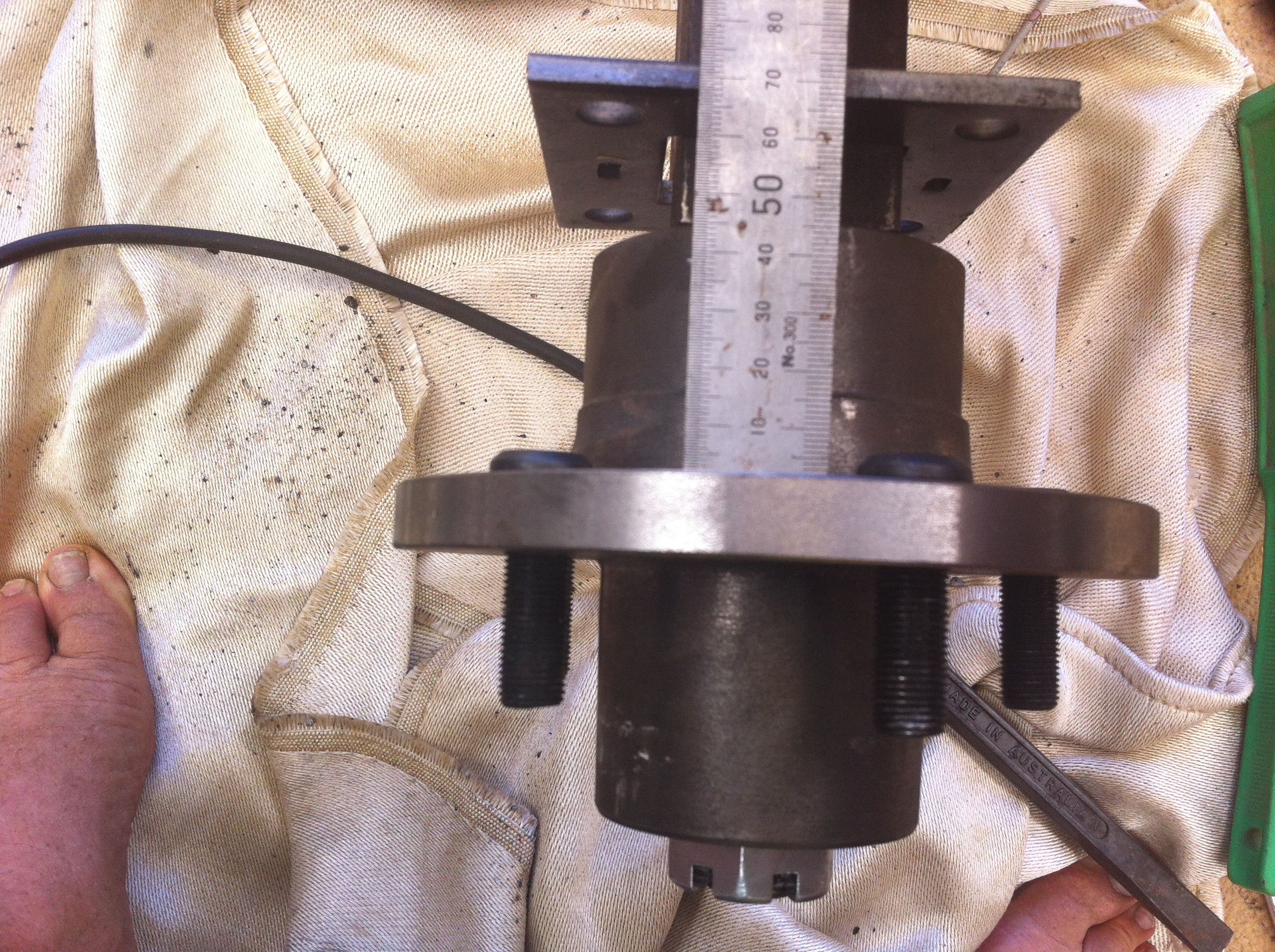

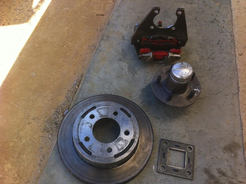

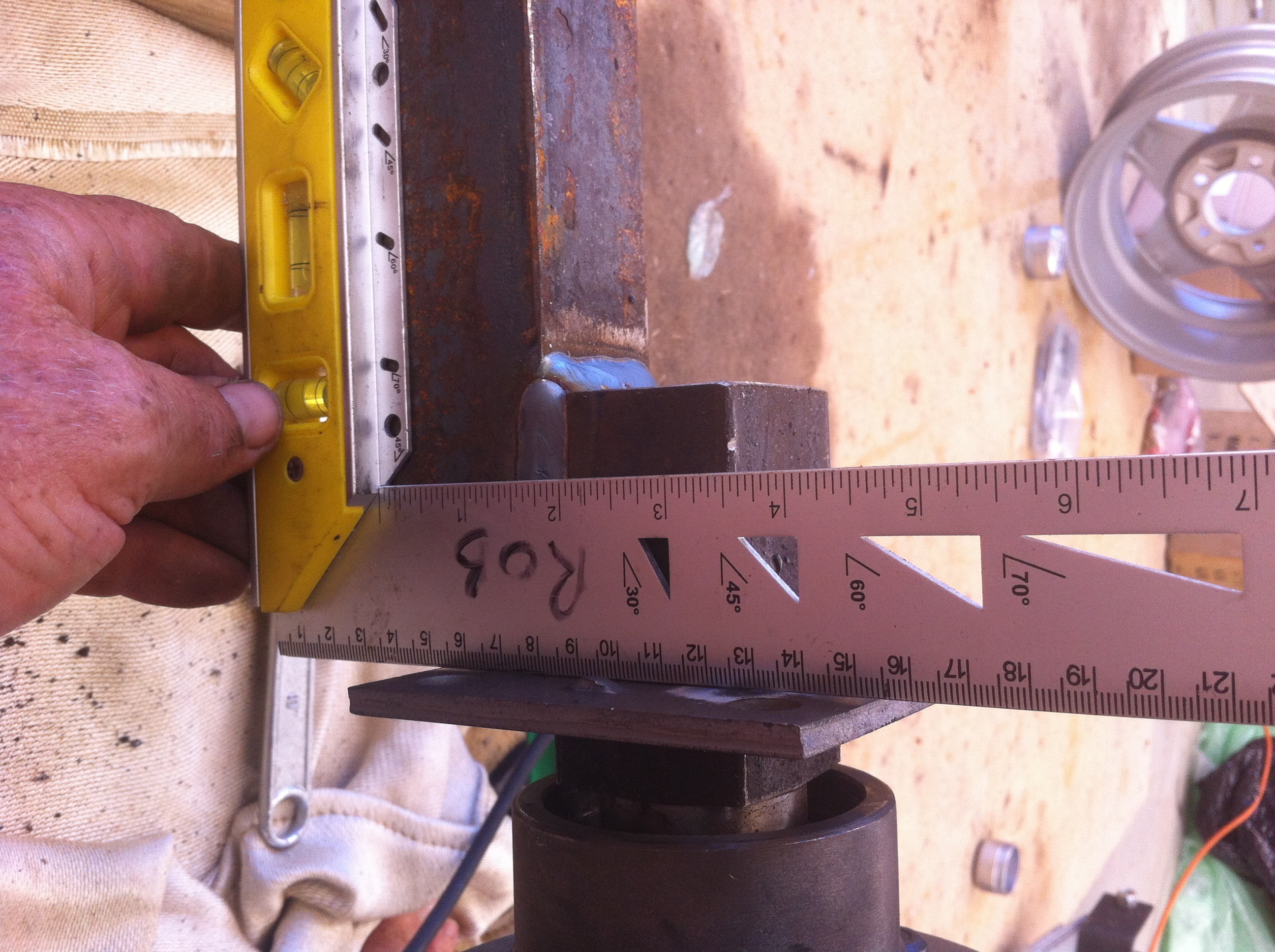

Setting up the brake flanges in the correct position and welding them on

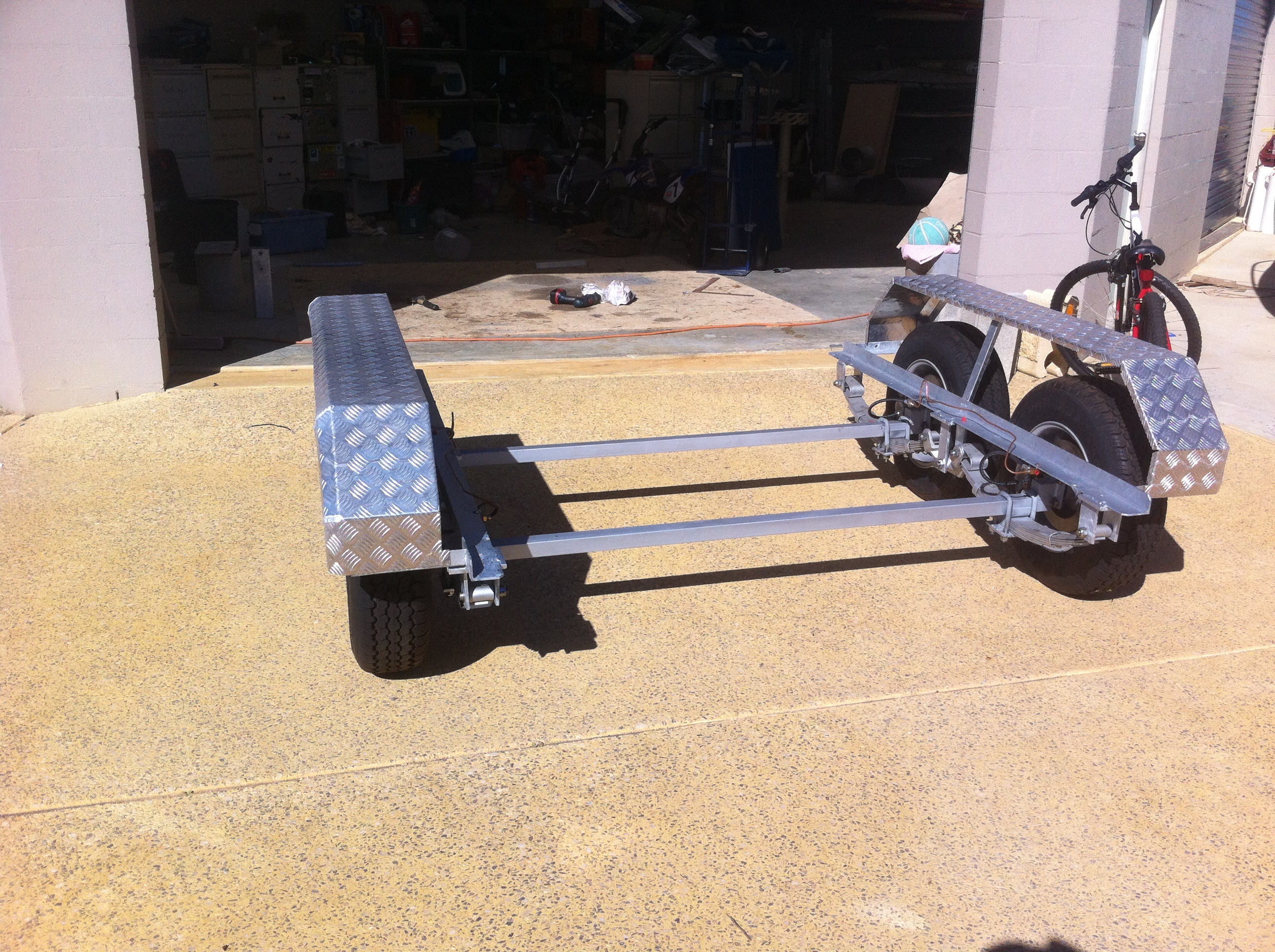

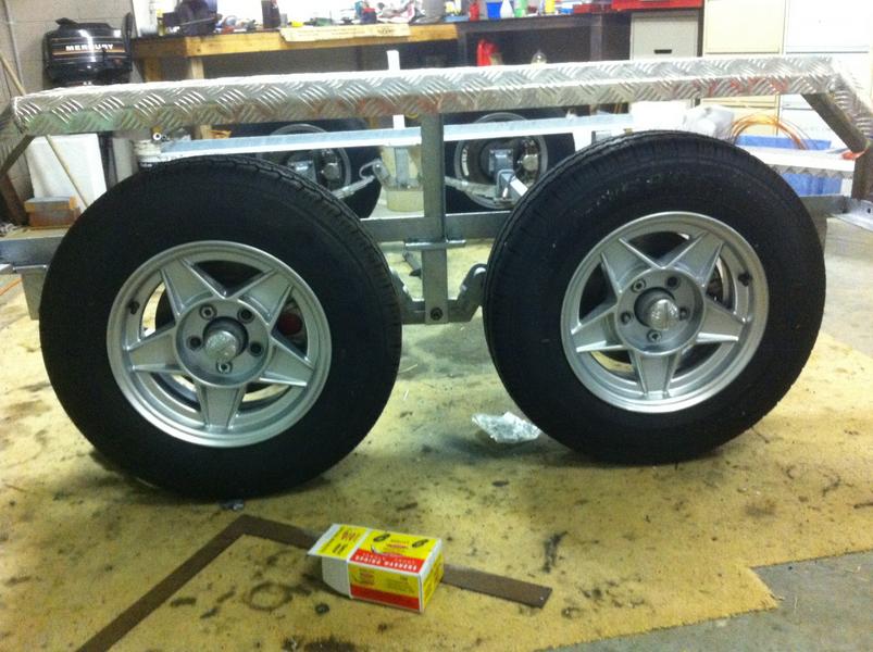

Having got them back its all assembled into a rolling subframe.
Off to Melbourne tonite for a couple of days and when i get back I'll drop the boat in the water, remove the old suspension and slide this under, u bolts, drop on the Dexter EOH unit and relicence it at 3000kg.

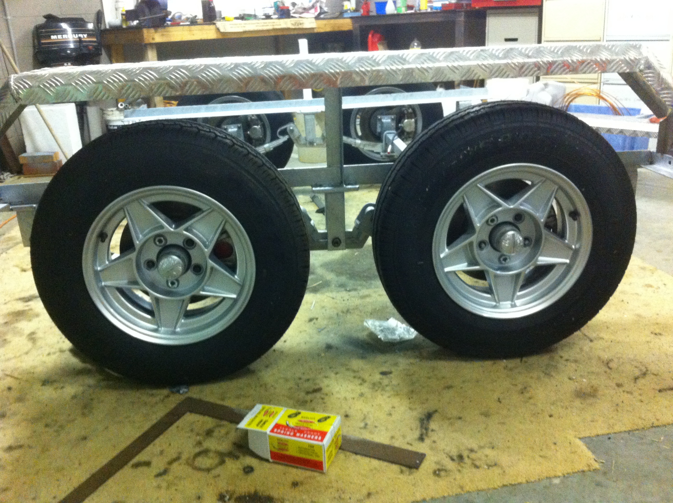

 Looks good!! Just put the
Sun, 2013-06-02 20:50

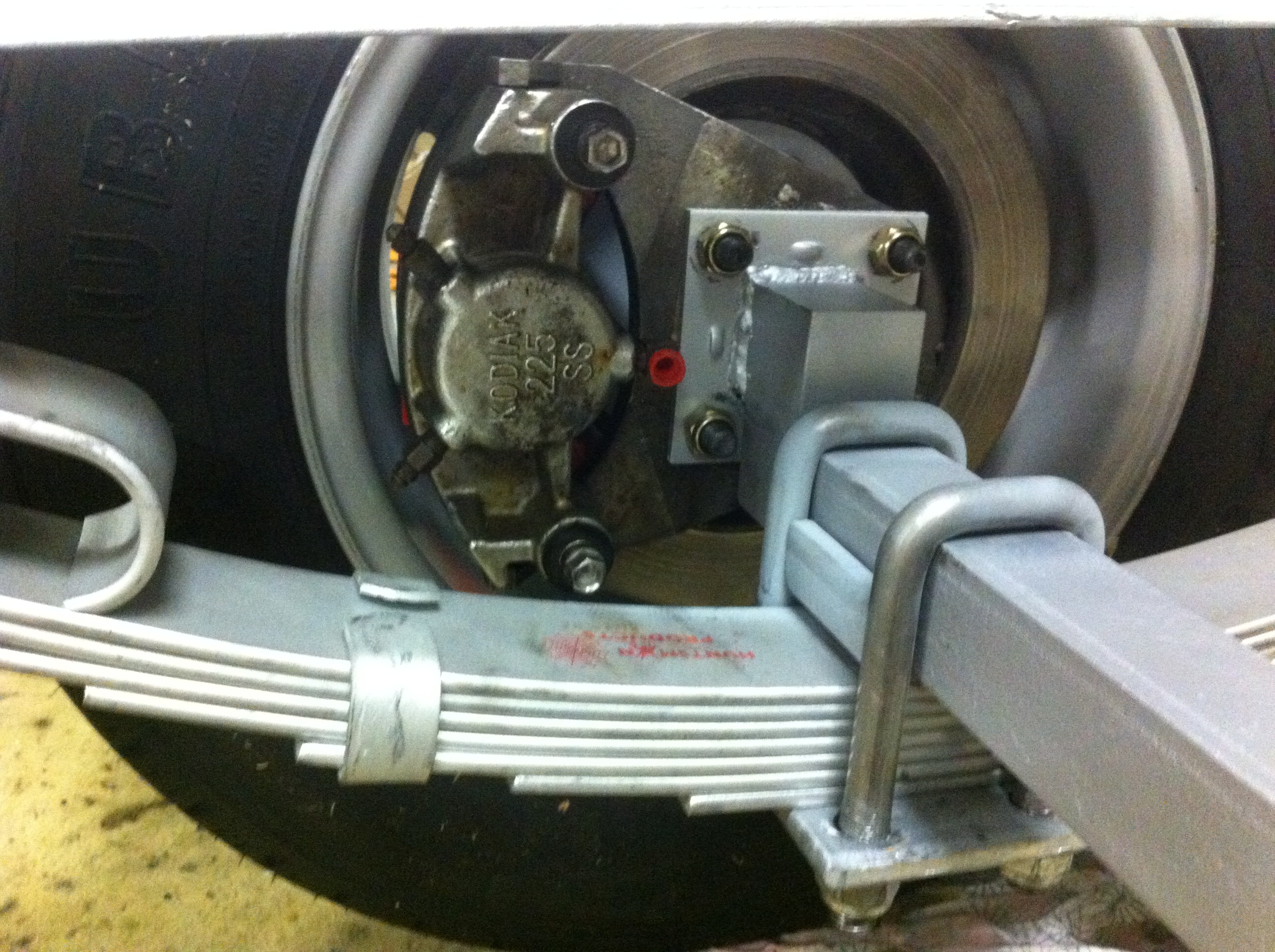

 Looks good!! Just put the stainless kodiaks on my trailer, Theyre great so far!
mullows's picture
Posts: 738
Date Joined: 25/12/08
 Where did you source your
Mon, 2013-06-03 09:45
 Where did you source your calipers from Vin? Just about to put the order through from the states myself for a full set.
cheers
Mullows

Nice one Rob. Especially like
Wed, 2013-06-05 08:19
Nice one Rob. Especially like the old skool mags, do you have a matching set for the Torana tow car......haha, great work mate.
I gotta pull my callipers off and check how rusty they are after a few months......is it worth putting heaps of rubber grease behind the rubber seal on the piston to stop it rusting???? I guess S/S is best but will wait fir these to crap themselves first.
Posts: 5907
Na they dont really match
Wed, 2013-06-05 18:38
Na they dont really match these wheels! In Streaky Bay atthe moment driving this back home

My non SS set lasted about 2
Wed, 2013-06-05 18:25
My non SS set lasted about 2 years so you might have that long John, maybe more. I took one off to have a look and it was very easy.

also mate, watch them screw
Wed, 2013-06-05 19:50
also mate, watch them screw on dust caps, we had many come off when I was in the game.
we used to chisel punch the end to stop them coming undone, maybe some lock tight might work
Posts: 5907
 Thanks Ron, yeah ive already
Wed, 2013-06-05 22:13
 Thanks Ron, yeah ive already seen why. The washer between the bearing and nut only just fits inside the cap and actually touched it on a couple. Cos one spins and one doesnt, it can loosen it.

After getting back from Melbourne, I had 4 days between dropping off the boat til flying out Thursday to complete it.
I was lucky enough to bump into one of those characters who has the ability to help a stranger despite personal adversity-Peters boat had unfortunately sunk in his pen the day before.
A chance meeting at the harbor saw him offer me his pen to park the boat without hesitation-a legend and a gentleman.
So-boat off and into the water, trailer home and just 3 hours saw old undercarriage off and new rolled under and bolted up-perfect fit!
That was the easy part-draw bar needed to modified, Dexter unit and breakaway fitted, lights rewired and new larger plug fitted then over the pits. Needed mudflaps and in the rush Id forgotten to weld the axle locators plus the Toyota had the brakelight wire wrong in the plug-factory fitted??
I also took to opportunity to modify the winch post in light of another members recent incident-Ive never liked the flat bar brace on the front of most winch posts, great in tension, hopeless in compression. This will be galvanized together with drawbar later.
looks like the tires are soft in this pic for some reason? Towed beautifully, onto the weighbridge again for 2650kg on the axles and 150-200 on the towball
Time was running out (6pm flight) and I got it passed at 3pm, down to ramp, bring boat round only to get a call that it was subject to a audit and I needed to detail the brakes used etc. Home, park it up with a flush, pack bags in 30 minutes and straight to the airport with 5 minutes to spare
Only thing left is to get the drawbar and post galvanized.
