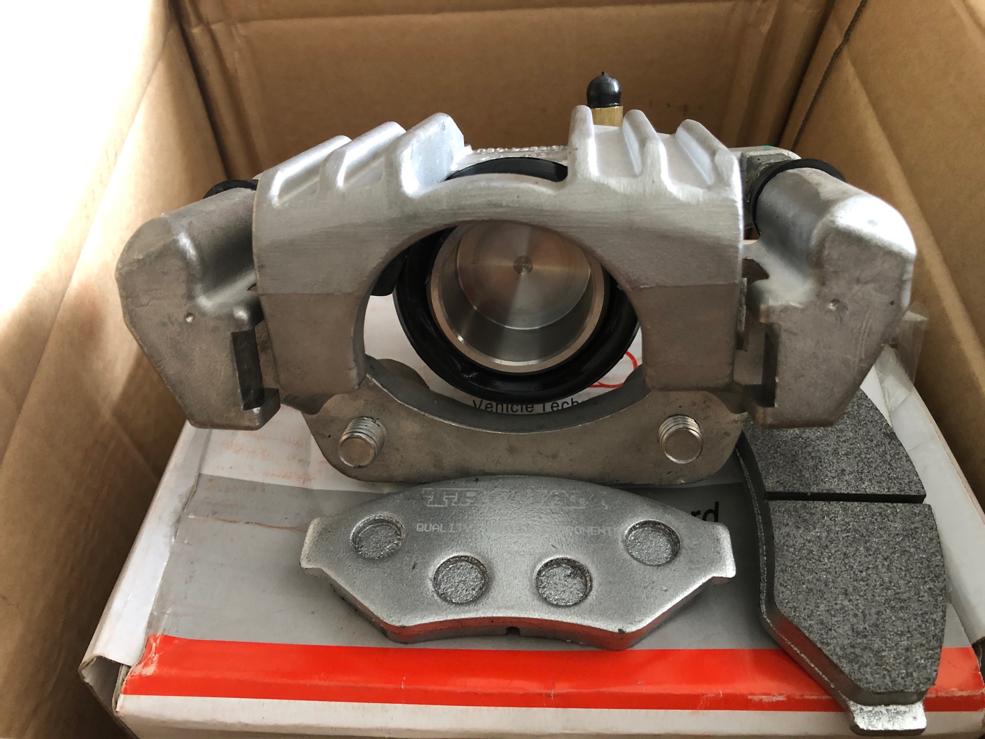

Took the plunge - set of 4 new Stainless Steel Calipers for Boat Trailer
Finally after a numbers of years of "sticky calipers" , hot brakes etc - splurged and sourced new SS Alkoh Brake calipers, inclusive of Stainless Pistons and Stainless brake shoes.
Expensive, but why spend the money on SS Calipers and not SS Piston or SS shoes.
Now to get them fitted to my Dunbier trailer.

 Caliper body looks like cast
Tue, 2020-02-25 17:43
 Caliper body looks like cast alloy?

Hmmm good question!
Tue, 2020-02-25 19:18

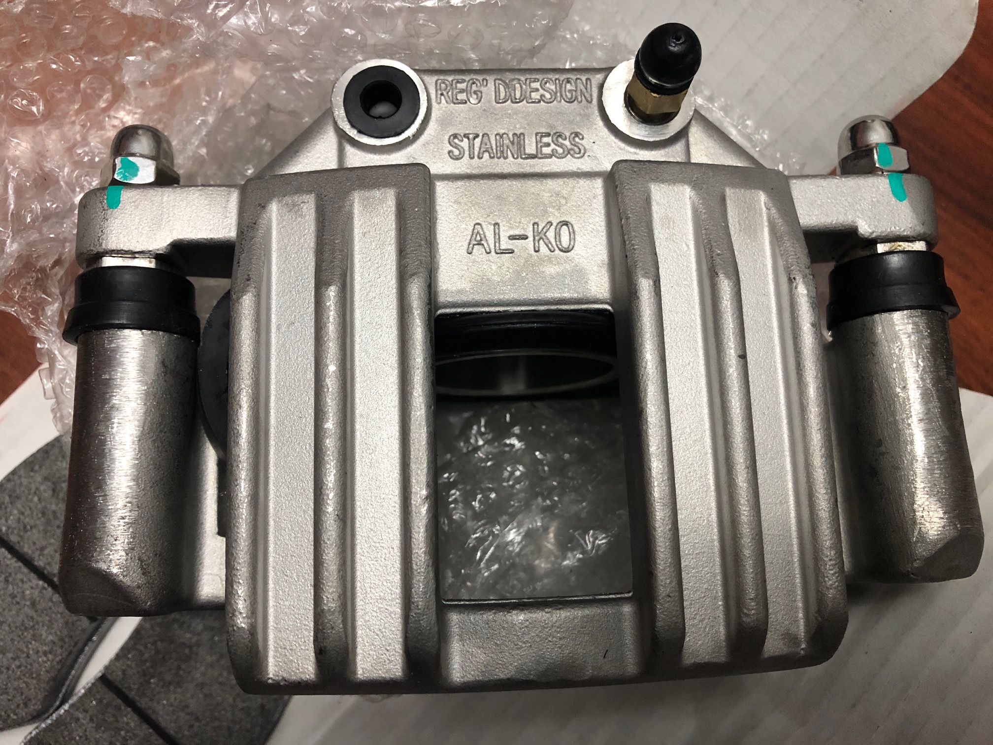

Is it possible to "cast" stainless steel? I don't know. This is cast. But looks totally different to my existing one.
You had me take another look.
Just posted a couple more photos.
By description on "casting" and label it is. If you look at the nuts they look like a different kind of SS.
Maybe a Stainless Alloy? I don't know.
Any metallurgists on here who can shed light on this?
Posts: 15185
 Certainly cast stainless,
Tue, 2020-02-25 19:39
 Certainly cast stainless, I've been in the metal game a long time and had me looking at the study book. I'm reckoning these weren't cheap items but looked after will certainly last years.
They do alloy with different levels of Chromium, it will have low levels of ferrite and silicon, it's amazing what they come up with these days, I'm impressed.
