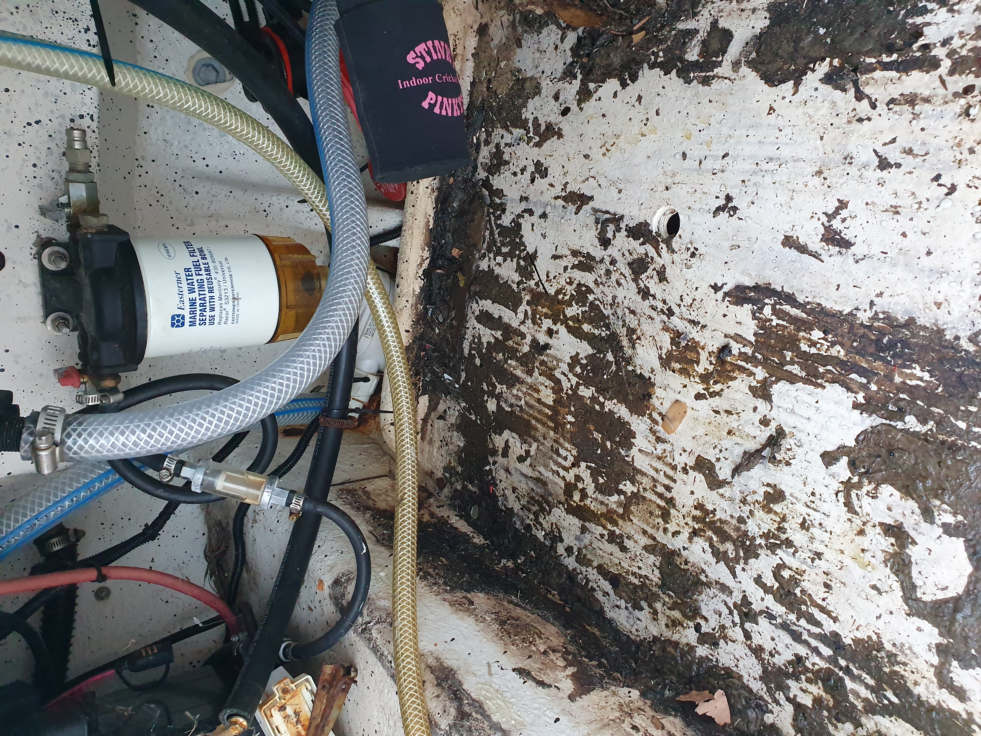

I've had to remove my fuel tank to repair a split around the intake and have a one off opportunity to get access to the hull through the tank recess to install a through hull transducer.
I have a P66 that reads at 33knots but not as well when it's choppy with a broken picture so would it be worth installing a B60 for $500+ supply and install or would the results be negligible?

No gaurantee that the B60 wont break up in the chop either.
If you do it I would be taking the opportunity to put in a 1kw otherwise the P66 is a pretty good unit that will cover your needs out past 100m

If you can do it, do it Frosty.
Mon, 2020-12-28 03:50
I'd be jumping up to a 1kw if I was you.

 1kw all day
Mon, 2020-12-28 09:58
 1kw all day. Providing you can remove the fuel tank to access it in the future.. seal it well

You can install the P66 as
Mon, 2020-12-28 13:06
You can install the P66 as throw hull (dry).....did it with mine 8 months ago still going.

Cheers guys, sounds like it's
Mon, 2020-12-28 17:58
Cheers guys, sounds like it's go 1kw or don't bother especially as I'd have to remove the tank again if I get a leak

Tm260 do the job and save
Tue, 2020-12-29 03:12
Tm260 do the job and save hassles.. get a drop down pole for deep
