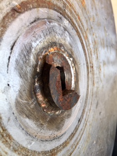

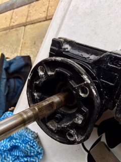

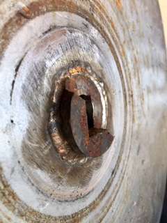

On my last trip out I had to retrieve my anchor manually as the stressfree anchor winch kept slipping.
Once home and upon further investigation I noticed the shaft collar was damaged.
Now I was wondering if someone could point me in the right direction on where to get this fixed. It appears that it may of been pressed and then welded to the drum.
Any help will be awesome. I'll be contatcting Stressfree on Monday as well, but if I could find someone local that would be better.

 Looks like cast steel, would
Sat, 2017-06-03 08:57
 Looks like cast steel, would need a new fitting made and welded in.

All fixed
Wed, 2017-06-07 19:24
Yeh lance it is the Freefall.
Stressfree were really good and sent me a new part free of charge.
I then got Paul Coleman in Rockingham to weld it for me. I was extremely happy with his work.
