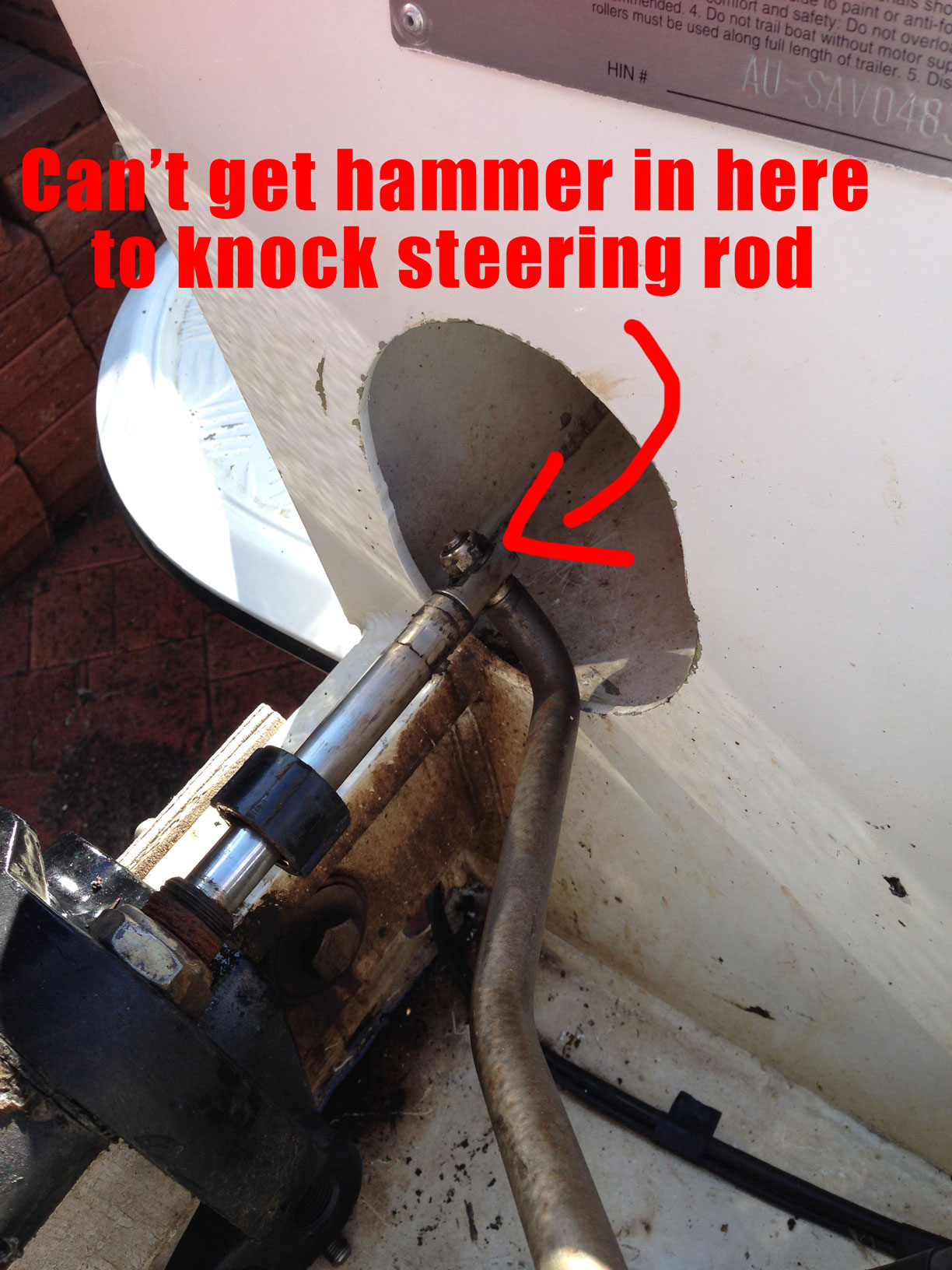

 Ah, your second pic just
Wed, 2014-04-23 15:28
 Ah, your second pic just popped up. Undo the bolt/nut at the end. Then you will be able to undo the plastic retainer at the outboard end and slide that off (it should have an o-ring in the retainer). Now liberally spray as much inox/lanox as you can at both ends of the outboard housing.
Then  somehow you can try tap the end in the second pic toward the outboard with a rubber mallet to get it moving.
Patience, a ton of inox, and a ton of rags should free it up

 Thanks so much for the response Steve, I've tried reuploading that second picture. Not sure what happened.
So on the first picture the inside cable should move within the outer? At the moment if I disconnect it and steer the wheel they move as one.
Will try that grease nipple as I think I know what you're talking about. You can see it on the second picture?

 Ok so the rod you can see in
Wed, 2014-04-23 15:44
 Ok so the rod you can see in the first pic will slide into the rod you see in the second pic. So yes the rod in the first pic moves with the cable because when it is re-connected this will push/pull the rod in the second pic.
For the plastic retainer. If you look at your second pic, follow the rod toward the outboard the first thing it goes into is the plastic retainer/seal. This will unscrew. You can leave the goldy coloured nuts tightened up. I'm not 100% on what they hold but when I did mine I didn't touch them.

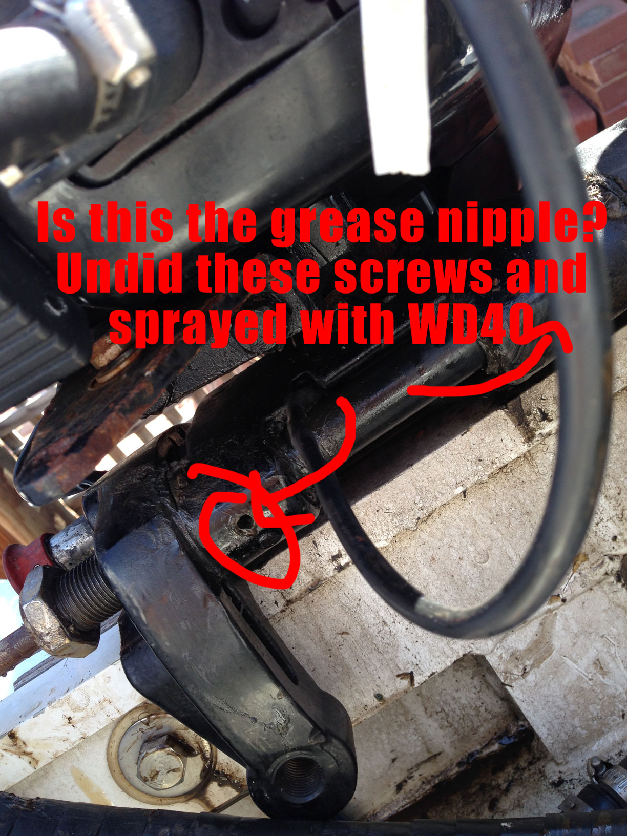

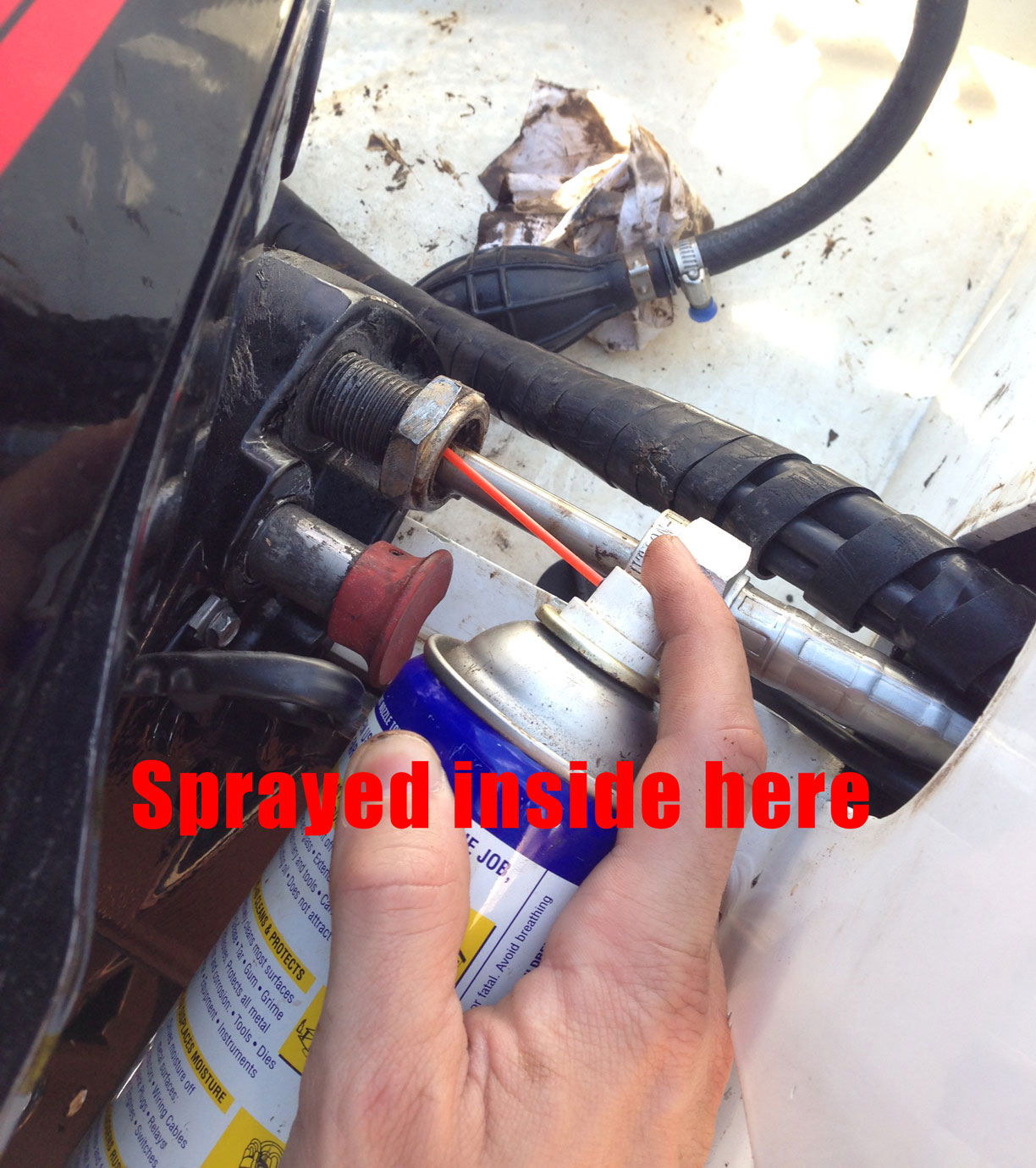

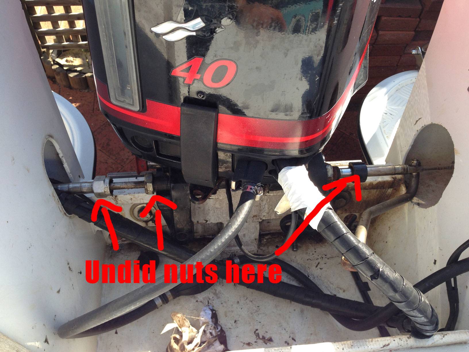

Put some new pics up of what I'm doing. Is this right?
Posts: 315
Date Joined: 20/01/10
in the pic of undone nuts
Sat, 2014-05-03 20:30
in the pic of undone nuts here , i only undid the far left one and more so sprayed the arm on the right a bloody big yank on the steering wheel wasn't sure if it was the steering wheel unscrewing/breaking at first (but had nothing to loss at that stage )  or if it was actually moving the arm after a full turn to the right it was easy as turning the steering wheel back to the left
Posts: 812
Date Joined: 09/10/06
 The grease nipple when
Sat, 2014-05-03 21:28
 The grease nipple when greased doesnt go into the tilt tube where the steering cable goes through. It only greases the motors tilt brackets that the pivot tube gies theough if that makes sense.
You shouldn't need to undo the nut on the motor pivot tube.
Take the steering arm off and keep spraying in the tube whilst pulling back and forth on the steering cable. It should just slide out after time .
Dont use steering wheel. Grab the steering cable at motor and just pull it out.
