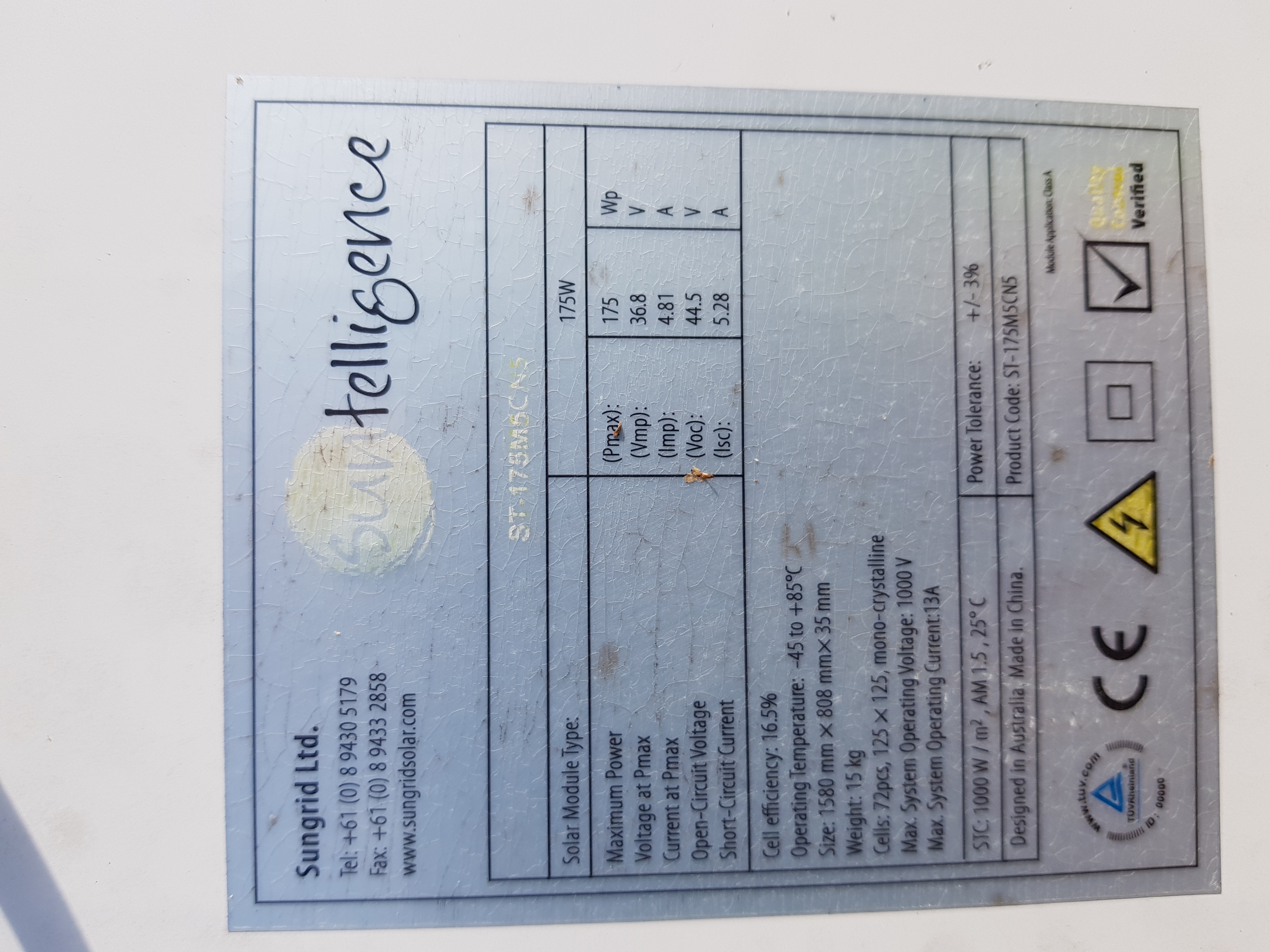

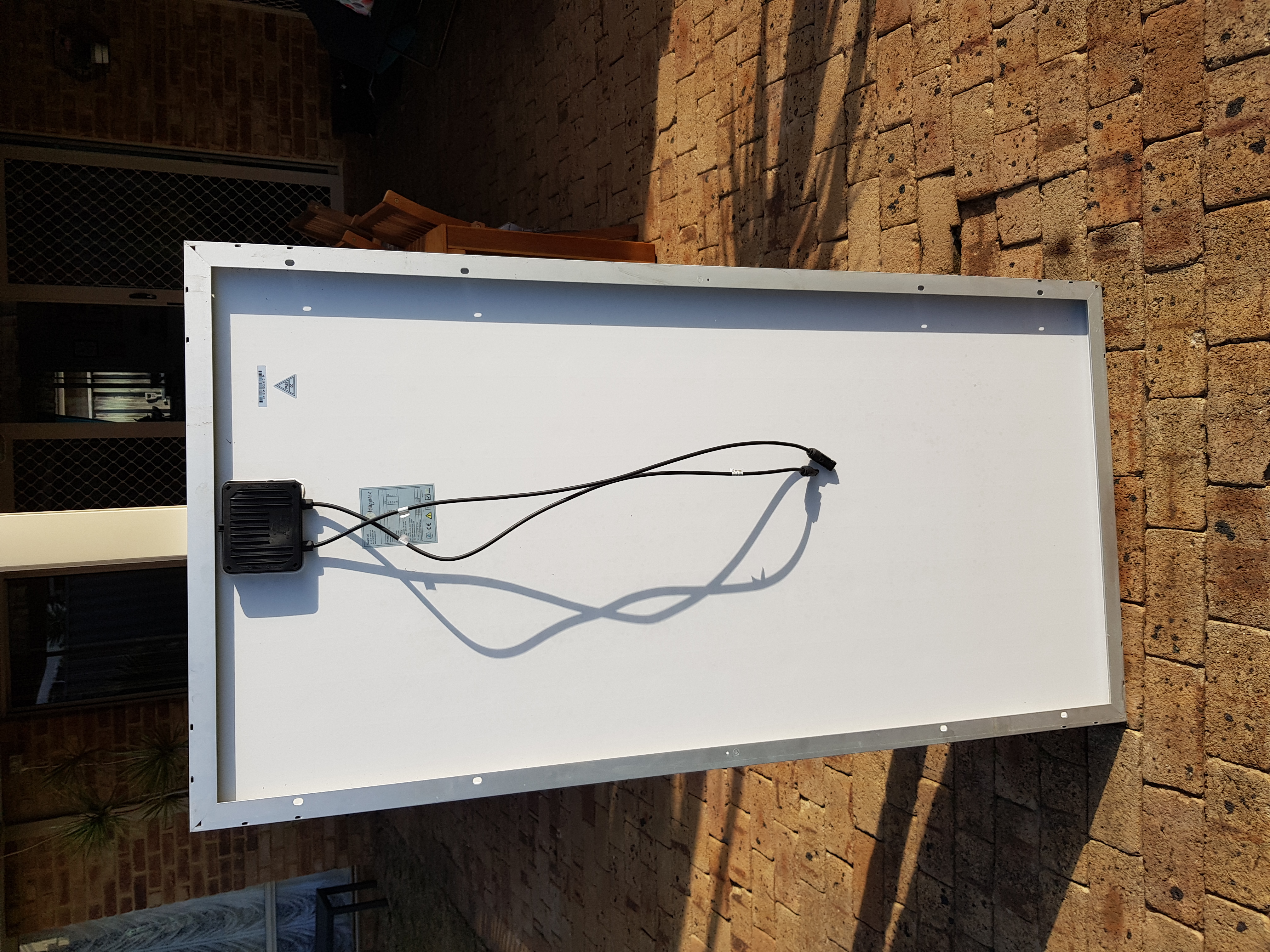

Just wondering if you can use a house solar panel to put on roof of car to keep batteries topped up when camping.  If so can someone tell me what regulator i should get for this panel cheers.

 Yep not a problem, get
Sun, 2019-02-03 20:16
 Yep not a problem, get yourself some 4mm dual core and a male n female MC4 connection to plug into the MC4 connection that are already on the panel and a regulator and your away.

 Ummm that's a 44v solar
Sun, 2019-02-03 20:38
 Ummm that's a 44v solar panel... He needs a 17v or there abouts and the regulator will drop it to 13.8v... Ive no idea what that unit will do to a 12v regulator but I don't think it would be good

Most of the better controller companies will have something that will accept 44v solar for a 12v system.
Get in touch will a victron agent and give them the panel specs, not cheap but very good:

 Hi Guys,the house panels are
Wed, 2019-02-06 21:41
 Hi Guys,
the house panels are putting out much higher Voltages than the standard camping panels you can buy that can push out 18 or so volts into a PWM regulator. You can put an MPPT regulator on a house panel as long as you check that the VOC is inside the controllers specs. The blue controller will handle Panels that kick out up to 60V and the black one would handleabout 40 to 45v happily. Being made overseas they will quote the top end of the scale of what the controllers can handle so I always down rate them a bit to ensure we arent pushing the envelope.
The volts coming out of the house panels will be changed into the volts of the battery the system is connected to. The Batteries must be connected first as this is what tells the controller how to operate. ie 12 or 24. Once the controller knows what to do you can connect the house panel and all is good. You can actually have longer cable runs and can afford the voltage drop that occurs with 18v panels. Not really an issue in a car.  The panel above should push out about 8amps at 13v with the MPPT and do it longer as it has a higher feed voltage. As the sun dips the input voltage decreases but the output voltage remains high so we get more juice in the batteries connected. a much better system than the Aldi specials for not much more.

The only other thing to be wary of is House panels arent meant to be bounced around and some have very thin frames. As long as it doesnt bend and break like some of the low profile ones they are fine.
