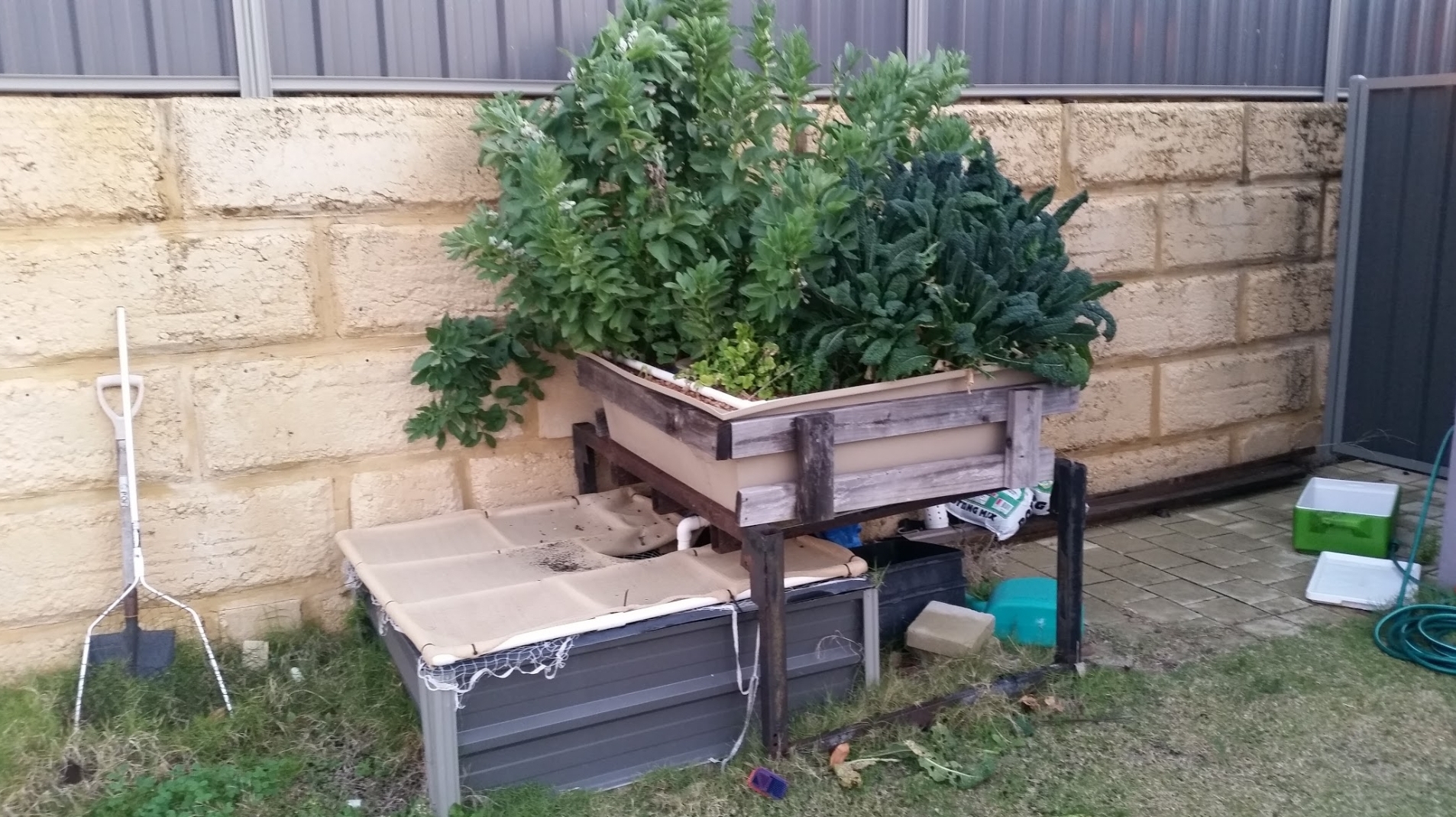

 I'd love to see a photo of your aquaponics setup too.

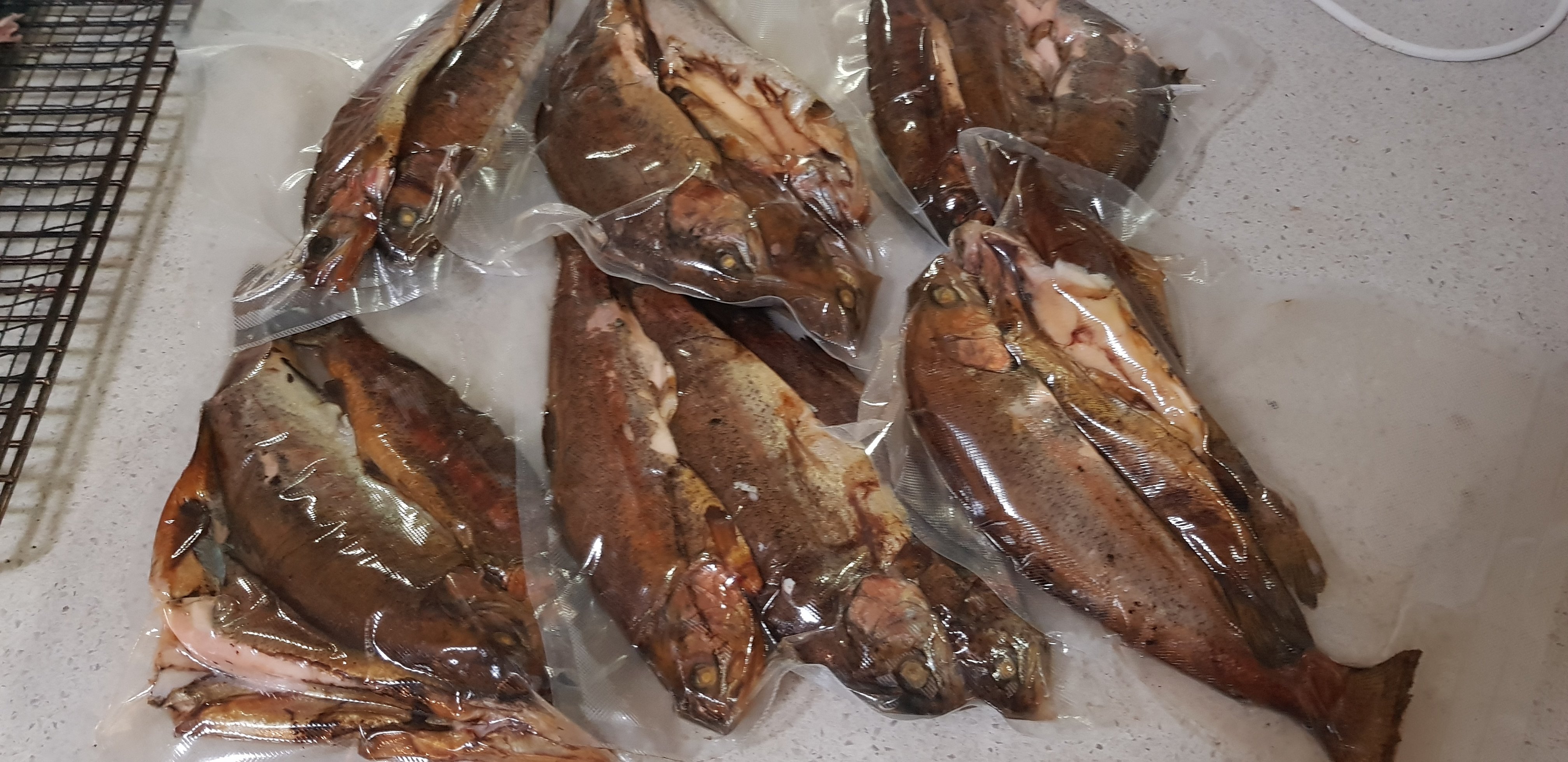

And presumably you freeze the trout after vac packing them, or do you just refrigerate?  If so, how long will they keep?

How big is the tank?

how much room does a setup like that need? any chance of posting a photo of the setup?

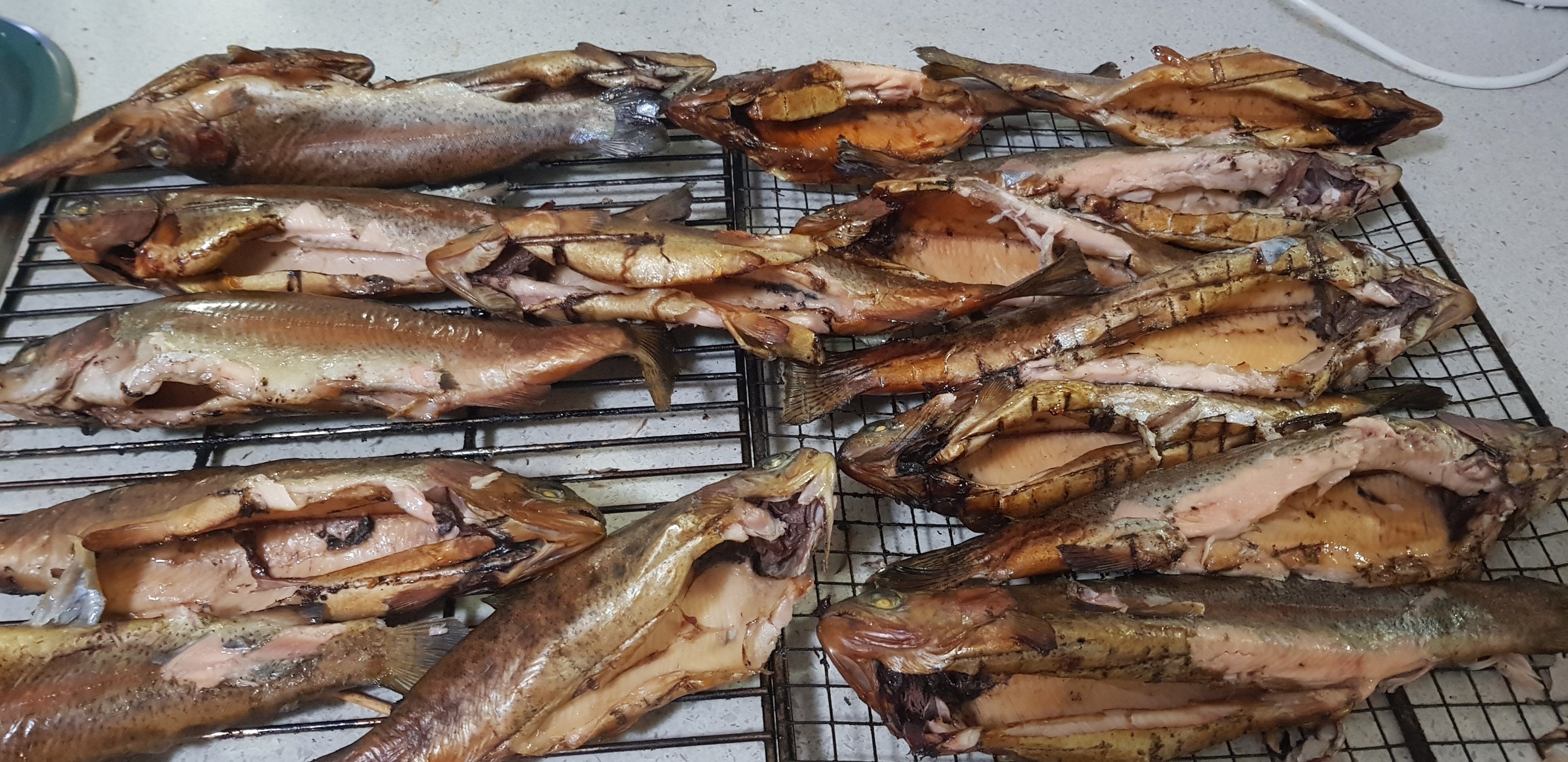

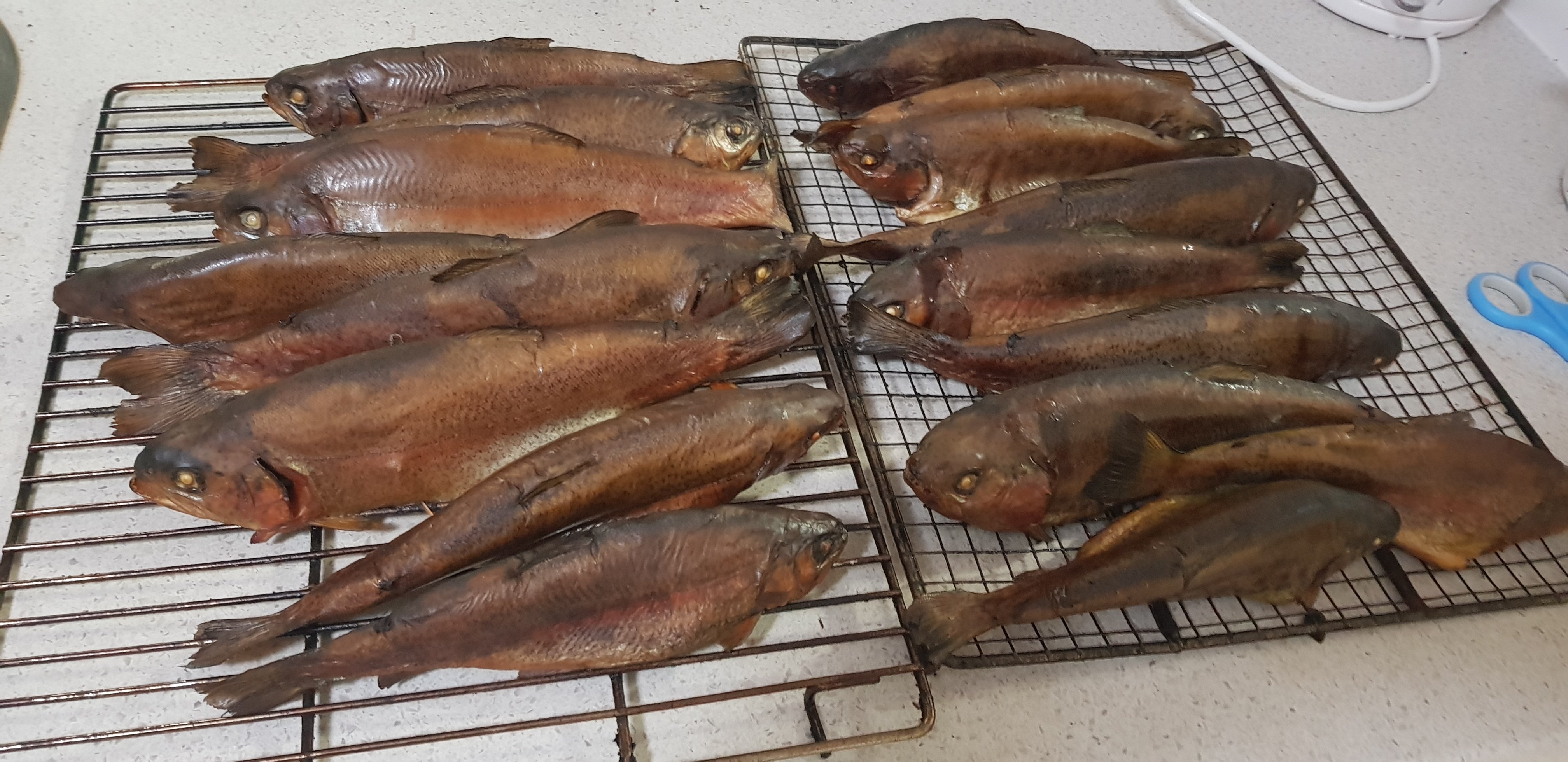

Cheers lads. Harvest time is always exciting when I have a few to smoke. I brined them in a salt/sugar solution for 4 hours and then hot smoked them at 215f (100c) and started with a handful of mequite and then fed through dried offcuts of my apple tree over the next four hours and I'll make an angel hair pasta with capers and rocket tonight and freeze the rest and I have a smoked trout cream cheese and sour cream dip that I pull out for special occasions.
I've attached a pic but the system (approx) is a 600l fish tank with a 400l growbed and comfortably does 20 trout. I have pea gravel in the growbed as the grow medium and expanded clay is way lighter and kinder on the hands when planting but way more expensive and the whole system takes up a footprint of approx 2.2m2. The idea is that you pump water from the tank up to the growbed and let it drain back into the tank. The bacteria in the pond convert ammonia from the fish waste into nitrites and the bacteria in the growbed convert the nitrites into nitrates which feeds the the plants and filters the water to keep the fish healthy.

That's great. Doesn't look to expensive to establish either, although the pump etc probably costs a bit.

Veggies look like black kale and broad beans
Tue, 2019-09-17 15:31
 Or am I mistaken

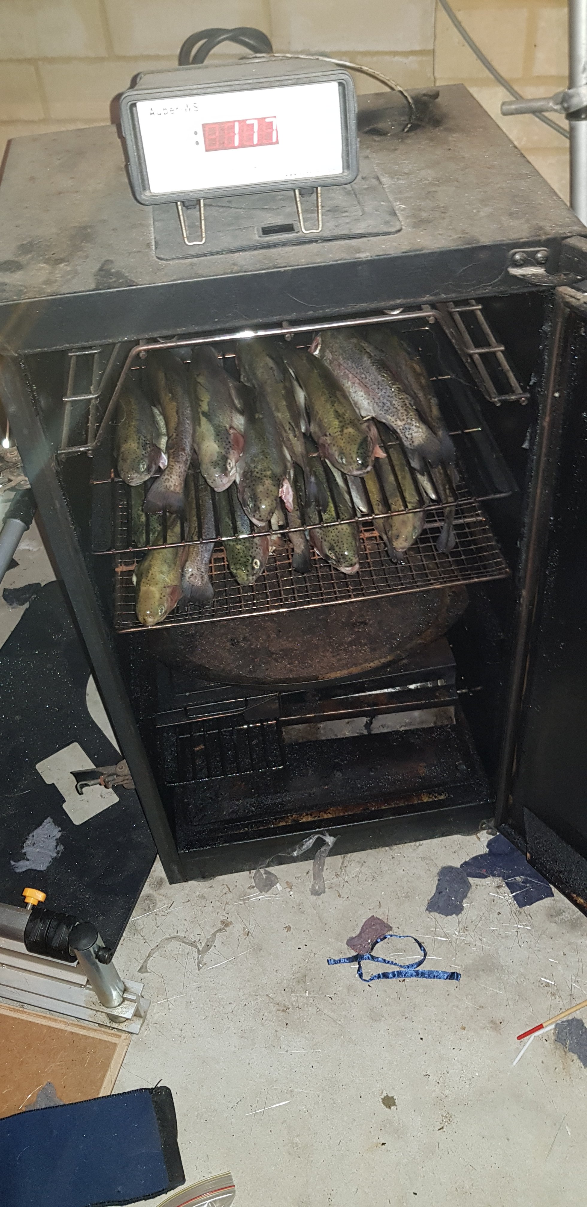

 be very interested what u did with the smoker - does that digital readout also control the smoker?
got same model but i wired mine up to switch off on internal temp

Yeah mate. I found that the smoker's control was useless as the probe is at the top of the smoker where the temps are hottest and it works on a thermostat so I had big temp swings.
I have bypassed the smoker's controller and it is now plugged into an Auberins PID controller (not cheap at around $200) with the probe where the food cooks so it's an accurate rock solid temperature rather than the +/- 10 degree swings I was getting
