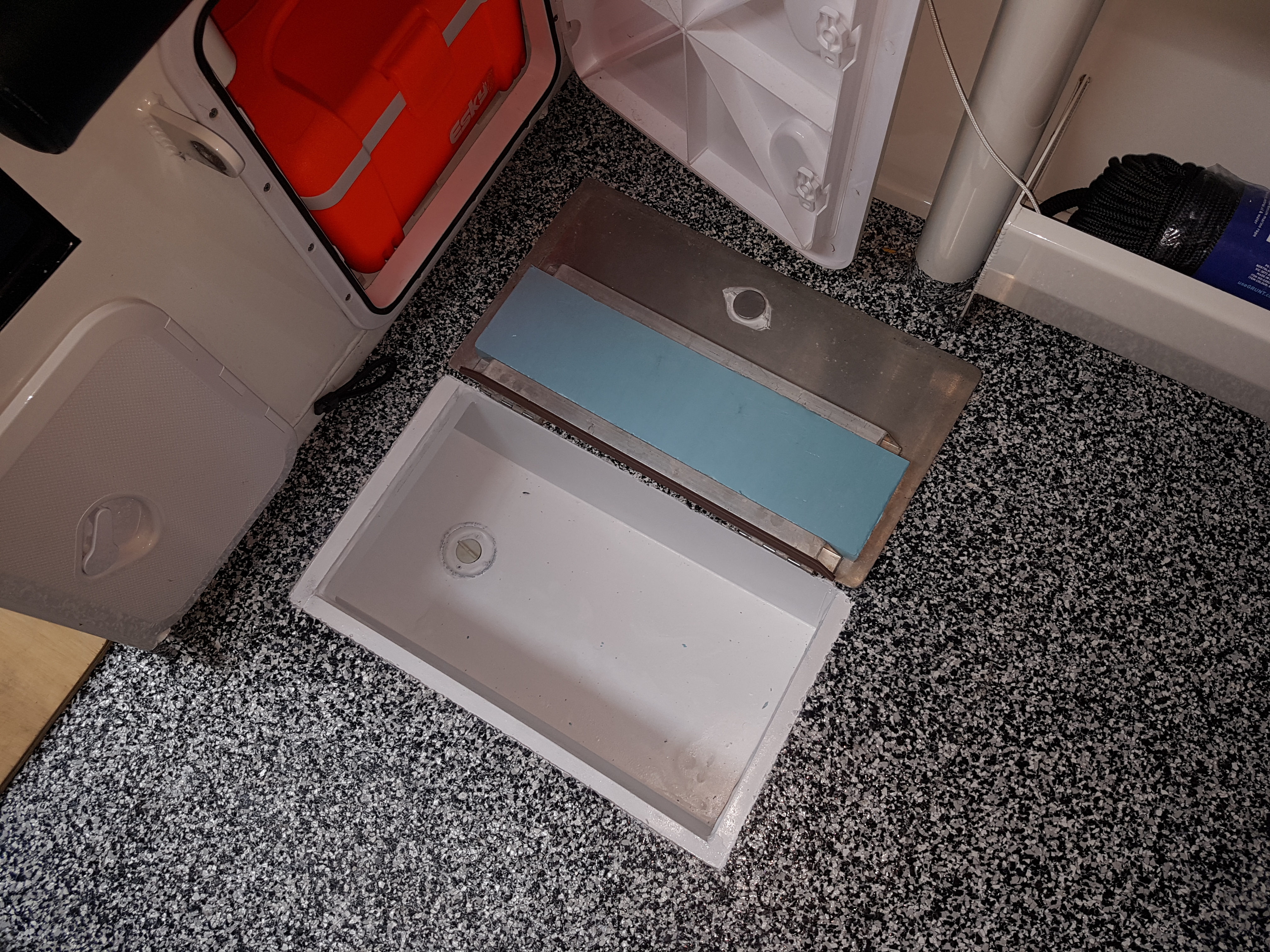

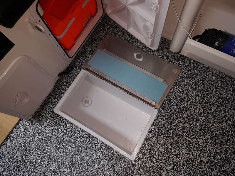

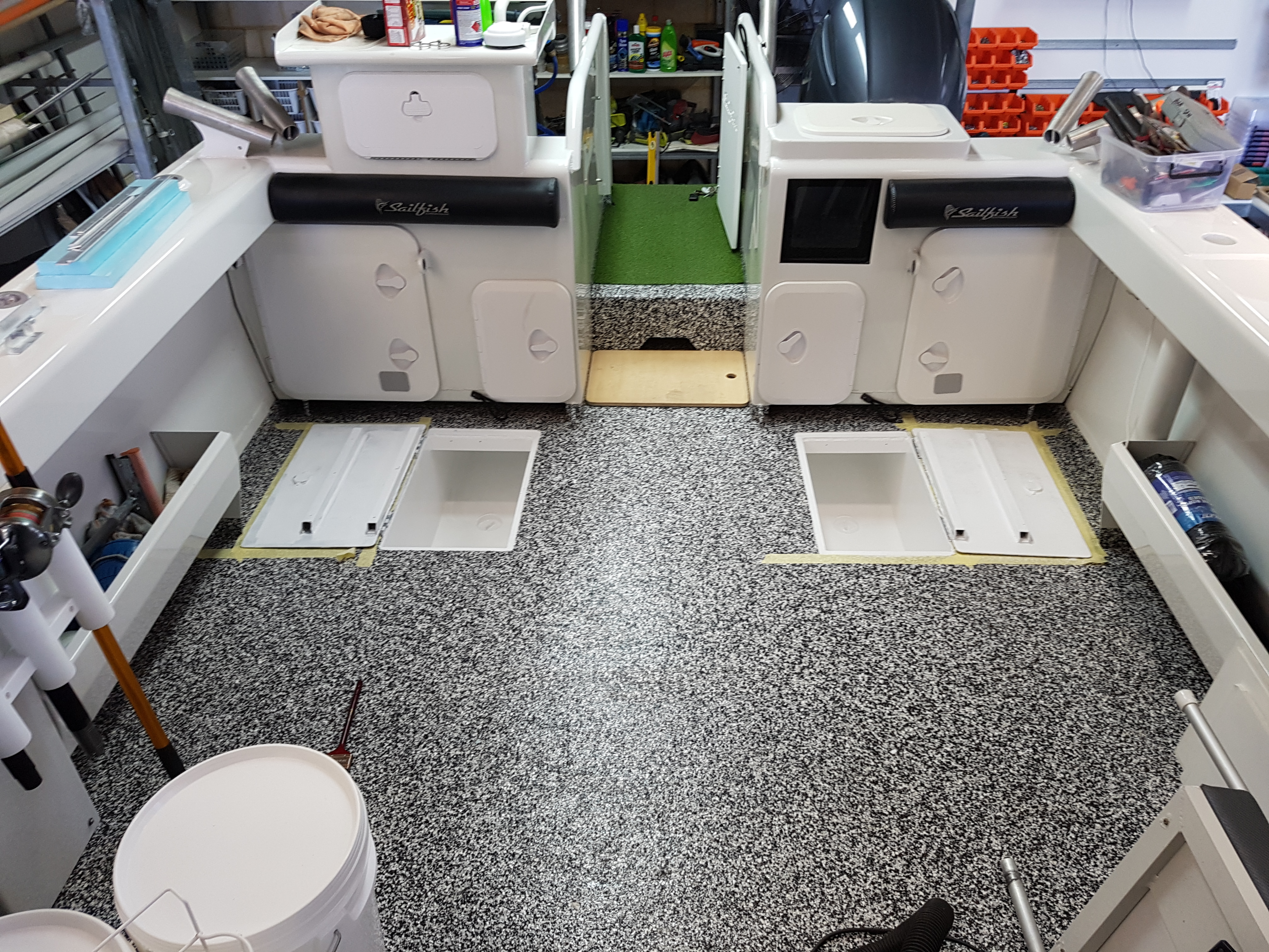

General Information if anybody is interested - I have just insulated and water proofed my 2 under floor kill tanks so I now have the option for Kill tank or Eskys.

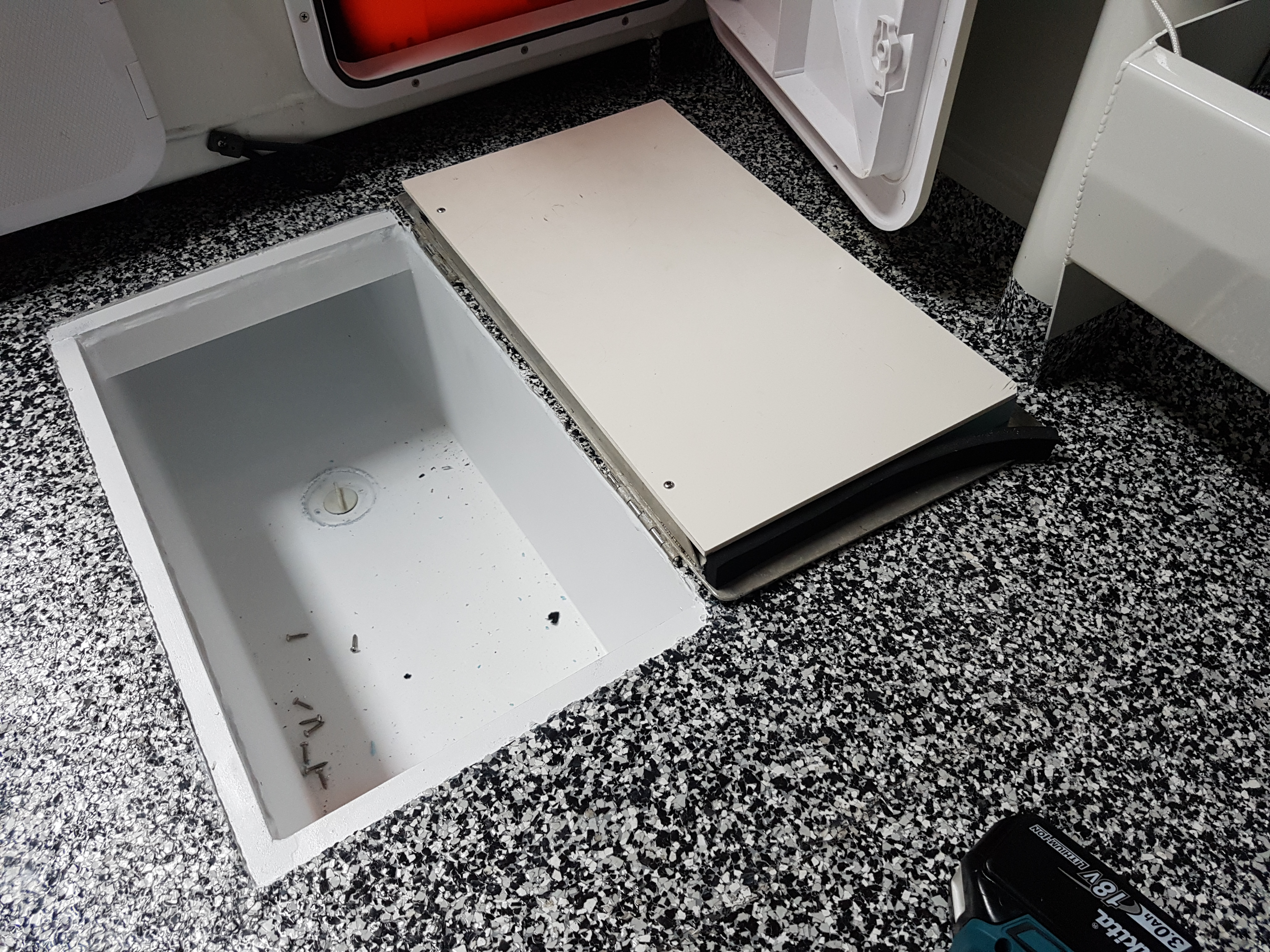

Insulated tank with Insulating paint additive into 2 pack. Rolled on 3 thick coats. Trick is to isulate the lid (blue board) high density foam and sealed with Neam Board.
Installed an aluminium strip to top of well for lid seal to seal against. added seal to lid.
Ice last for days now. No more eskys in back of boat and deck water no longer an issue.
Insucladd - Micro Ceramic spheres ls with air pocket
Blue board insulating foam
Nema board to protect and seal the foam
16 x 6mm Raven EPDM seal
