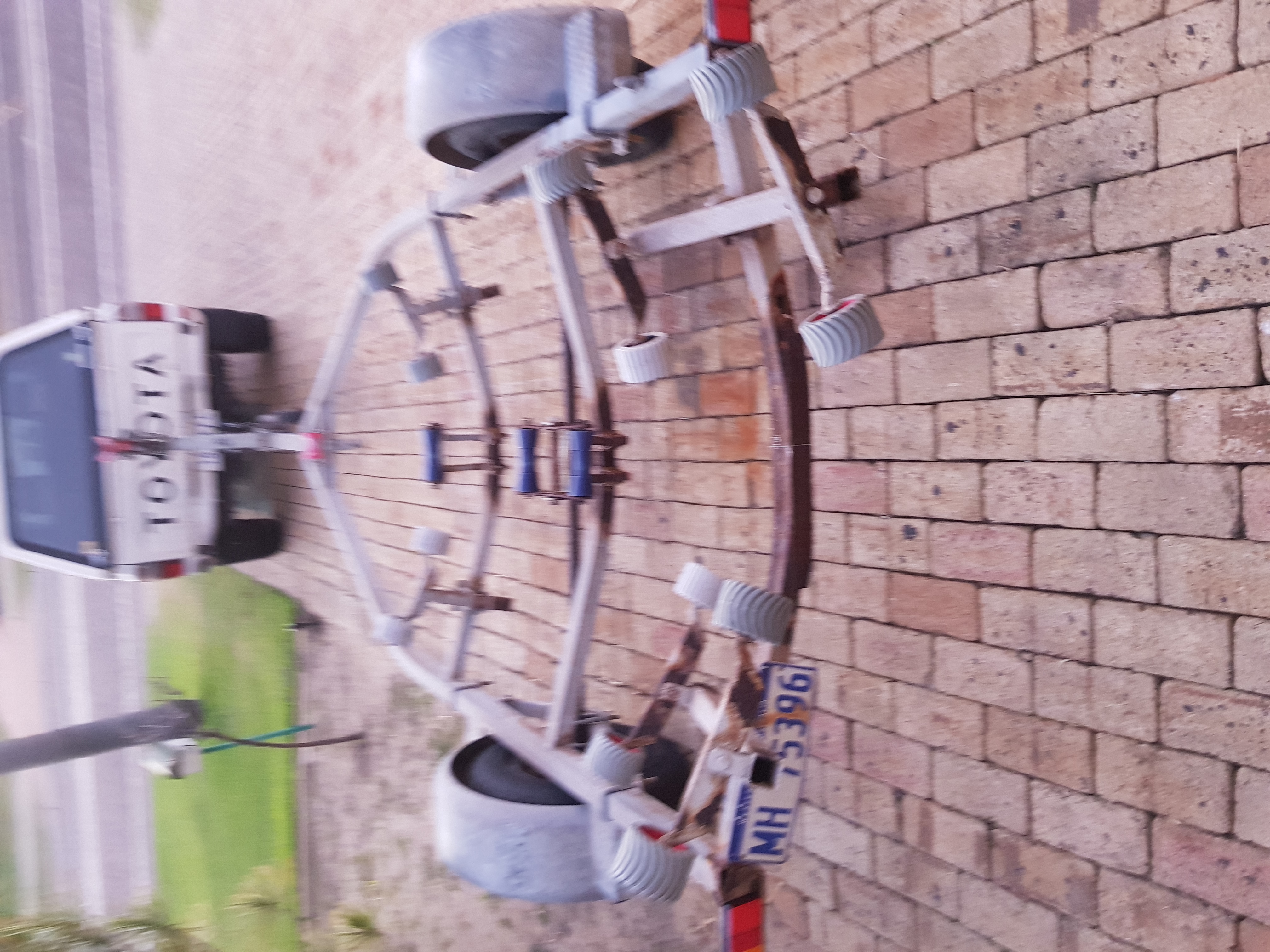

Repainting b o at trailer
 Hi all
Whilst i have boat of trailer to get some work done on it
Can some one recommend the best marine paint to use either by brush or spray can to repaint trailer tia
