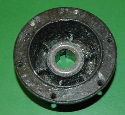

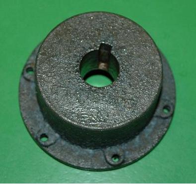

Soaked it in Balistol overnight.  Got it pretty hot with a paint stripper.  Got a 4" 3 leg puller onto it, could only get a grip on the shroud which bent as soon as any pressure applied.  Used a 3mm plate of steel to back the shroud but that bent as well! Had to remove the wheel to remove the shroud to get at the back of the hub.  No go on the nuts - they're stainless steel and stripped the alan key!  Out with the angle grinder, cut up the wheel (it was useless anyway) to give me a chance to get some multigrips on the nuts.  First four out, then two snapped.  Then with the puller on the back of the hub and a LOT of force at last it's off.
I guess I'll find out tomorrow if it is the current spline.  Looks like what I've seen in the shops but the keyway isn't all the way through on this hub.  Crossed fingers.
Thanks again for all the advice - helps with the confidence to keep going when everything is going pear shaped, knowing others have been down a similar path before.
 Not a fish but I'm pretty pleased to have it in my hand at last:
Brad
