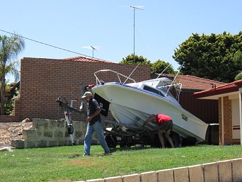

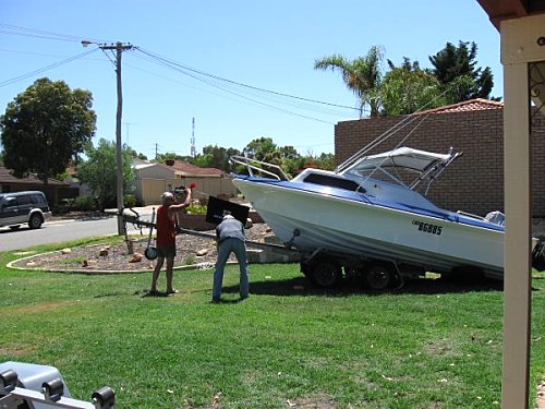

Will post a couple of pics
Mon, 2010-06-21 21:06
Got thge pics sorted.......
Only took 15 minutes of winding and adjusting rollers to get it up all the way.
OH!!!! And if a short arse like me make sure you get a socket and long handled ratchet for the winch Surprised
