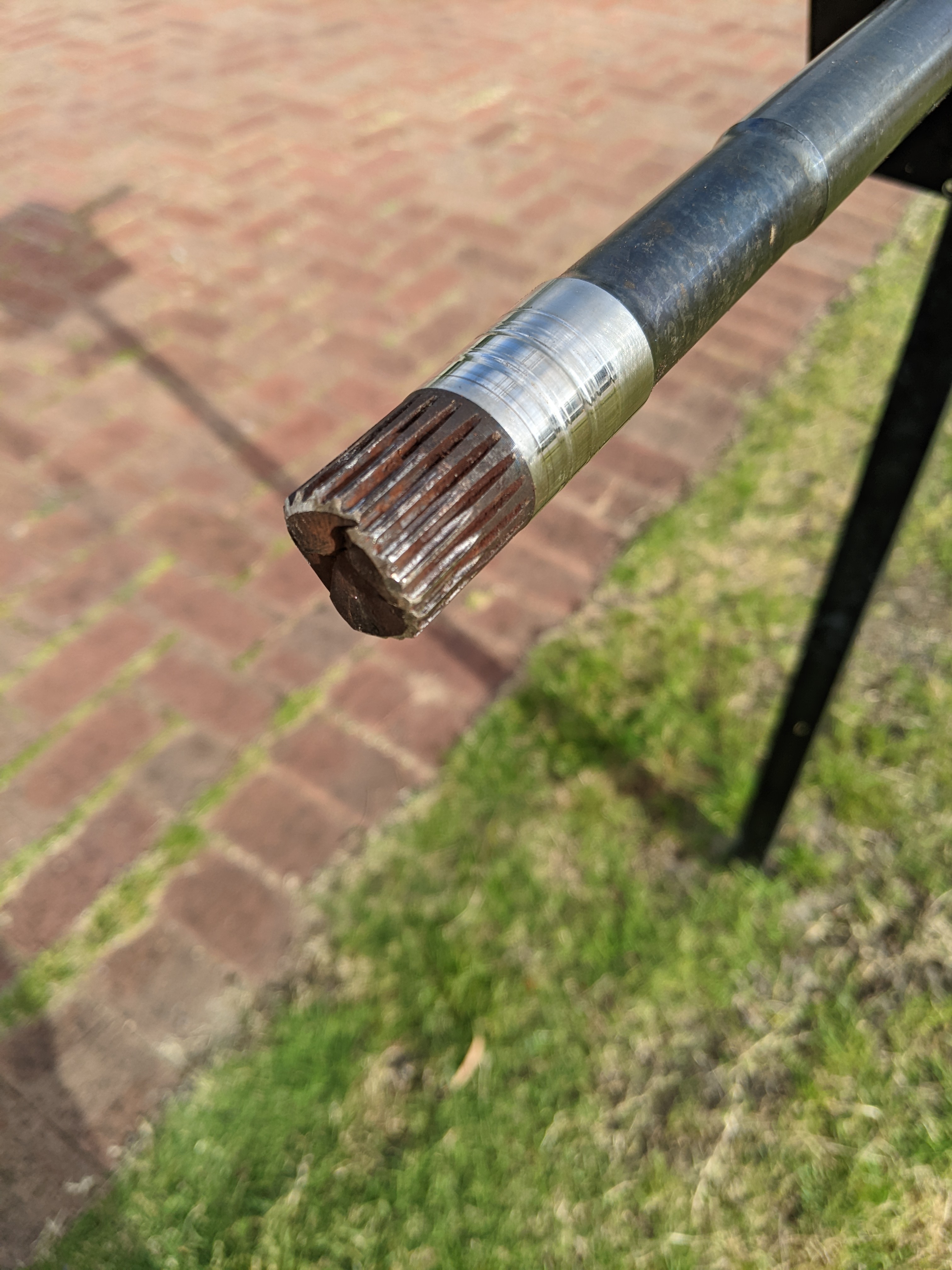

I recently hit a floating cray rope and unbeknown me at the time, the motor suffered substantial damage.
The drive shaft sheared in the driven gear but a sufficient length of splines remained intact and allowed me to continue boating on the day and subsequently until the service as detailed below.
I only discovered the damage when I started to do the 1100 hour service and dropped the leg to carry out the impeller replacement.
Once the leg was off it was immediately obvious that the shaft was damaged. The top of the shaft had sheared off and remained stuck in the driven gear in the powerhead.
I submitted a claim to Club Marine and was told to get a quote from a Marine Mechanic. This was not realistic as the powerhead had to be removed to ascertain the extent of the damage which in itself was 50% of the work so I decided to proceed with the repair.
I was extremely happy with the work which was done by a marine mechanic in Perths Northern suburbs and I submitted the final invoice to Club Marine for their response.
Unfortunately Club Marine have declined the claim for the following reasons (as submitted by their assessor) I personally find the finding totally unacceptable, unreasonable and unrealistic. They have decided the +- 25mm shaft failed as there was wear on the splines which allowed movement between the splines and the shaft. I find this an incredible assumption as in my opinion, the splines should have failed and not the shaft. I believe this was not a gradual failure as is being ascertained by Club Marine, but an instantaneous failure on impact with the cray rope. The sad fact is had the shaft failed below the splined area, I believe the claim would have been honoured as the boat would have been rendered unusable immediately leaving no doubt as to what had caused the failure.
I am asking for opinions as to the damage on the shaft and the views put forward by Club Marine and for any advice from anyone who might have had similar damage and a subsequent claim to their insurer. Be great if anyone with lots of metal experience / knowledge could comment
Thanks - Eric

 Hey Eric, I'm hd mechanic
Sun, 2022-10-23 08:49
 Hey Eric, I'm hd mechanic and work with large machinery with shafts,pins,axels ect. From what I can see the splines apear to be substantially worn and dry and at 1100 hours it is has done some work.How ever has exessive spline wear happened prio or post the breakage is anyone guess.A lot of failures I see have started from a small fracture of some sort that over time works it's way through the metal causing weekness and at some point when a heavy load is applied you end up with it breaking. If you can persure a claim good on ya but unfortunately it looks to me that it's a pill you have to swallow mate.

 The mechanic who did the
Mon, 2022-10-24 07:35
 The mechanic who did the work, his opinion should hold the most sway.
Sunshine above is the one who can make a difference though.
It seems an odd place for the shaft to shear?
Was the broken off piece available for inspection?
If the snapped off piece had spline wear then it was obviously prior to shearing.
But also, anyone who takes an insurers first response as final is the insurers favourite client.
Pursue it, even if for a negotiated settlement

More info
Tue, 2022-10-25 14:53
Hi All, and thanks for the responses so far.
Bodgy 79, I firmly believe that the damage is a result of hitting the cray rope. I dont remember exactly how fast we were going, but I normally run the motor at around 4200 RPM, so a considerable amount of force would have been at play. The motor cut immediately on impact. (Never mentioned in the earlier post that the motor is a 250HP Suzuki
We checked everything out, lifted motor out and checked prop etc. No visible damage so dropped the motor back in and started back to the ramp. As I accelerated, there was initially an unusual noise (rumbling maybe) which stopped shortly after. I now believe that was the top of the shaft rattling till it seized firmly in place where it still is today in the old driven gear. I am soaking it all in penetrant at the moment in the hope that I can get the broken bit out eventually. If there is no rust on the splines of the broken part, I believe that will indicate that the current rust etc was post impact and will give me another level of argument. But, as you say, that is anybodys guess so I believe that at the least, Club Marine should negotiate a part settlement.
Keg, not sure what you are trying to say, but looks like you're indicating that I shouldn't claim in the first place.
I have been a member of Club Marine for 11 years and had one minor claim when a person on board fell off the boat and broke of a part of the Gunwale when all 95Kg of him tried to climb back over the side. In this instance, I did the repair myself rather than go with the $2900 quote from a fibreglass company. Club Marine did pay for the 3M5200 marine adhesive. My payments to Club Marine are not a donation. They are meant to cover me in the event of a mishap which I was unable to avoid
Rob H, thanks for helpful input. As indicated above, the broken bit is still jammed firmly in the driven gear. What is my next option re pursuing it. I was considering the Insurance Ombudsman. Just dont want to get myself blacklisted
straith and Swompa, the repairer was Waterline Marine who came highly recommended by a person working in the marine Industry. Cameron has been excellent and I will have no hesitation in using his services again
Sorry for the looong post
Cheers Eric

Unpopular
Wed, 2022-10-26 05:48
 I showed this to a mate who Non Destructive Tests aeronautical parts, and also tests items after failure.
He agrees with club marine, says the spline wear, caused a weak point in the shaft, and the stress fracture propagated from there, causing the failure when you hit the rope.
He also said your hypothesis is not totally out there and it cant be ruled out. He also mentioned a defect in the steel when it was cast, cant be ruled out either without testing in a lab.
Thus, although I know this is unpopular, club marine went with the most likely option, and the bastards would win if you took it further. Sadly.
He says if you google metallurgist- Perth, you can take take it for an independant check at a hefty fee. He doesnt do anything but aircraft, I asked.

 Is it a maintenance part,
Wed, 2022-10-26 22:39
Is it a maintenance part, and is the wear on splines within Suzi tolerances?
Posts: 3339
looking at that spline to me
Thu, 2022-10-27 12:25
looking at that spline to me its taken a massive hit you can even see were its jammed before failure,
Wear my ass..how does a splined shaft like that wear ffs.
Keep pushing Eric.
Ericl's picture
Posts: 486
Date Joined: 02/05/11
Totally agree Brock O
Thu, 2022-10-27 13:33
My feelings exactly. Fatigue failure apparently shows up as a much more gentle even fracture. This looks like a volcano ! The top is still jammed in the driven gear where in my opinion, its twisted while the lower bit was jammed by the cray rope
Posts: 3339
Exactly..yes they do wear but
Thu, 2022-10-27 14:02
Exactly..yes they do wear but that's showing signs of a major failure to me, they dont get deformation in them from normal wear even after 1100 hrs.
I had a quick look over the thread for all the other comments from our experienced forum members who have broken a shaft also...couldn't find any even with massive engine hours, a failure due to wear to me is bullshit.
My last motor was a 95 Johnson..I don't have pic's but the shaft still looked new after who knows how many hours and I had wacked that a few times even smashed a prop, but still nothing like the attached.
One thing I will mention is the lack of grease. I'd presume this comes out when changing the water pump like most...why your mechanic hasn't greased it is a worry..the above comments are due to the signs of rust / corrosion build up, arguments of a notch / fatigue raisers causing the failure does have weight and is what the insurance company will work on.
I have 1972 Torana and the axles are still original, they have coped a hammering over the years with multiple broken diff centers. Extremely rare to brake a shaft even with high fatigue loads.
Putting a boat motor in gear in water...I cant see that wear from that sorry.

 Would of thought the
Fri, 2022-10-28 11:20
 Would of thought the coupling inside the prop would have broken before the drive shaft, have broken them before and they are usually only made of plastic last one it did was in a 175hp Merc running over a rope at dawn. From the photo to me looks like it's not new give the rust showing my guess it's been broken a while and likely a result of manufacturing defect. Had it snapped further down the shaft outside the coupling and was unable to drive at all after the hit my guess would be your claim would have a better chance of approval.

For those interested …..the final outcome
Fri, 2022-12-02 13:29
I am pleased to report that after some lengthy and detailed submissions the insurer backed down and accepted the claim with a reasonable depreciation allowance for wear and tear.
And please be careful out there, you don't need to sit on the reef to get crays, two rescues yesterday of boats with the bottom end of outboards ripped clean off and that was all before 7am
