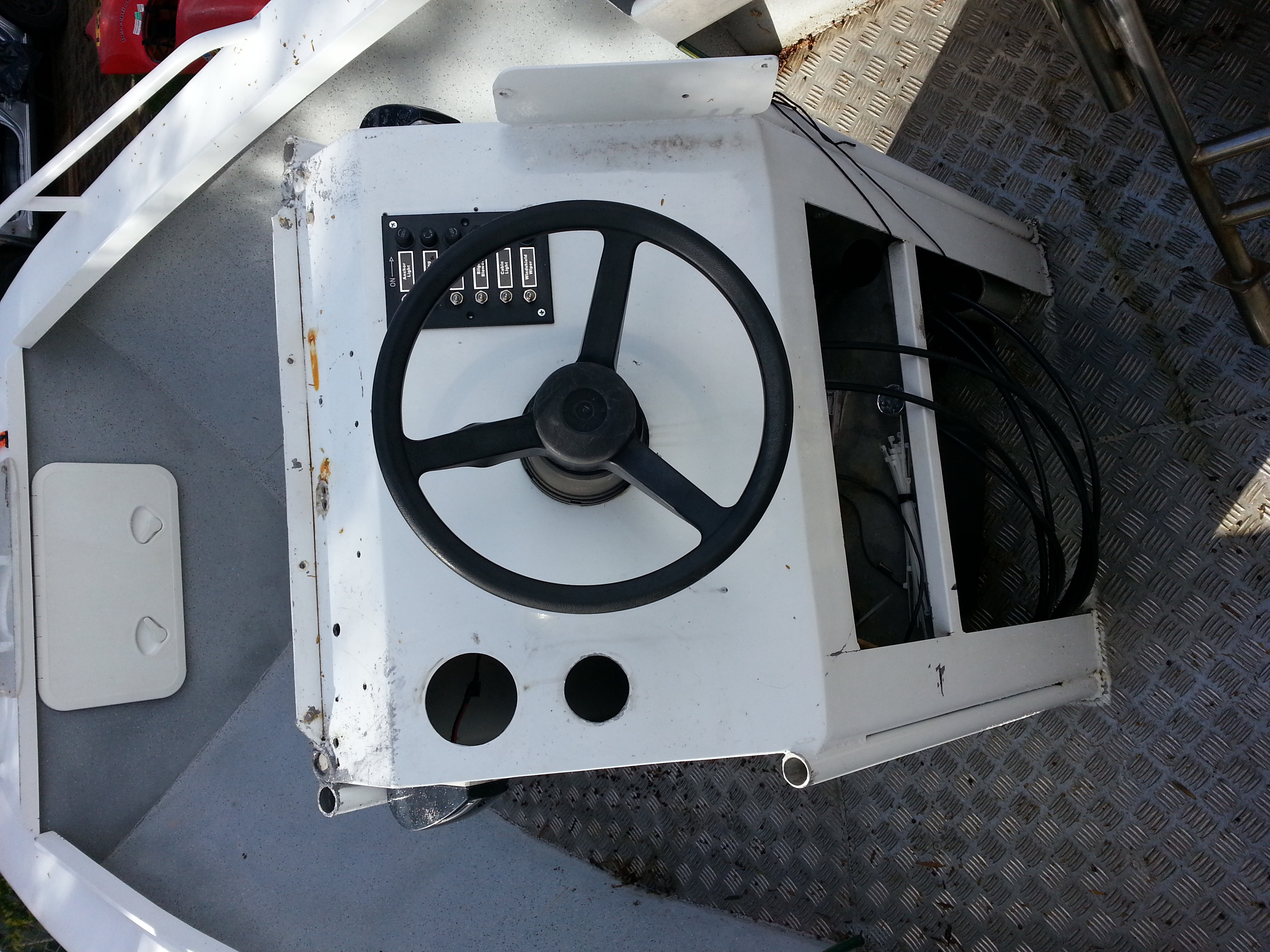

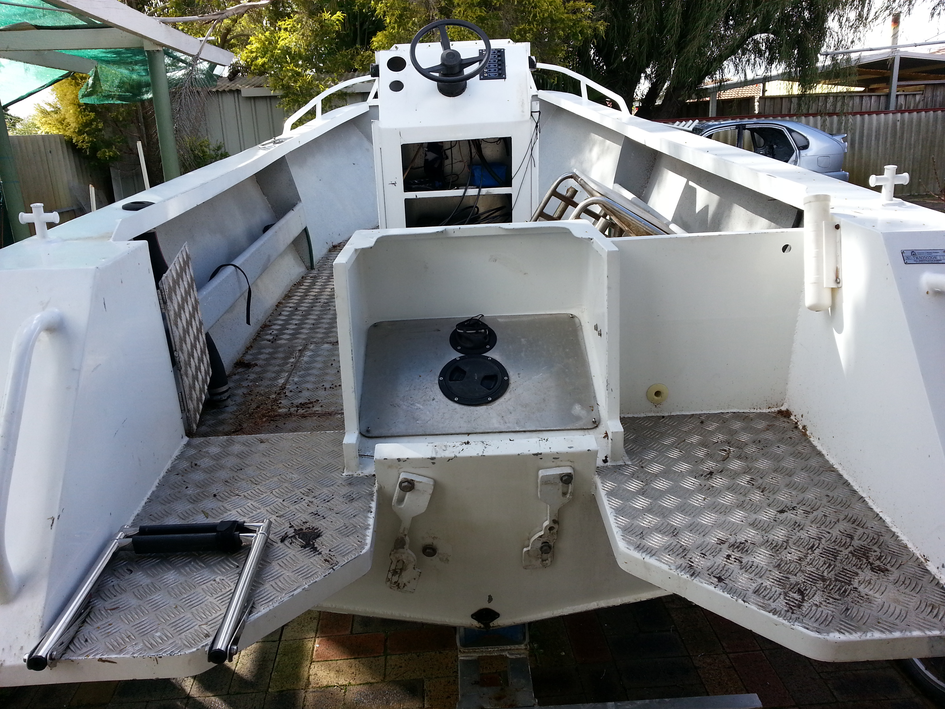

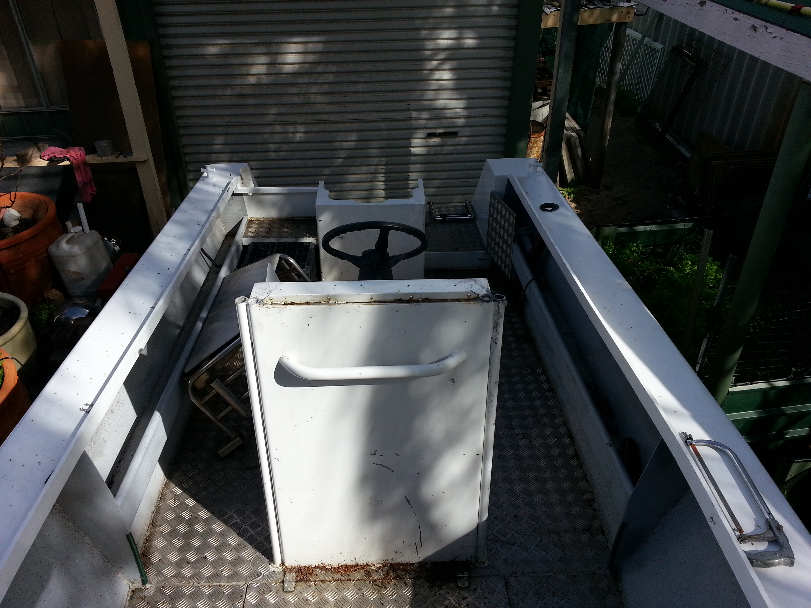

Upgrade time has come along. Bought a Custom plate 17ft Centre cosole and after a few sunny days its time to get into gear and get it ready for the upcoming summer. Winter Project time is here.
The to do list:
New wiring throughout
New auto bildge pump
Move battery up to uner the console (hopefully)
Custom fold down T top with windscreen (any design ideas/photos would be appreciated)
Mount up new Engine
Re-do hydraulic steering
Make a fuel guage for the new 80l tank
Build a new trailer with brakes
Get a fishfinder
Modify baitboard to fit over engine well
If you have any ideas for things which would go well let me know so I can try to fit them in.
Also any advice on how to check the floatation? the deck is welded on, and where it removes for the fuel tank I cant see any foam under the deck, and as it is a 2004 it was built just prior to the builders plate getting standardised so I am not sure how much flotation it has under the deck. I dont really want to take it to the ramp and fill it up with water.
Lets see what I can get done in the next 2 weeks!

As far as floatation goes
Mon, 2013-08-26 12:07
As far as floatation goes foam won't help with that - foam is put in only to add floatation once its full of water - That is it displaces the water in the given space (hull) with something that traps air (floats) - not sure they would put foam in an ally boat as I may aid corrosion??
If it helps your confidence my step father just launched a 68ft steel hull yacht. It weighs 51 tonne has no foam or floatation but still floats. (if it fills with water I'd expect it would sink rather quickly though).
tot's picture
Posts: 1170
Date Joined: 31/01/10
my ally runnabout
Mon, 2013-08-26 13:01
has the black strips of foam under the floor. will not go under if the deck fills up, all pressure tested. think its fairly common now days.

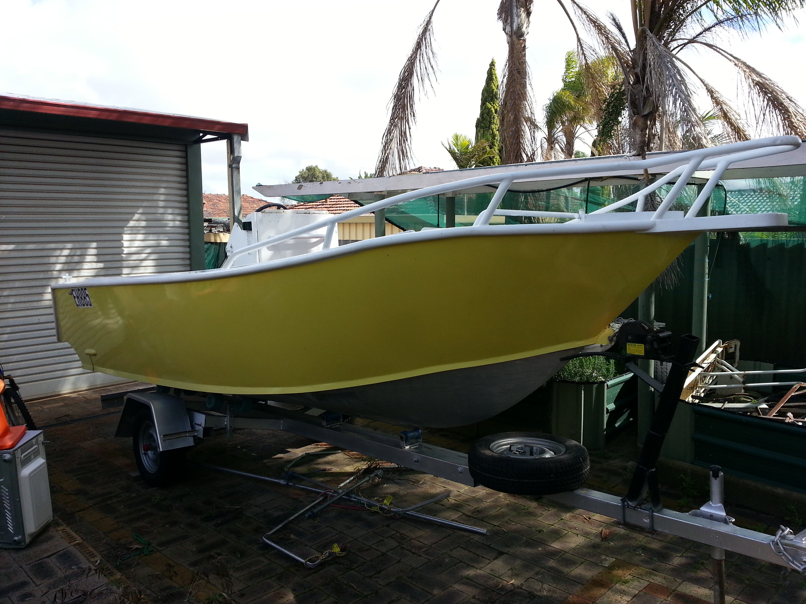

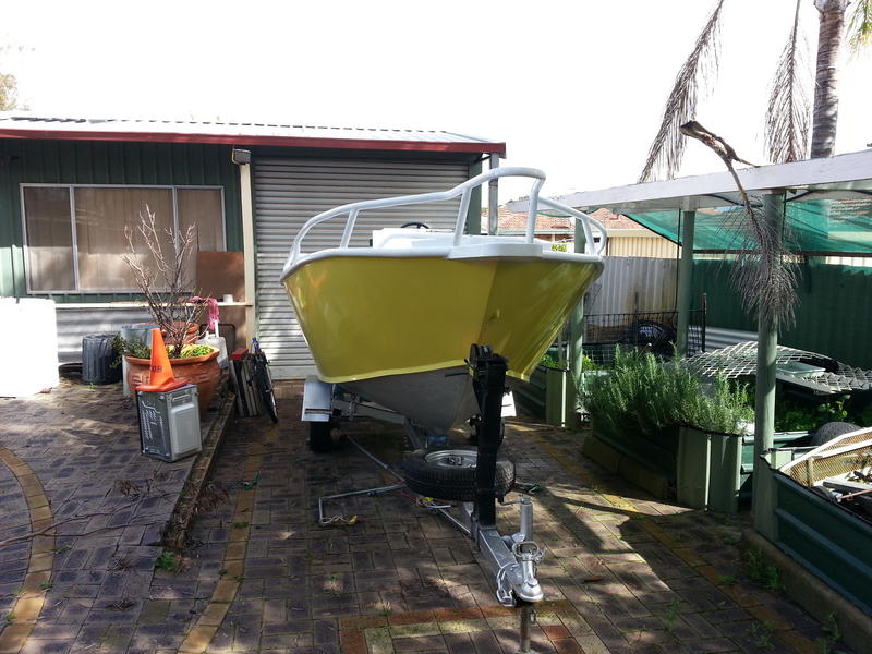

 Old westerberg by the looks
Mon, 2013-08-26 16:09
 Old westerberg by the looks ?? Good tub
Posts: 2925
Date Joined: 27/12/06
westy
Mon, 2013-08-26 16:34
thats what I was thinking
Josh's picture
Posts: 284
Date Joined: 14/09/10
 The fella I got it off
Mon, 2013-08-26 17:27
 The fella I got it off reckons he built it in 2004 off some plans that him and Dave jackman came up with to make boats which require less hp to achieve reasonablespeed and therefore less fuel cconsumption. I don't know how historically correct, butiit had an old 40hp 2st Suzie on it and it was getting 25 knots and was cutting pretty well through the chop to
