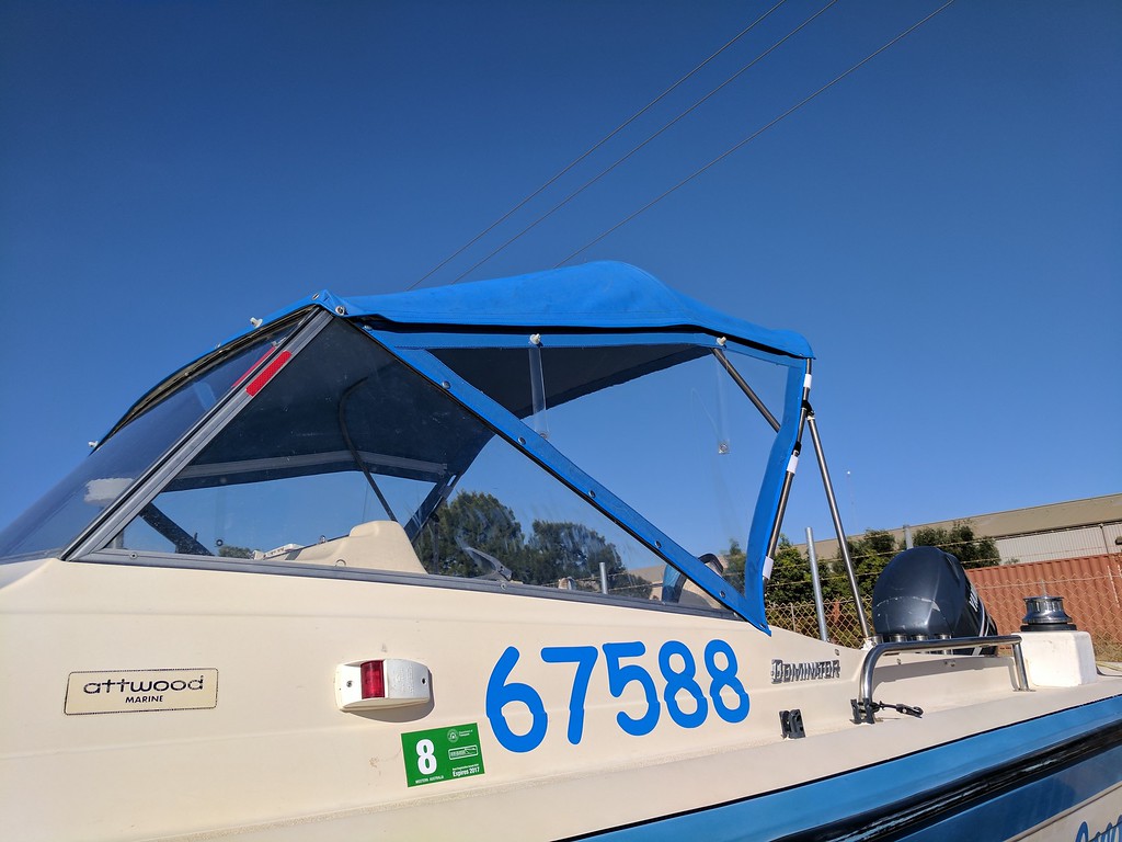

 Just had some clears fitted to the sides of the existing bimini . They are zipped on at the top, but with the dreaded press studs along the bottom edge. In my experience, these go to *hit very quickly in a marine environment if left alone. What are peoples' opinions on the best way to keep them working? Silicon spray, silicon grease, saw vaseline touted once?
