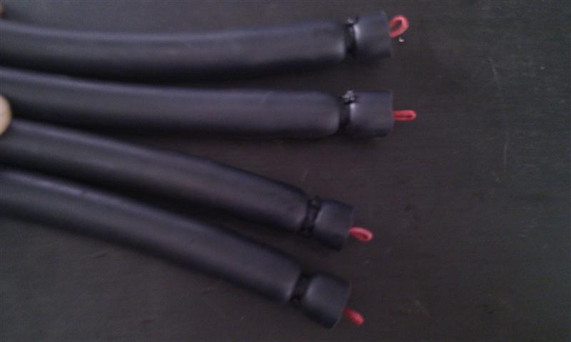

Picked up a used 1.4 gun for some FADs fun, I had some help doing the bands, so I made myself up a spare set.

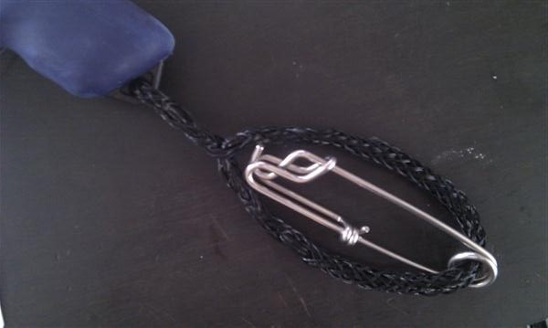

I also whipped up a handy loop at the end of the gun for the shark clip, so I can pass my hand through it whenever I'm unclipping it from the floatline. Its made from ski rope which is a hollow braid and its doubled back on itself as a minmum thickness.

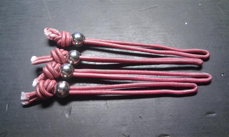

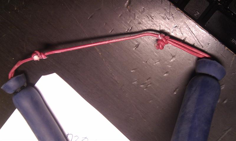

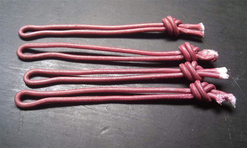

1) Doubled dyneema with an overhand knot.
2) The doubles with the bead added

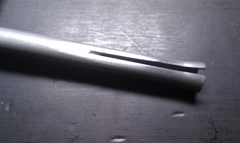

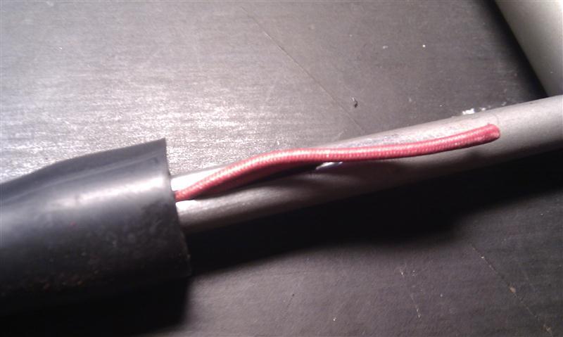

3) The cressi insertion tool. Out of the box, this needed work. It was too sharp and it cut the dyneema, and it was a little narrow for it as well. I had to widen it, and then sand the surfaces smooth.

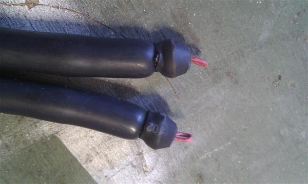

4) The double being pushed into the rubber with the insertion tool

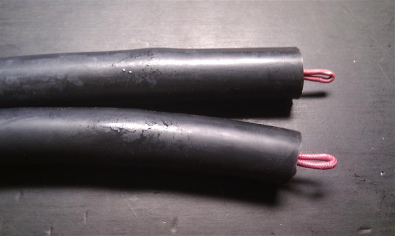

5) The rubber with the doubles inserted.

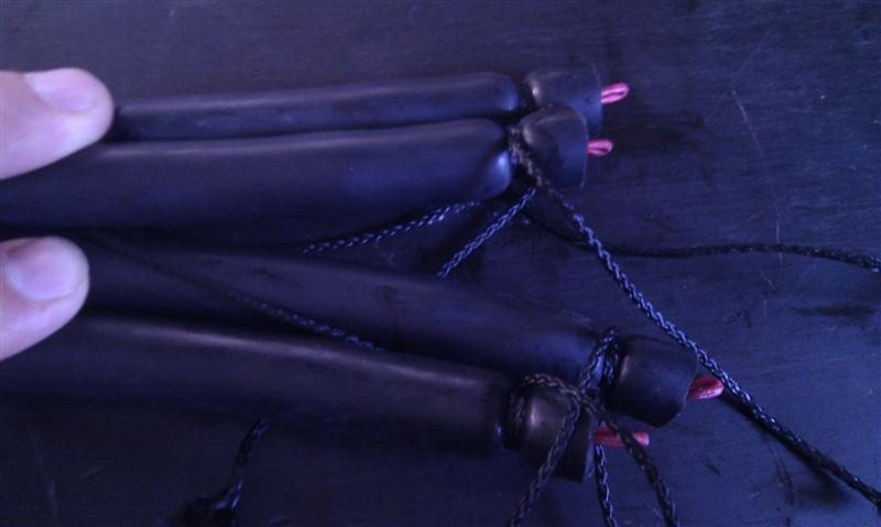

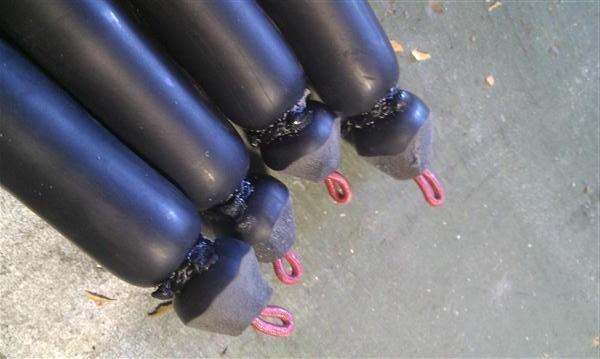

6) All tied up with the constrictor knot. The silicon lube really helps here. Grip the cord between some longnose pliers, then wrap it around the tip a couple times. Next pull tight and roll the rubber towards one end and the other, it helps get it really right.
7) Trimmed and the ends burnt off.
8) Chamfered down on the linisher.
9) A little shrink wrap applied.

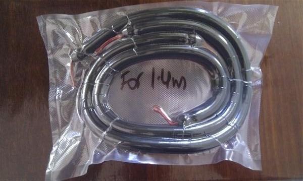

10) Labeled and vac-packed till I need them!
11) The loop in the braided rope with the shark clip on it.

So how do you attach your
Sun, 2012-01-29 19:08
So how do you attach your bridle ? I`m assuming loop to loop ?
Posts: 9358
Date Joined: 21/02/08
Not sure if you can work it
Sun, 2012-01-29 19:58
Not sure if you can work it out from the last image I added? Its a half-hitch, with the tension pulling it tighter, and the overhand at the end stopping it pulling through.
