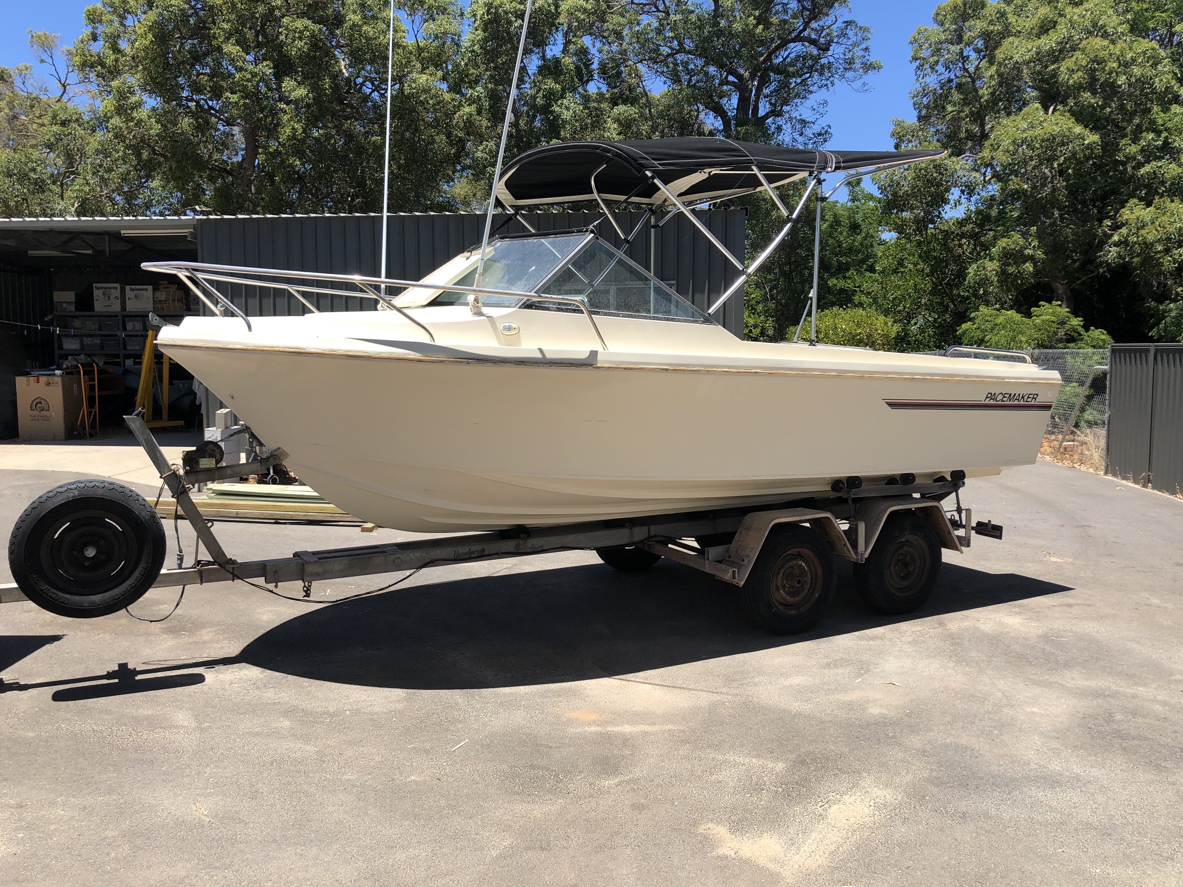

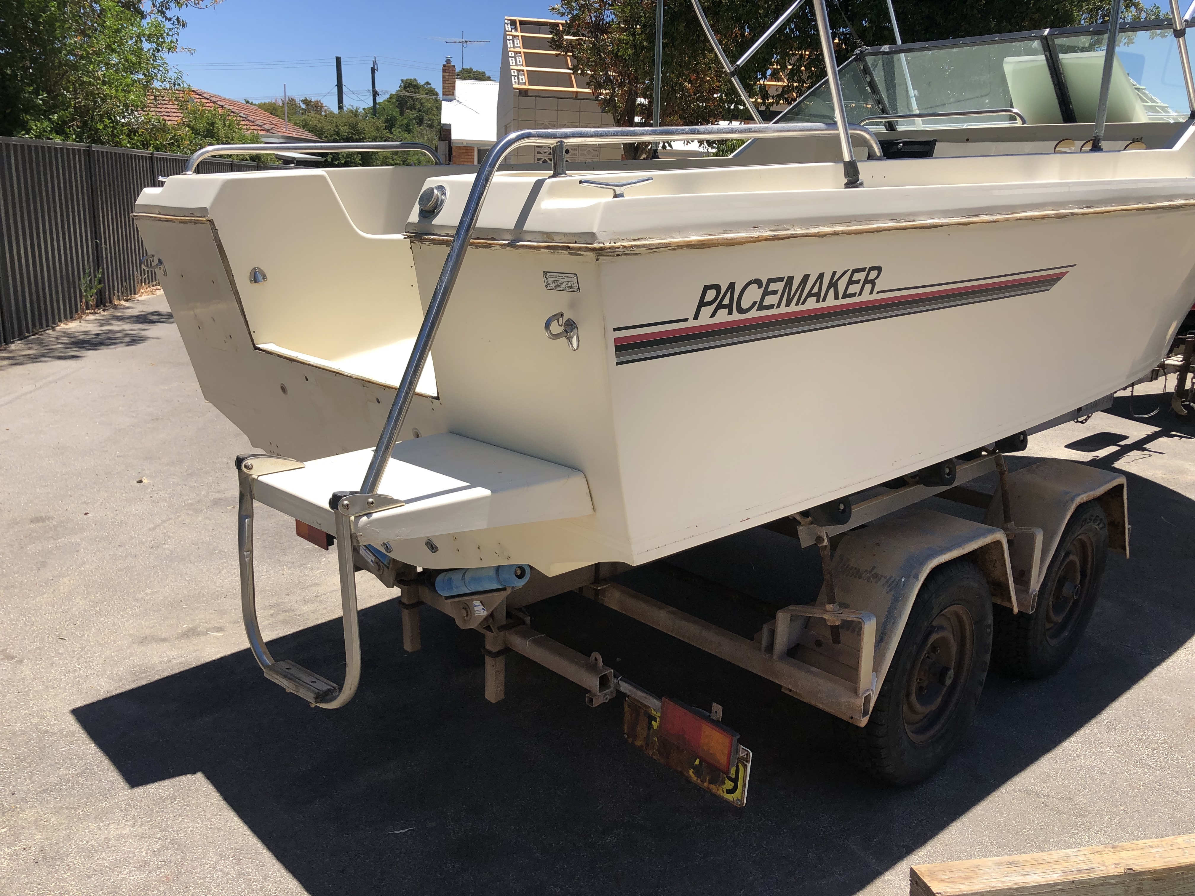

 Hi guys,
Picked up a great condition 560 charger a month ago and have just started to put it all back togethor now after gutting all the old gear out. I am a little hesitant to make a call on the new outboard size at the moment with recommendations either side of the fence.
I am looking at the three motors below but am a little unsure if the transom can safely take the extra weight of a 150. Have spoked to one of the members on here who has the df140 and was quite happy on the back of the same boat, but also have been out on the same boat with a F175 which handled really well off and had an unreal top speed and good economy for getting out wide!
I do a lot of trips to shark bay and exmouth and do some long trips to get too the areas i like to fish, likely to do runs out too the trench for marlin/YF when the water warms up as well.
Suzuki DF140 approx 50kg lighter and significantly cheaper
or
Suzuki DF150 / Yamah F150 much better torque and better cruising speed.
Any advice or experience going through the same decision process would be much appreciated!

Get Ben punch from fibrelite
Sat, 2019-01-05 16:15
Get Ben punch from fibrelite to check the transom if your worried about the weight
on the back.

The V doesn't look too deep,
Wed, 2019-01-16 14:30
The V doesn't look too deep, so I would go the 140hp Suz tried and tested. I would definitley look at raising the transom up to 25inch

My be late but something to consider
Sun, 2019-05-12 18:48
fwiw I have just dropped a new Mercury 175hp V6 4 stroke onto a 5.6m Pacemaker Charger.  Replaced a 135hp V6 2 stroke.  Initial impression is very positive.  Fuel pretty good so far and performance +45 knots.  According to Peter Blowfield (Mr Pacemaker) the boat was one of his last fully hand layed units.  He had no concerns with the transom for the new outboard.

Bit of an update
Sat, 2019-08-31 12:42
Taken a while to get here but almost at the end now.
Ben Punch has been looking after raising the transom, cleaning up a bunch of penetrations, side pockets and a few other things...a lot more $ being spent than I had hoped but glad to have it done right!
Outboard selected is a white Suzi 140 which should be dropped onto it in the next couple of weeks, Simrad nss12 sounder and a few other things to install and we are away.
