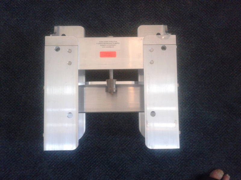

I have a Optimax 225 mounted on my tinny via a Quicksilver Paralift hydralic jack plate and it has good and bad points.
Bad things are that it sets the motor back from the transom an extra 300mm causing prop cavitation in rough seas (can be solved by lowering motor hieght), places more stress on the transom due to leverage (my transom has been beefed up to suit) and like trim it is another thing that needs adjusting to suit the conditions/boat load etc.
Good things are that by lifting the motor hieght it reduces drag and improves fuel economy (lifting the motor by about 75mm decreases rpms about 500 for the same speed as if the motor was in the normall position, and saves about 8 ltrs/hr in fuel consumption). In shallow water I can lift the motor up instead of trimming it out and i don't loose the ability to steer and reverse like it normally would (great for getting into creeks and over reefs)

I have just recently put a manual jacking plate on the back of my douglass craft. It has raised the outboard to the point now that it does no longer leave a fantail at cruising speed. The construction of mine was without a doubt the best bit of engineering I have seen in ages. (I am a fitter/turner by trade) I have been 25 mile out in her off Ocean Reef with no hesitation and like Tony said I have noticed a considerable increase in fuel economy and better hole shot. Where are you looking at getting it from? I got mine from the States and cost just over $300 including postage and it took just on a week to get it.
