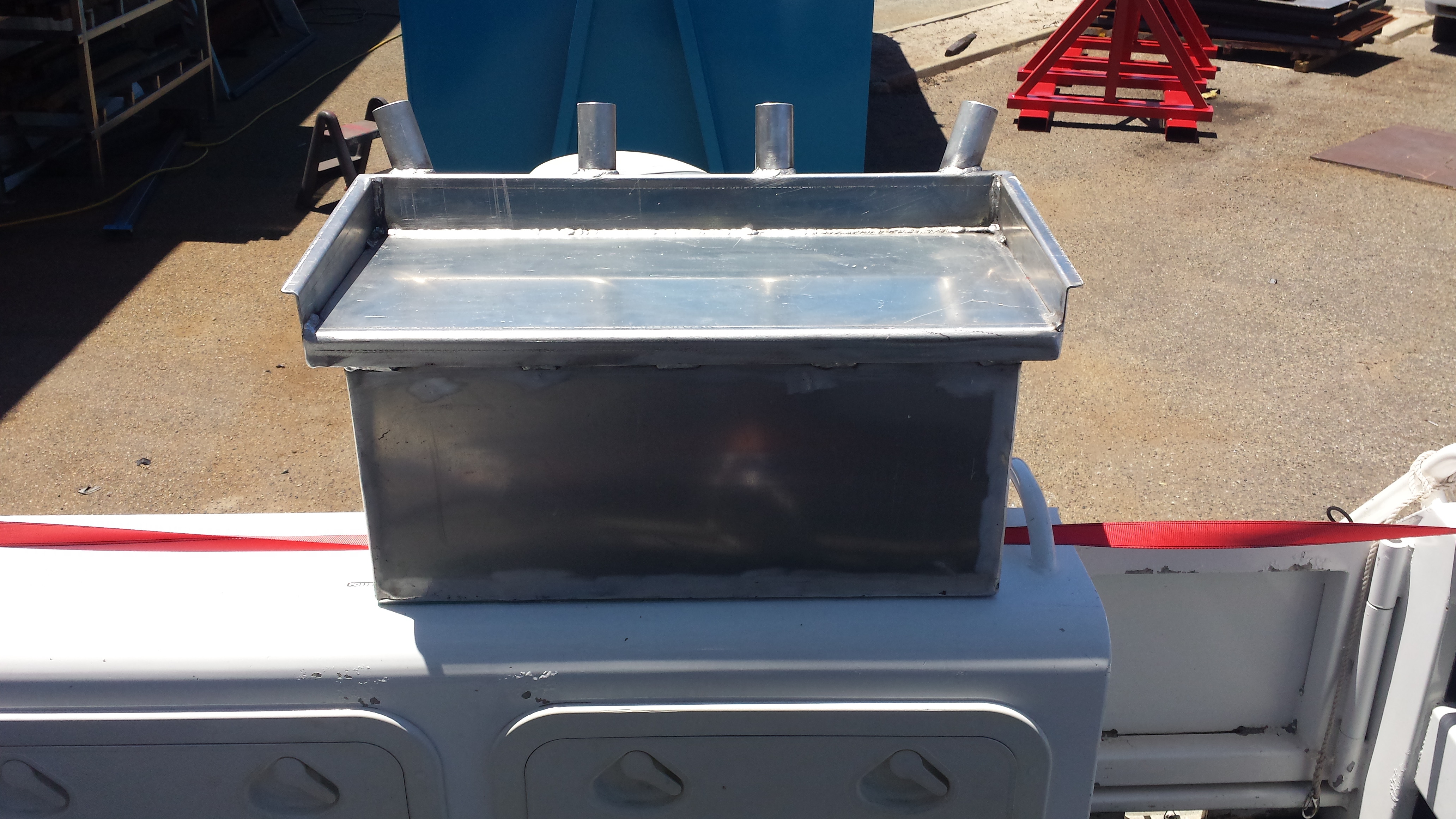

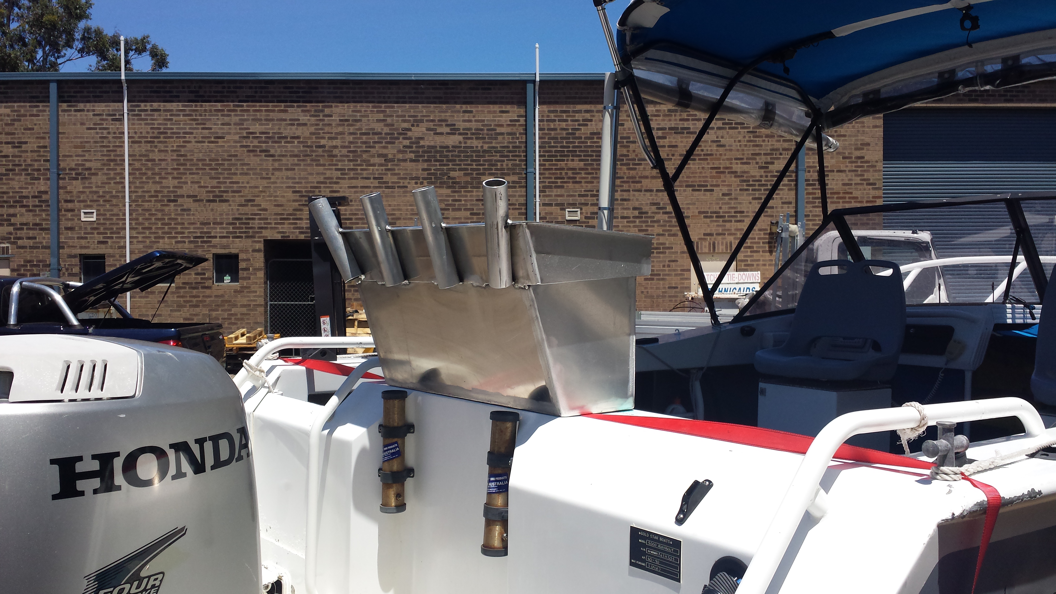

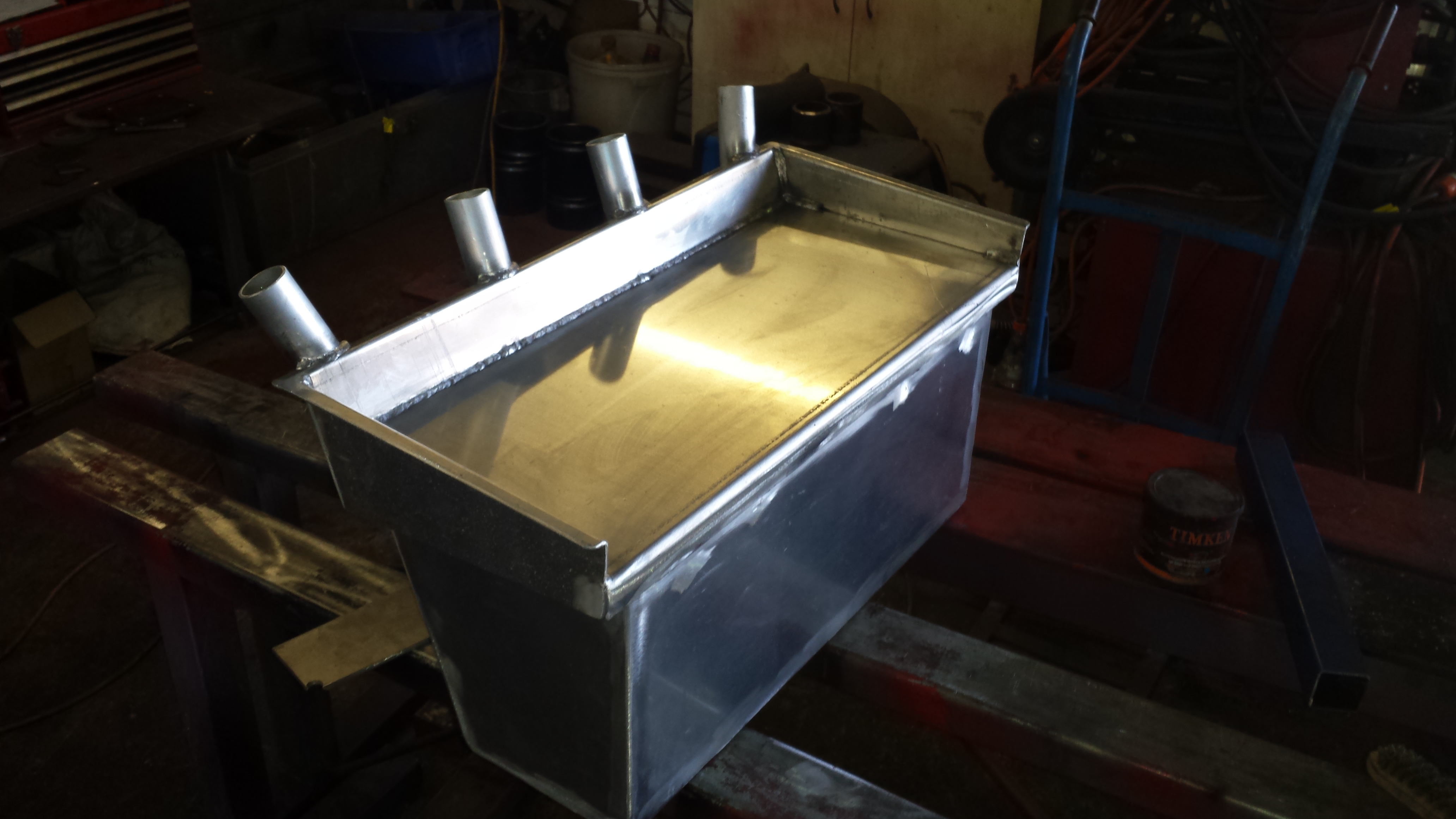

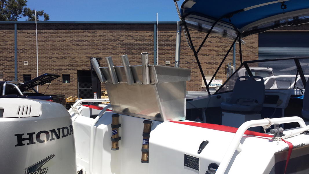

Next project coming along nicely - new bait tank / table
I wanted to improve my live bait set up, which until now has been a 60 l solo bin on the back deck with an externally mounted bilge pump.  Came across a combo bait tank / table on line and found someone locally to make one up (that person can identify themselves if they wish or remain anonymous ).  And it's progressing nicely!
In the meantime I am installing a stainless steel skin fitting, stopcock and bait tank pump under the tiller flat.  This will also provide a pick up for the deck wash.
Will post more pics as it progresses.
