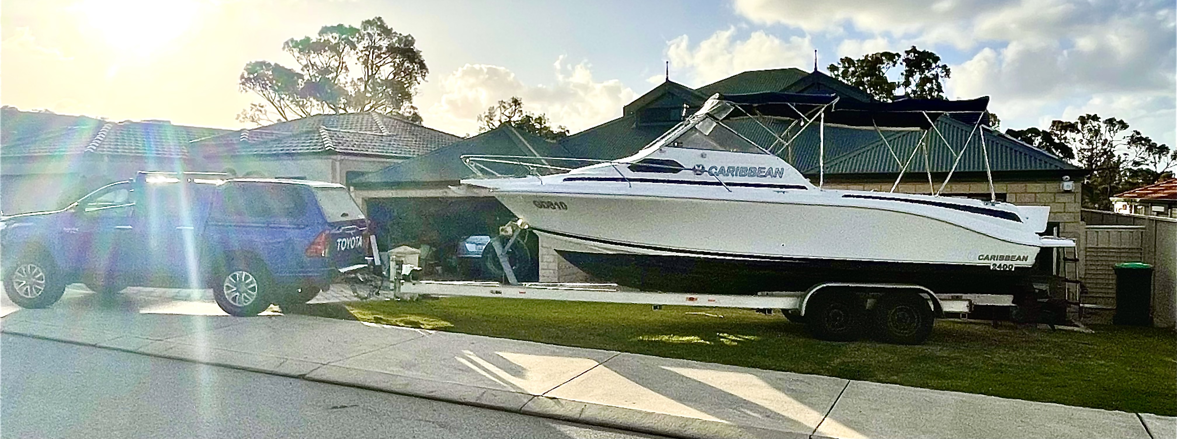

Hey fellas. I've finally secured my "forever" boat.... a 2010 Caribbean 2400. Pretty fuckin pumped, and lookin forward to summer now
anyway I've had to modify the trailer slightly to fit it in my driveway, and I'll have to move the bunks/skids, so was considering making brand new ones.
A question for those in the know, what is the best timber or materials to make bunks/skids out of?

Duralite trailers sell composite bunk boards, not cheap but only way to go.

 hdpe plasticslippery as fk -
Wed, 2022-08-31 16:10
 hdpe plastic
slippery as fk - never rusts
theres a mob in wangara that sells it half the price of boatyards
cant remember the name soz

The tank planks like on my old Whaler were really soft and gentle on the hull...I looked around in Perth to replace mine and could not find much, my mate built two bunk trailers withthe composite stuff mentioned above, a bit hard but way easier to get the boat off the trailer.

Another one for Duralite trailers in Rockingham mate. They have the composite bunk material which is already cut with the deadrise angle on it. Just tell them the legth of your current bunk and they will cut it for you to length you can also plain or sand the bunks to a different angle deadrise if required.  They also have all the hardware required to mount them if your current gear needs an upgrade.
I fitted them on my trailer a year ago and they work a treat. No more worries about carpet coming off or Sand getting in the carpet which happens a lot up north. Much better option then wood and carpet bunks. I would also reccommend getting a forward V bunk from them also. I fitted this and now the boat lines up perfectly with the winch post everytime.
