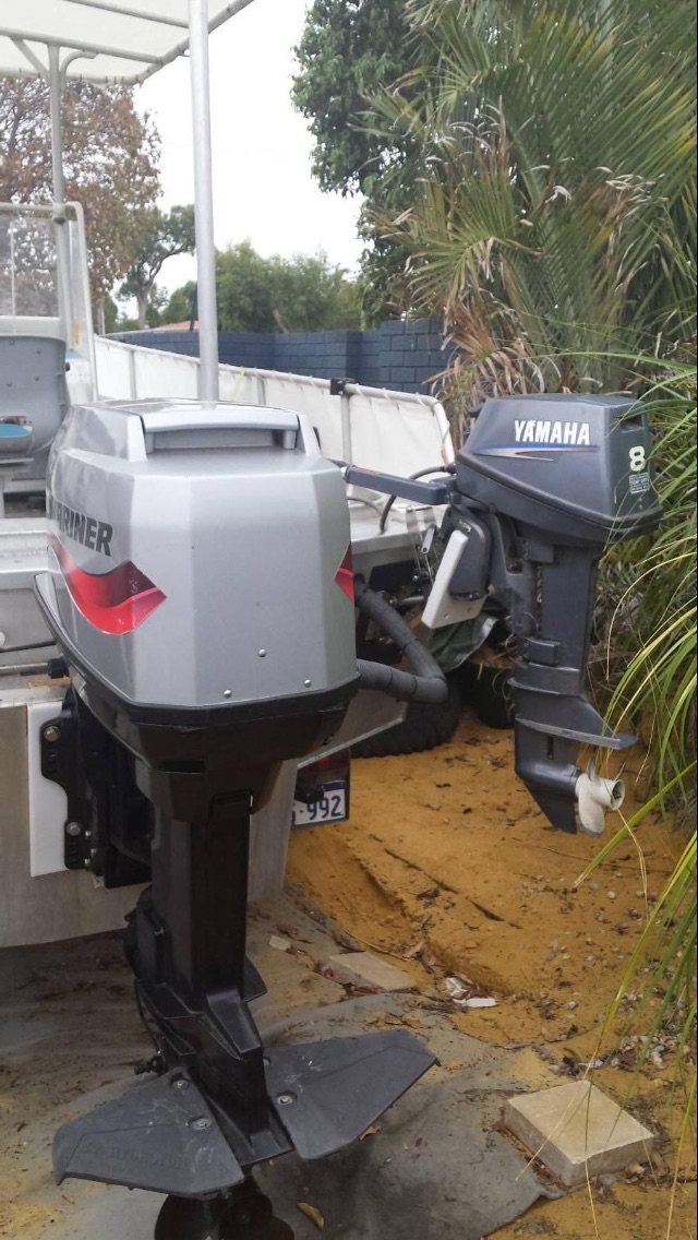

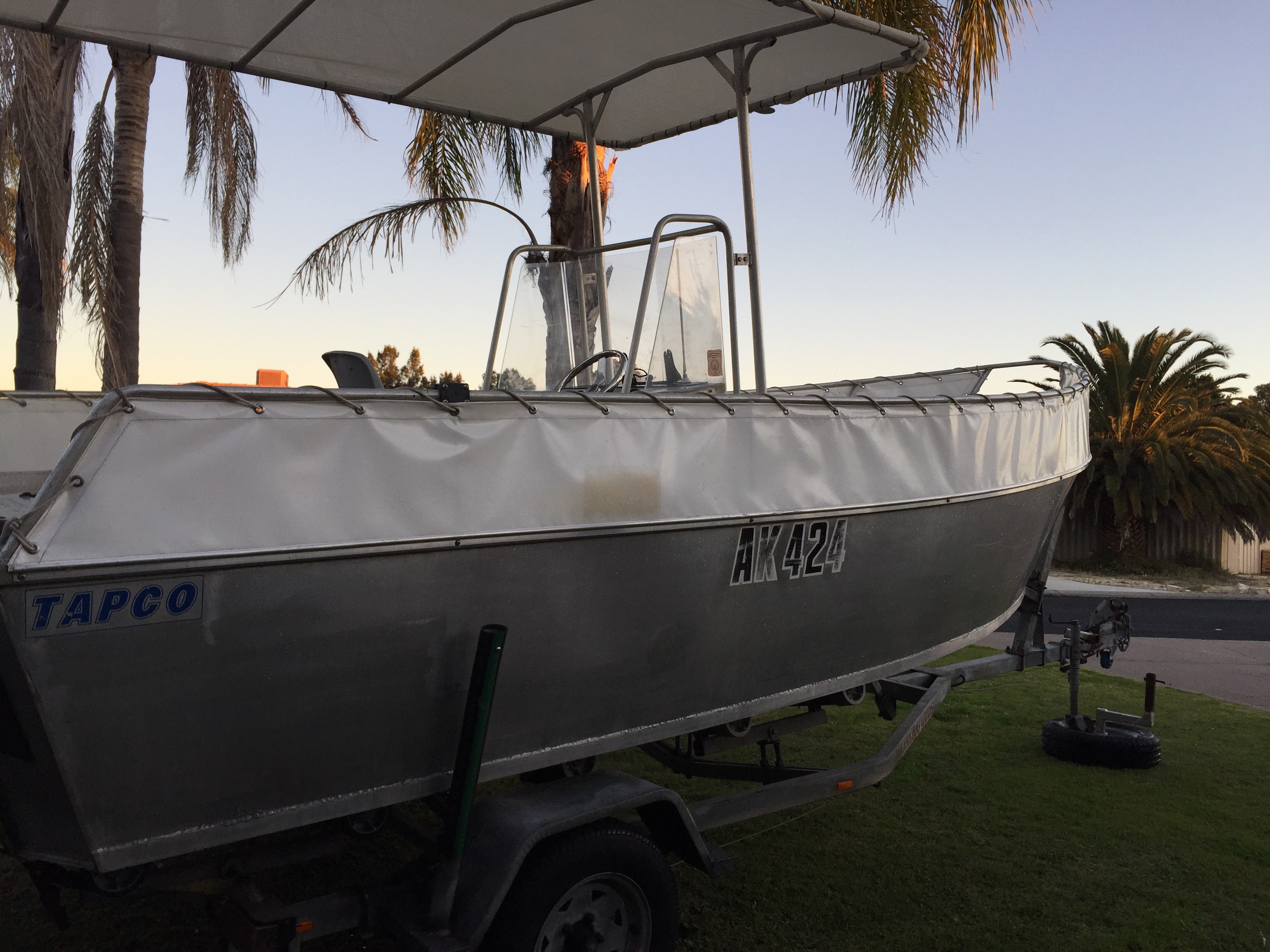

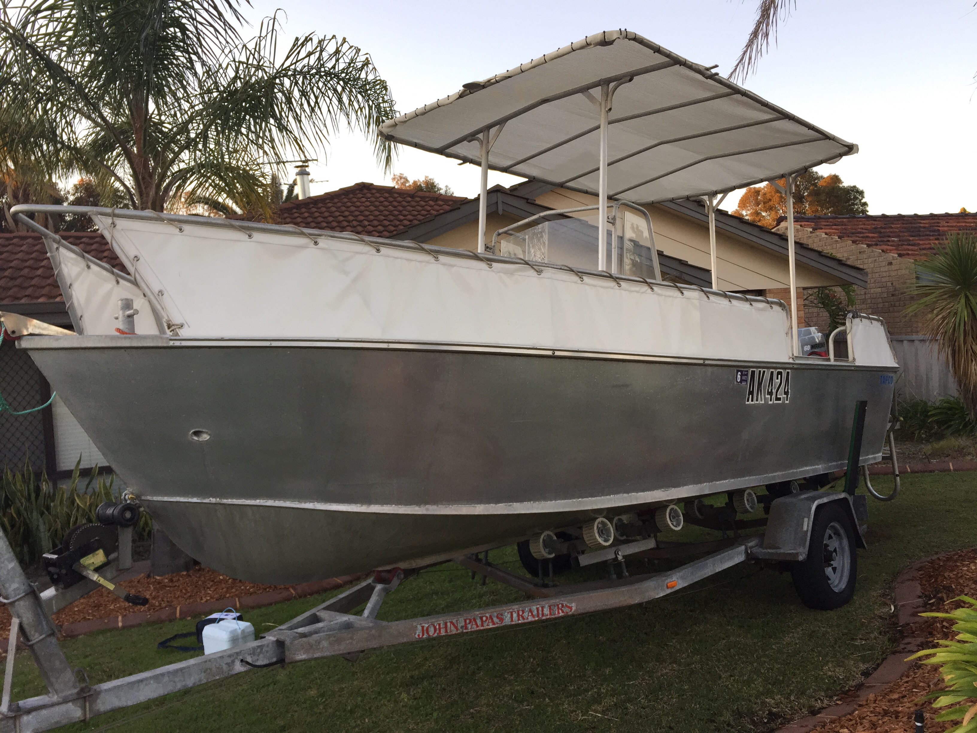

Recently I lashed out and bought a little 5.2m tinny with a 60hp Mariner 2-stroke on the back that was sitting on a John Papas trailer.
Whilst not a particularly nice looking rig, she's a tough old girl with the entire hull made of 5mm aluminum. I have been told that it was an ex sea rescue boat out of Geraldton. I can't confirm that but did find an old advert for it from years ago when it was fitted with a jet engine (since replaced with a little pod on the back). It has a self draining deck and a dual battery setup for the radios and HDS5x sounder.
The hull is a '99 model, the trailer is an '05 modelas is the Mariner. I can't find anything about the manufacturer of the hull but it does seem to be a custom build.

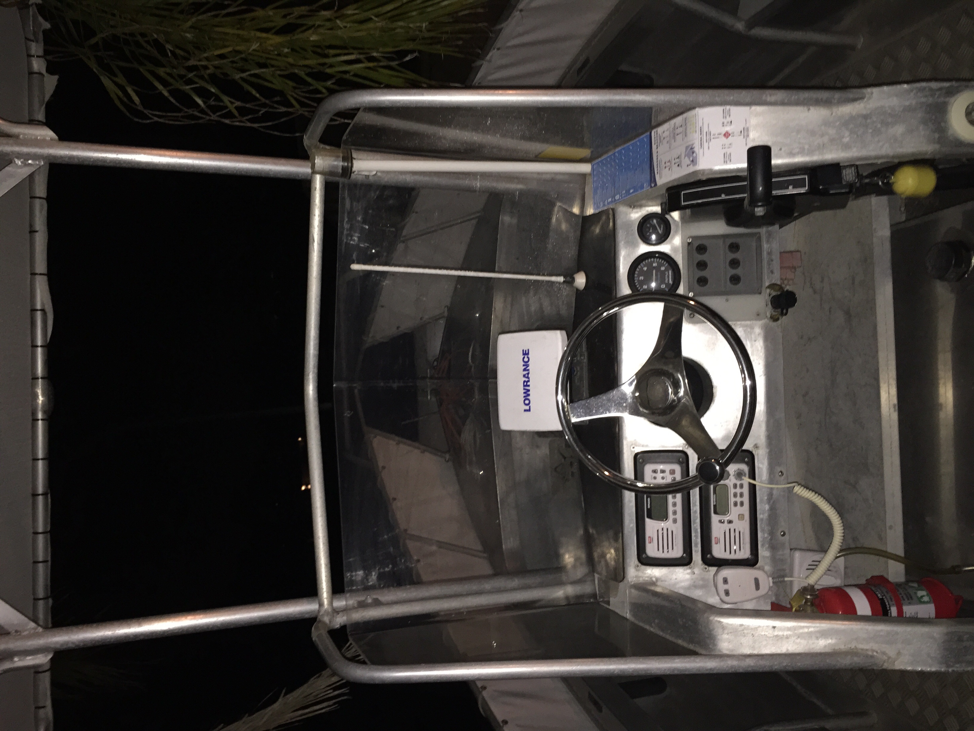

- installation of a new sounder
- inspect and repair the electrics and wiring

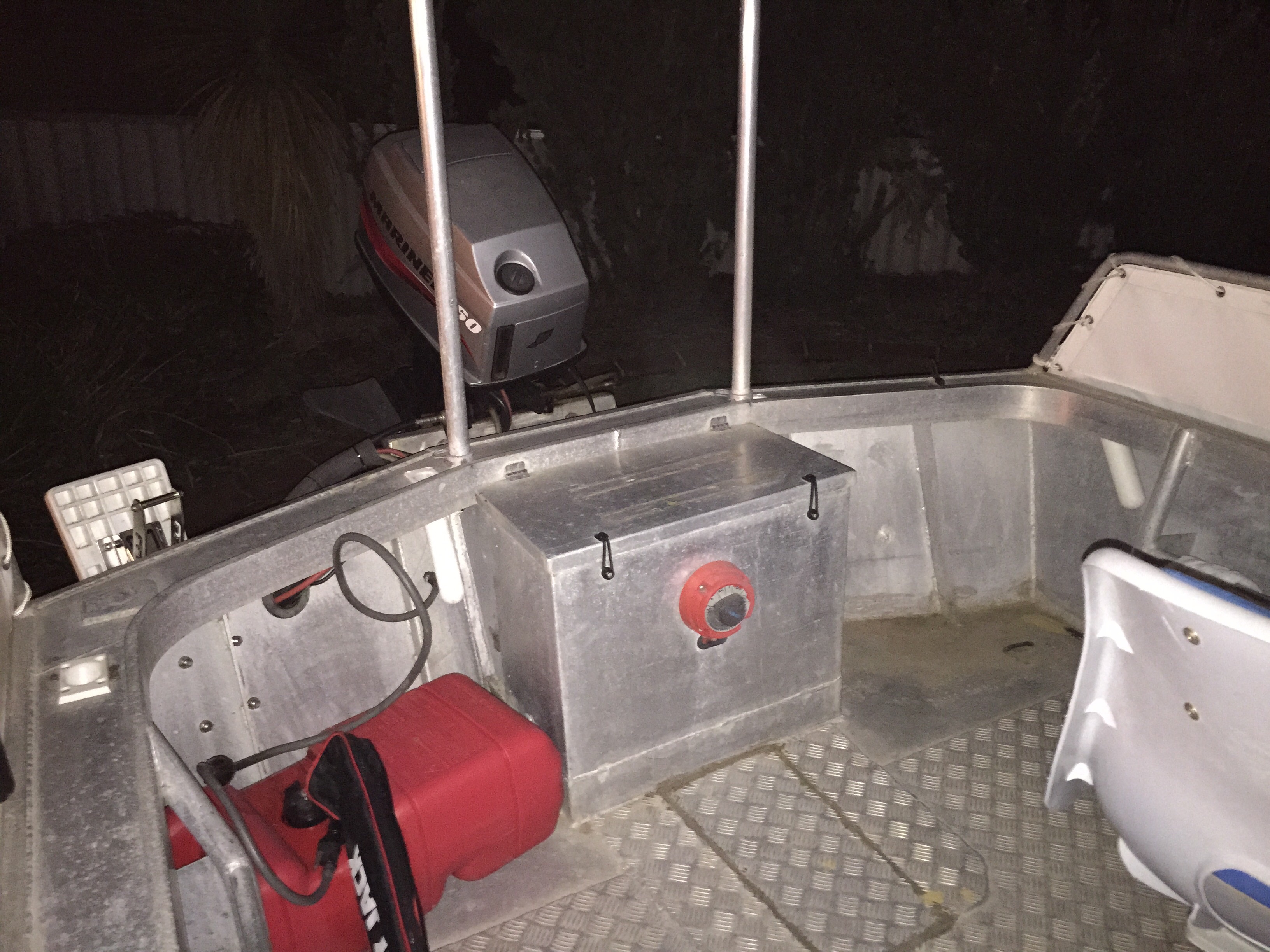

On the whole it appears to be in good shape. As always with older boats there's some quirks... It only has a 30odd litre fuel tank which is situated on (not under) the floor in the center console. The primer has been placed before the in line fuel filter 3 inches from the tank and a couple of meters before the engine. I might be wrong but I have always had the primer just before the engine, after the filter/water separator?

 Tasco = tapco? They were
Fri, 2015-06-26 16:04
 Tasco = tapco? They were making similar rigs up that way around that vintage, maybe a little earlier.
Posts: 12
Date Joined: 24/06/15
Tapco - not Tasco
Fri, 2015-06-26 20:40
Thanks Dodgy, you are right. It should have read Tapco.

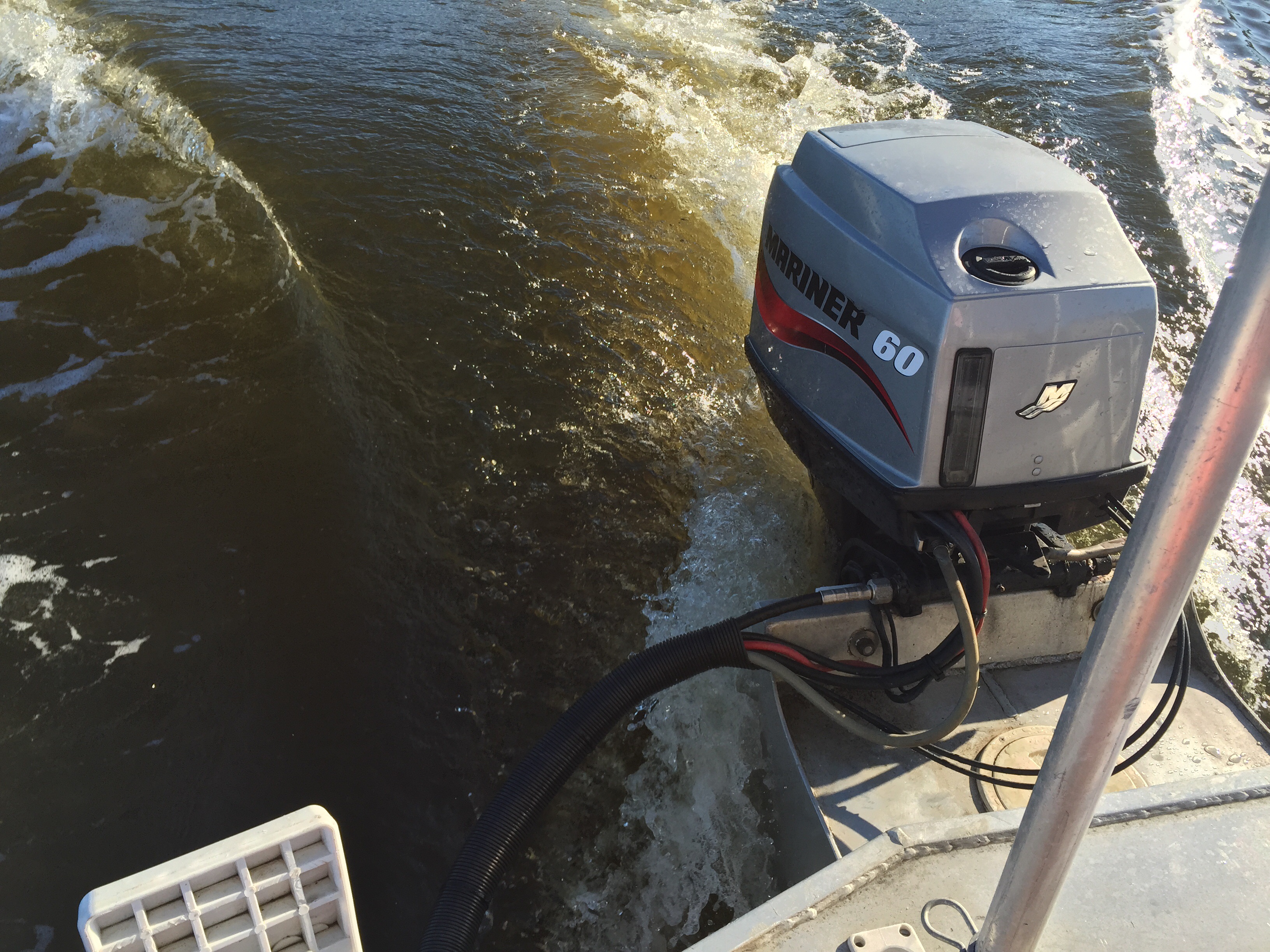

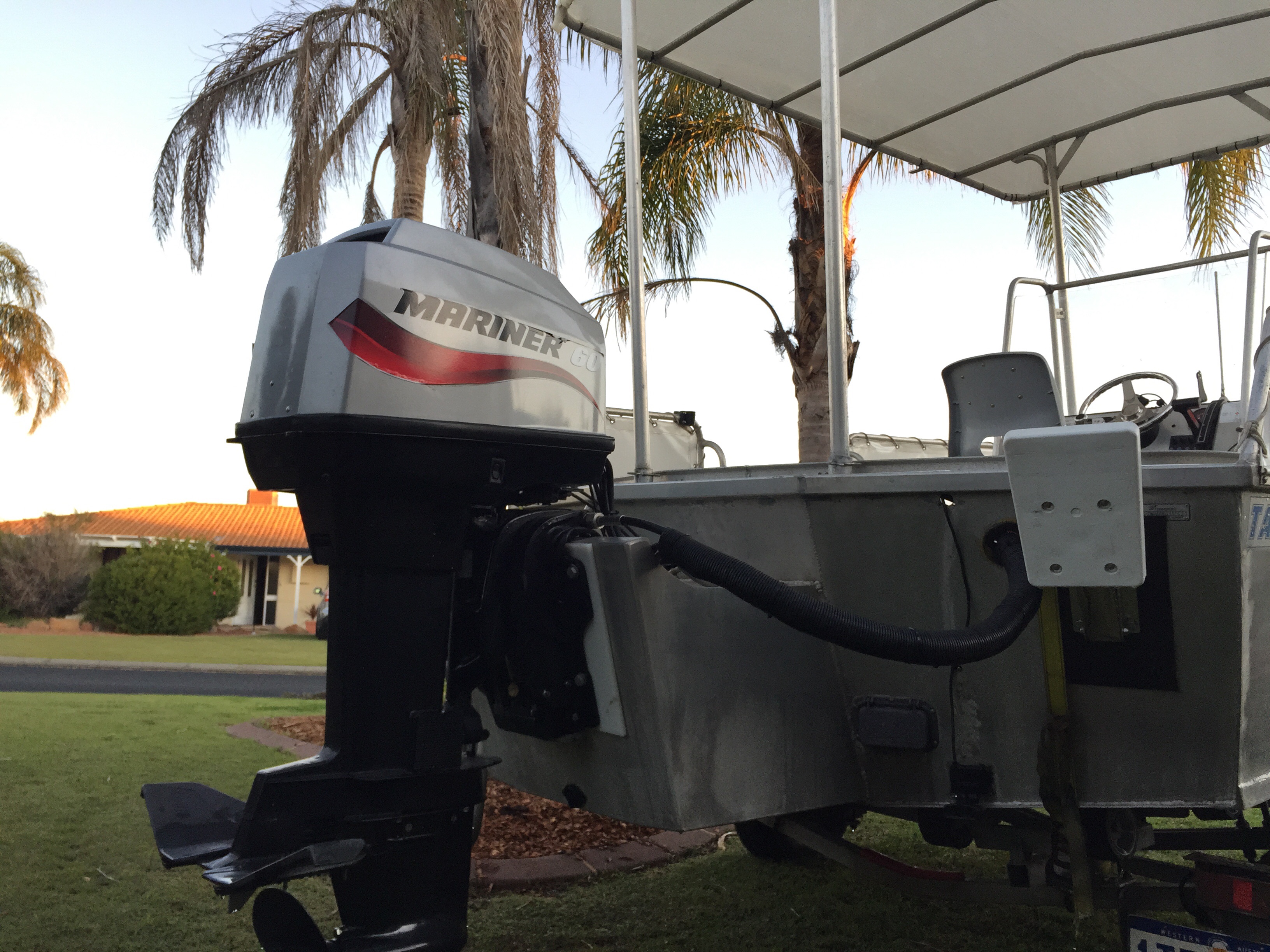

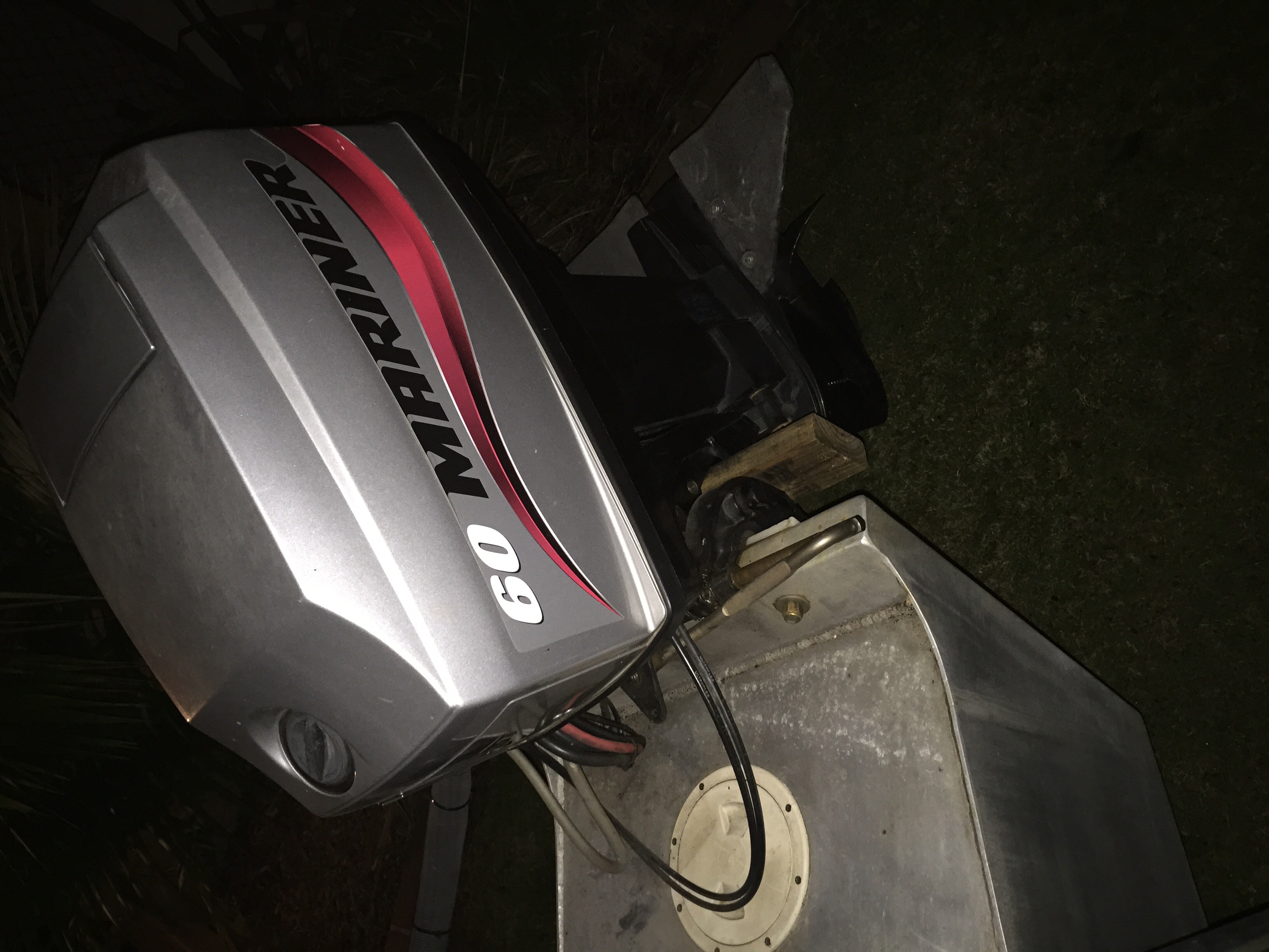

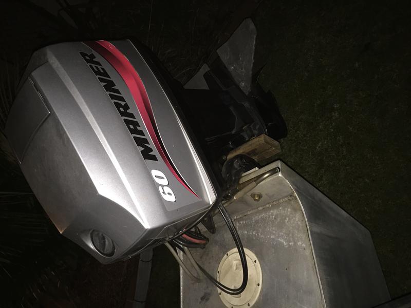

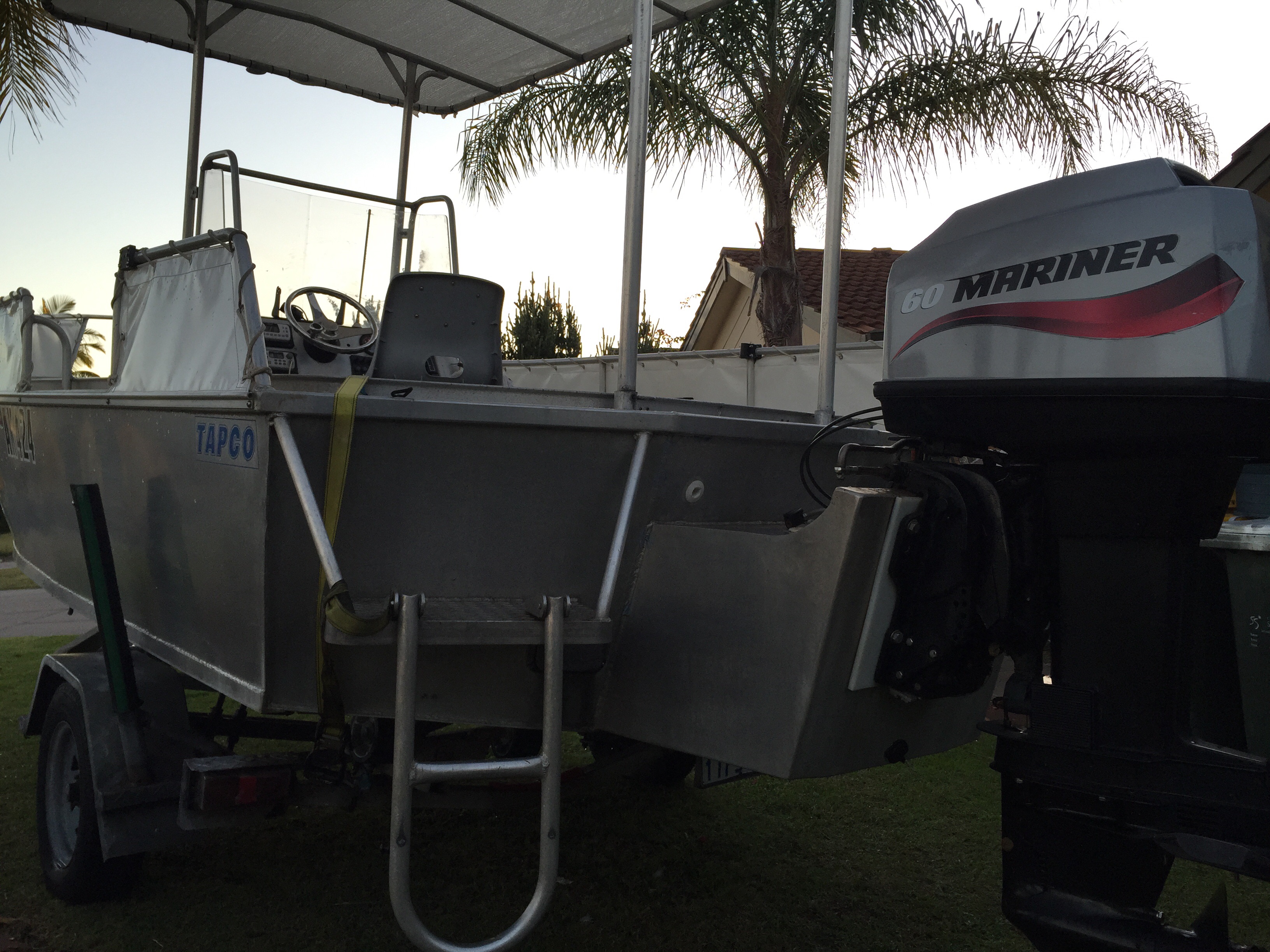

After tidying up a few of the electrics I took a quick trip down the river for a test run.
The motor ran really well however there are a few issues:
  • The motor sits very low in the water. Around 17knots the back of the motor was less than 2 inches above the water
  • around 25knots on calm water it felt like it was riding through small waves (bunny hopping - for lack of a better word) even though there weren't any waves...
  • the original transducer location doesn't work and water is sprayed all over the side of the motor as soon as you go above 15knots
The transom is 20inches tall, whilst the 60hp is short on berries for the weight of the hull I think there is definitely a problem other than the lack of power.
I took a couple of photos (the latter ones in the original post) to try and show what is happening. I haven't got a problem moving the transducer but the other issues are new to me. Does anyone have any thoughts?

 Hi BenI would think your
Tue, 2015-06-30 10:26
 Hi Ben
I would think your bunny hopping would be refered to pourposing, this is usally referred to boats that have outboard pods and poor LCG longatudial centre of gravity this comes down to weight displacement where the batteries are placed fuel tank position this can be worked out by moving weight around the boat. I noticed you have a Hydrfoil which would help the boat plane you could also look at raising the engine up 1 hole to see if this changes your running altitude from there you look at prop sizes i imagine this should be the correct size, does the engine reach full RPM? few veriables to look at just small changes at a time until you sort it out.

 Looking at the pics your
Tue, 2015-06-30 18:15
 Looking at the pics your motors mounted at the lowest position it can go. I would raise it as high as it goes. Probably help with the porposing issue.

also look at running a
Wed, 2015-07-01 21:06
also look at running a longitudenal fuel tank to help combat jet motor weight if void is still there it would be easy people are correct it is a weight issue  removing the motor has done this for piece of mind take boat out again and place two or three big water tanks where jet unit used to sit and watch the difference
