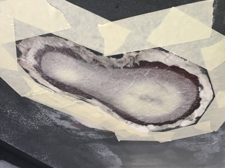

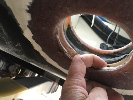

With a few dirty great big holes in the hull, out with the grinder and fibreglass. Ended up routing out inside the hull to create an hourglass effect as well as fully feathering the inside and outside.
Then filled the holes building up layers of chopped glass matt, glass matt weave and glass dust reinforced epoxy to fill the hole. Well over 15 layers of layup and this is a repair that will never fail! First time I have used fibreglass, a bit daunting to start and apart from a bit of an overheat when I did a layup too thick, it is pretty easy and quite rewarding.

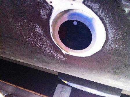

Then onto the new transducer. Almost everyone who I spoke to here and overseas said the transducer with performance fairing is way too big for a 23 ft boat and would adversely affect the boats handling etc......I wanted the best transducer performance....period.....so I ignored the lot of em. When this beast arrived, I almost fainted. This thing is huge!
Measured about 50 times, made up dummy foam copies and finally cut the fairing on my mates band saw.
Installed along with the 2 other thru hulls in my arsenal......a total of 3.7 kW of transducer power covering High/Lo CHIPR, sidescan, downview, medium chirp and hi/low tone burst with all 3 transducers able to be electronically switched via the head units to display any combination. Happy to report no noticeable effect on the boats performance despite this beast hanging down well below the Whalers keel.

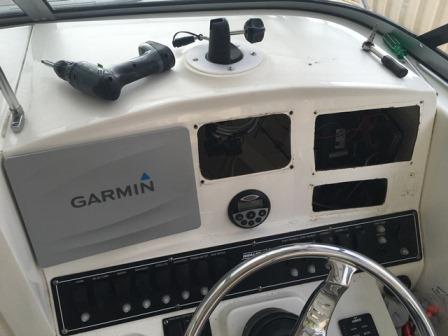

Onto the head units.....time to make space for a second 10 inch screen. Had to move the radio to the overhead hardtop to make enough room.
Had to do a lot of cutting, shutting and more fibreglassing of the dash to get these bad boys to fit....just.

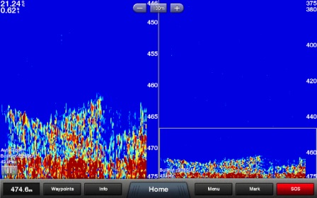

First trial was straight out for a deep drop. Performance was better than I had hoped.

Does OK at 25 knots in deep
Sun, 2016-05-22 14:31
Does OK at 25 knots in deep water
And shows bait pretty well

Not really. My old 585 with standard transom mount 600w p66 did that everyday of the week (the upto 150m stuff).
John has done a great job here and spent a heap of time and effort to get it right (which many dont) and has the results he deserves.
I think the new garmins are really starting to produce and Navico - Simrad and Lowrance dont seem to be keeping up these days.
Its great to finally see some really clear shots in the 500m zone from a chirp sounder

AWESOME PHOTOS you can read
Sun, 2016-05-22 16:22
AWESOME PHOTOS
you can read the bottom of 150 m at 25 knots !! that is what I dream of !
was it hard to tune it ? ie adjusting gain etc...

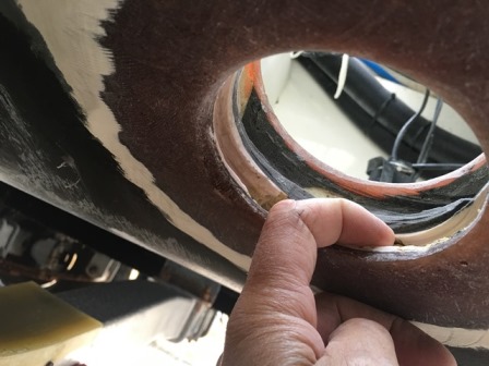

and I have only ever had transom mounted units, but how do you seal a beast like that through hull. I would be Sooo worried about holes in the hull, and that unit would make a huge hole.
Build a couple of hulls/boats from scratch with glass, and apart from being catalyst "fumed" loved it (might have even liked the fumed bit but was as high as a kite and cant remember. I was called chameleon afterwards,as apparently my eyes looked in different directions )but I would still be concerned regarding any holes in a glass hull
PS: Was rude. Meant to say fantastic job and great post
z00m's picture
Posts: 1086
Date Joined: 10/05/14
Holes
Mon, 2016-05-23 10:56
Looking at the work John did, he now has a smaller hole in the hull than what was there before. At least now if, god forbid, the transducer 'fell out' then John could plug the hole with a simple rubber bung in an emergency. The blue part is outside the hull, not through it.
