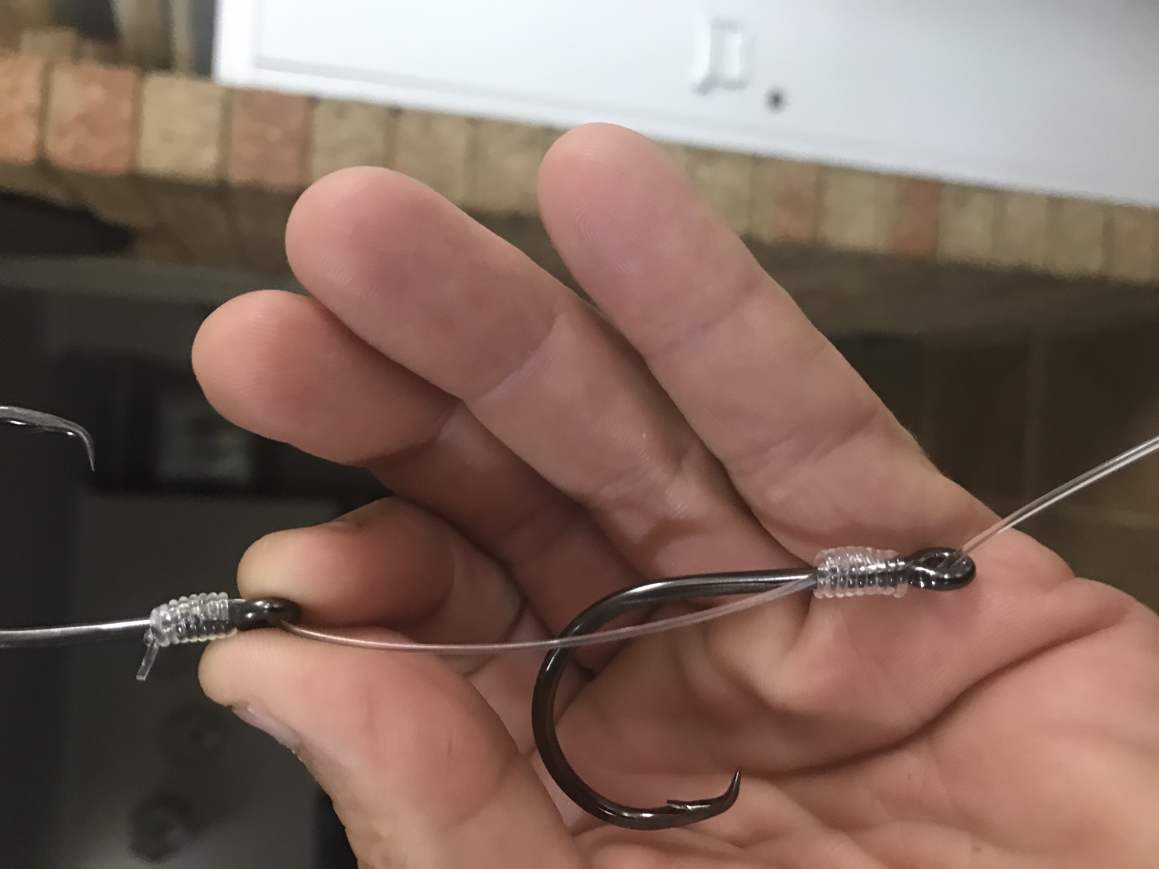

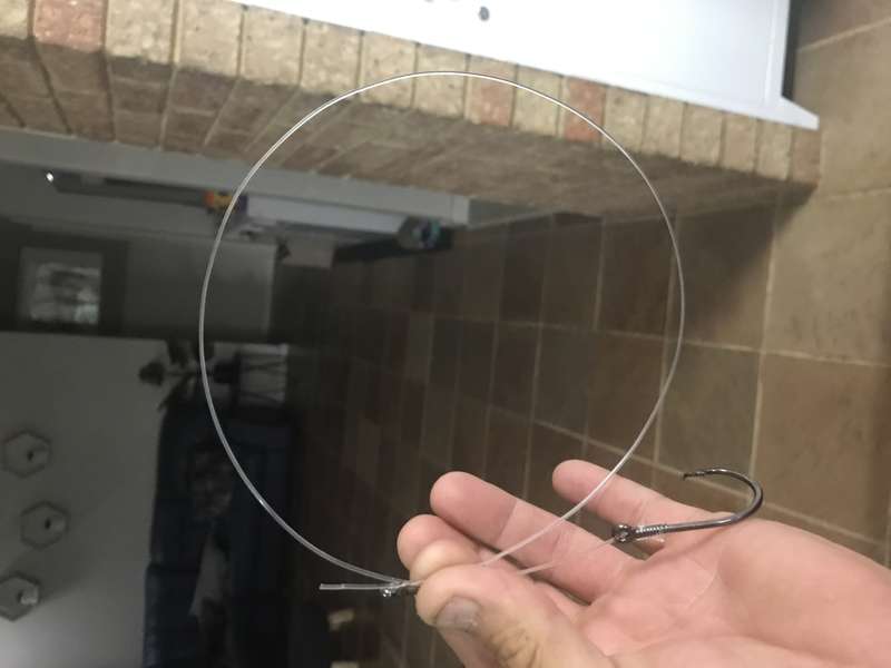

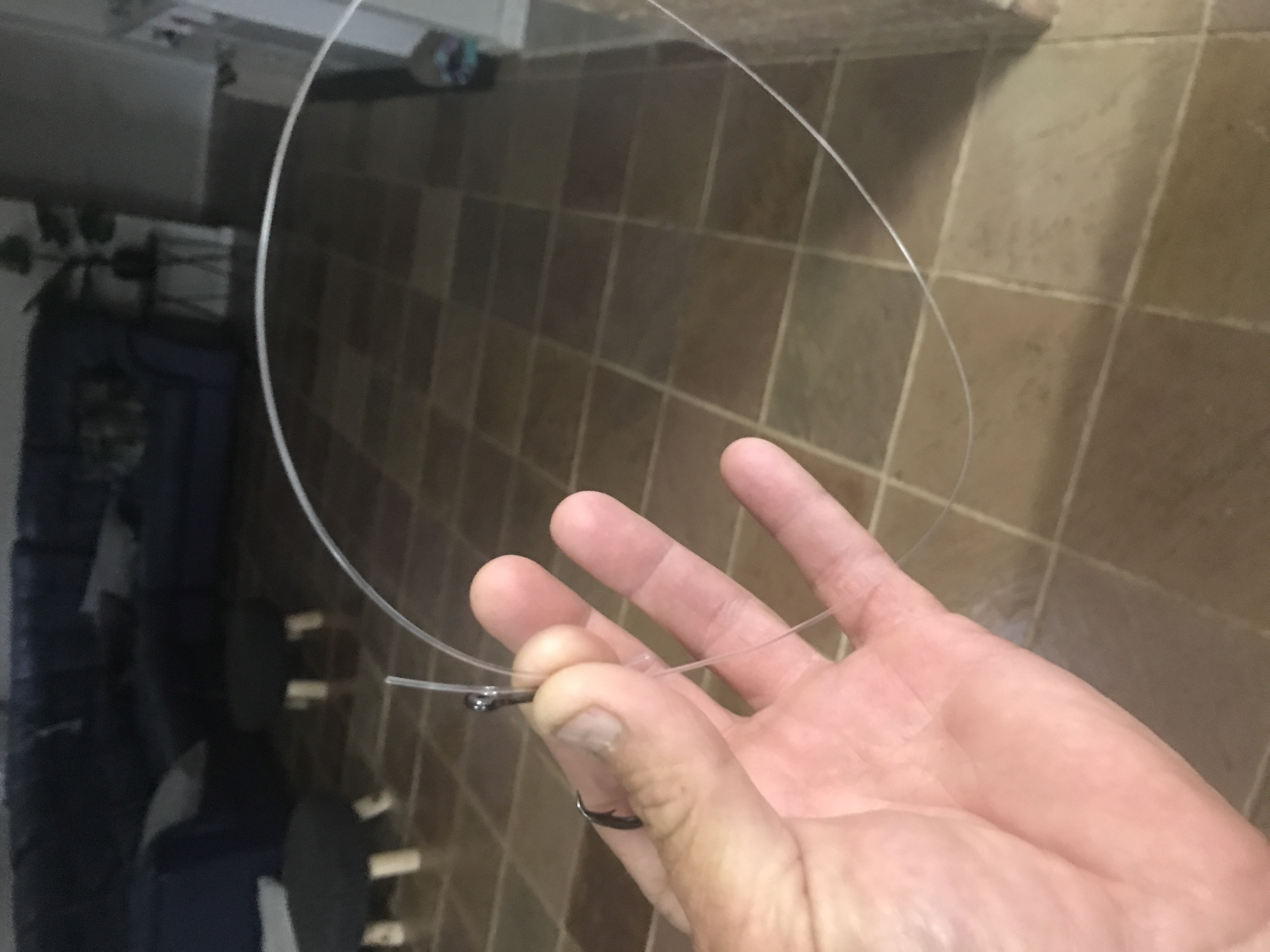

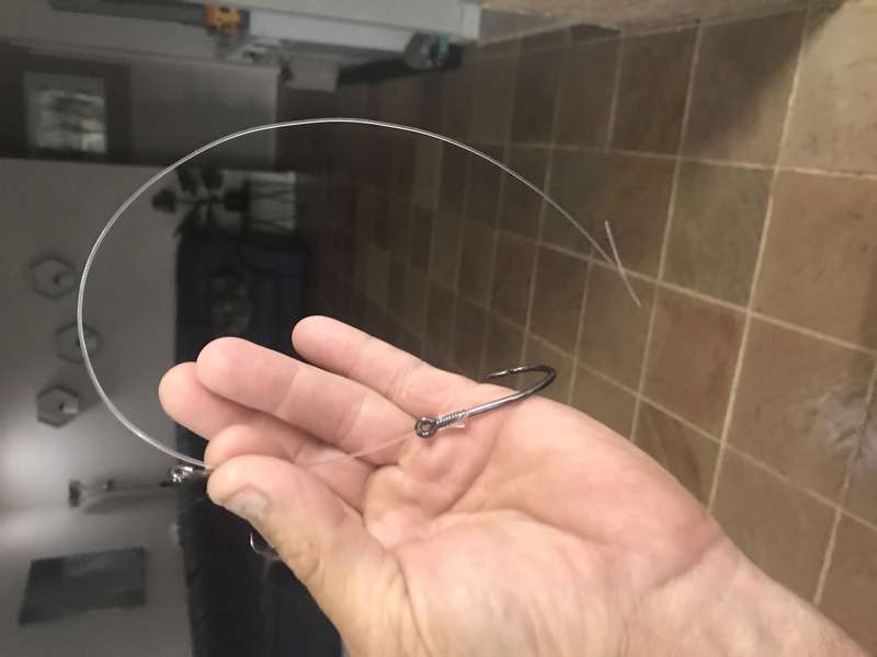

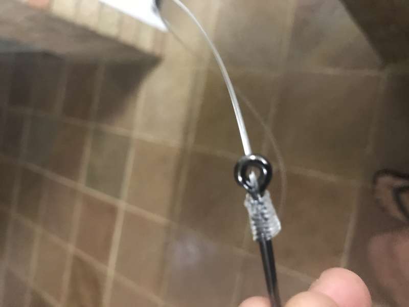

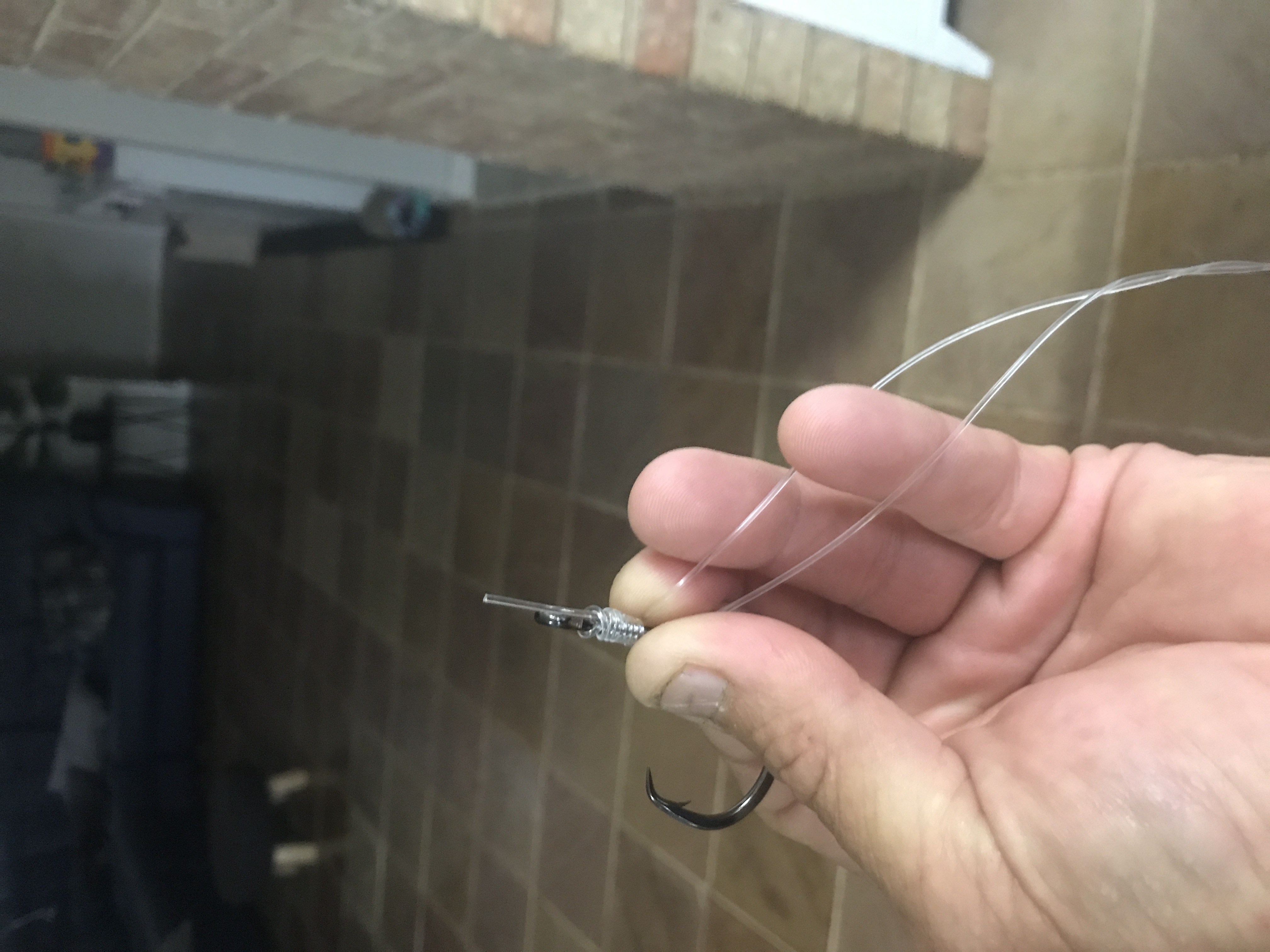

Nebbian1 ( snell try this)
Have tag just above first hook. Grab other end of leader make a circle going from back of hook facing down. Grab top of your leader ( circle you made)wind down on shank of hook. Bit off spit pull tight.2 nd hook put in place where you want it. Grab end of tag make circle facing tag end downwards. Again get top of circle( leader) again wind down shank and pull tight. This is strongest I have found . Never comes undone. Line tightening on line. Your way has tag looping over . They tend to give way. Snell in picture can have cuts on loops and still hold

Pulled tight. Won't give way. Good luck
Posts: 2700
Nice neat knot
Fri, 2018-03-23 13:06
Exactly as it should be !
