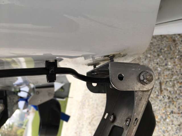

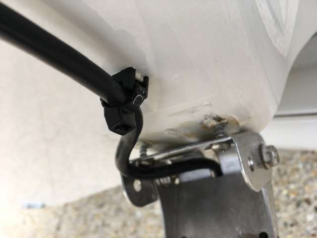

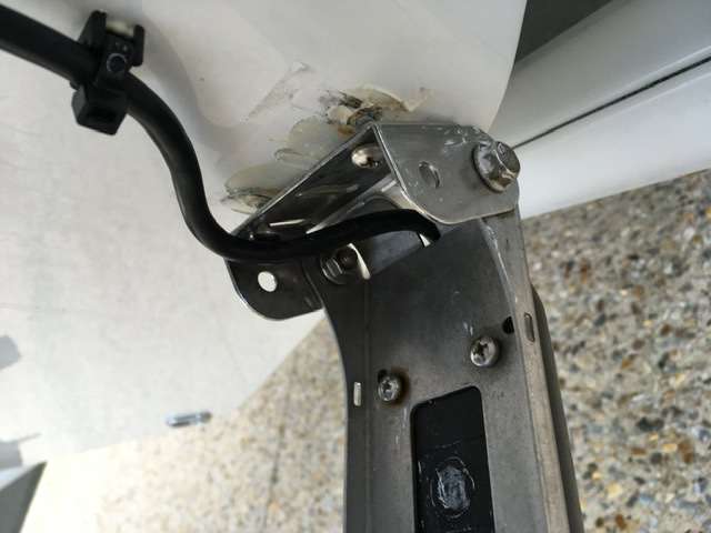

Hey guys. after, coming home fomr a run out deep  i noticed my transducer bracket had come loose. it looks like the scres have pulle dout a bit. unsure if maybe i hit something while under way. was thinking of fixing it muyself as quite a long way to get it booked in anywhere.
I was thinkng my options are either;
screw in tight, and apply sikaflex aorund the screwheads to help seal. only concern is given they are self tapping screws that the thread hold may have bene effected?
2: pull screws out completely, aplly araldite to screws, then screw back in with sikaflex aorund the screw heads.
any suggestionos as to preffered methods, or other options? other materials to use?
cheers!
goat.

 By the looks of it the gel coat that's been peeled off I'd say someone's already done the sikaflex trick. Remove it completely backfill the holes with some epoxy if you can, redrill the holes and remount your transducer. A little smear of 291 won't go astray either.

 Hey guys.just an update.when
Sat, 2021-05-15 08:12
 Hey guys.
just an update.
when we got to working on the boat it was kind of weird...
both screws were out equal amounts, but solid as a rock.
there was no damage to the gelcoat or surrounding fibreglass or the transducer.
the marks on the pictures where just the old sikaflex that was still stuck on.
ended up putting a bit of the marine araldyte on the screws and cscrewing them back in and sealing with sikaflex as seemed solid as a rock. if it loosens again i will try the epifill, or bigger screws as the next step.
really got me wondering how this happened. given the location adn with the extended swim platform i cannot see any was htis could have been hit, and if it was ripped out surely there would be more damage surrounding?
given its parked in the driveway, i am actually wondering whether someone may have had a fiddle with it. all the cars in the street were broken into a little while ago, so the thought crossed my mind. bit strange.
Anyway, thanks for all the suggestions. i have all the materials available now, and should this repair not work i now have some good ideas on what to do next!.
thank you greatly for all the input!!
cheers
Goat.
