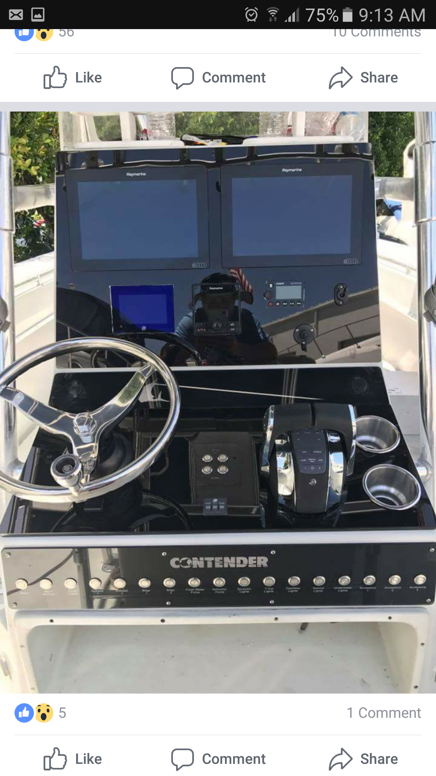

Making way for the new simrads perspex or poly carb to cover existing holes
Picture is not of my console but wont the finish has anybody got any recommendations on what material to use. Poly carb, perspex ,hdpe boat lives in the pilbara so it is exposed to the sun.
