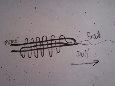

Double and single uni's i love.  But this works well.  Double over the mono leader and pass the braid through the loop.  wrap braid around both legs of the leader about a dozen times, then pass back through the loop, pulkl tight.  Sorry about the bad picture!
