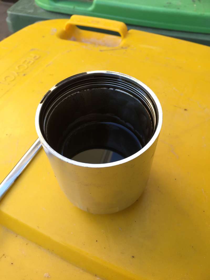

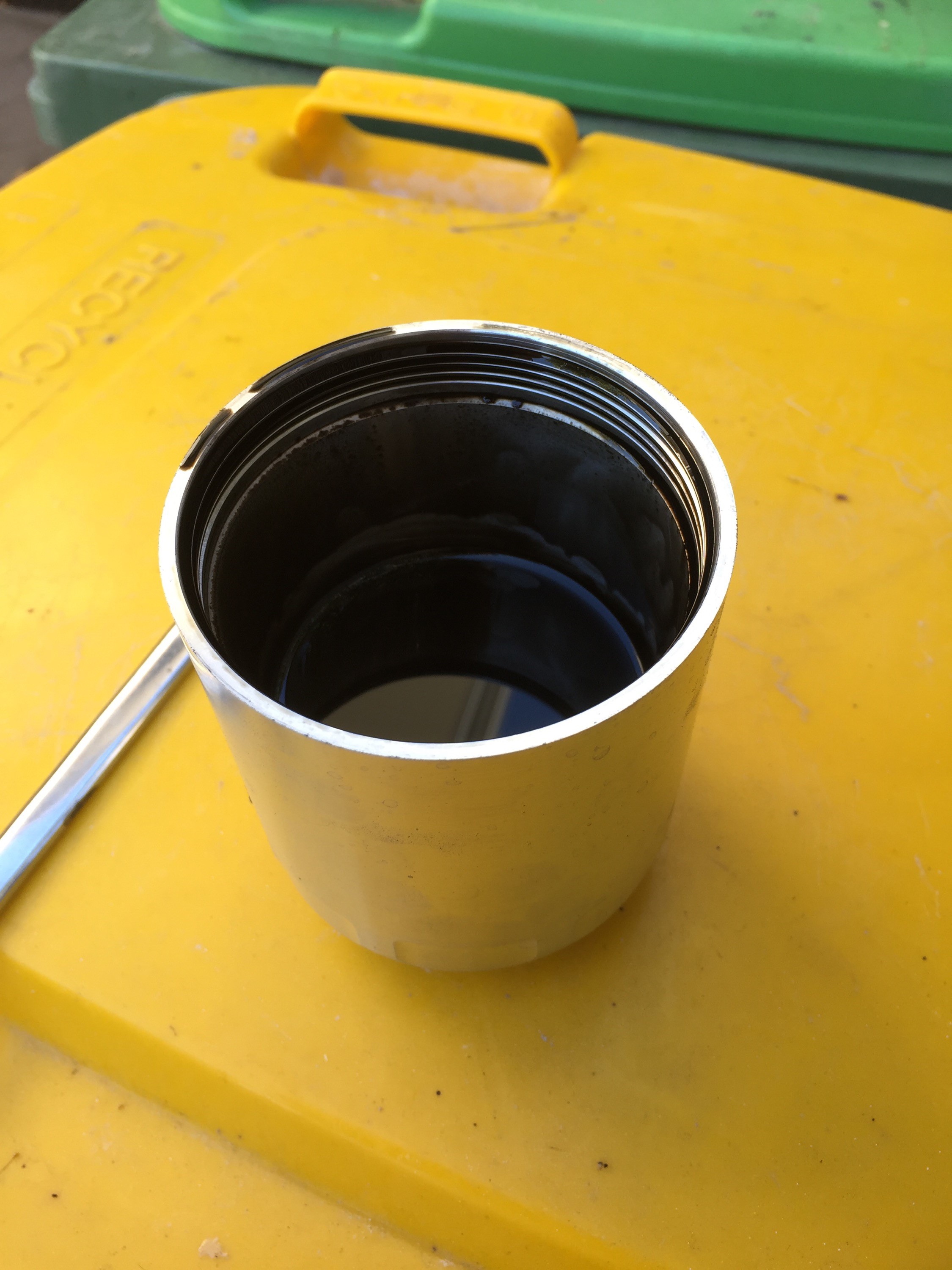

landcruiser 200 catch can after 20,000km
Thought this might be of interest to other 200s owners
I bought a new 200s late last year - my last 200 didn't have a catch can on and I wasn't going to bother putting one on the new one but the dealer actually suggested it wouldn't be a bad idea - I bought a HPD catch can as I liked the idea of the dipstick (meaning you don't have to pull the whole unit it out to check if its got oil in it)

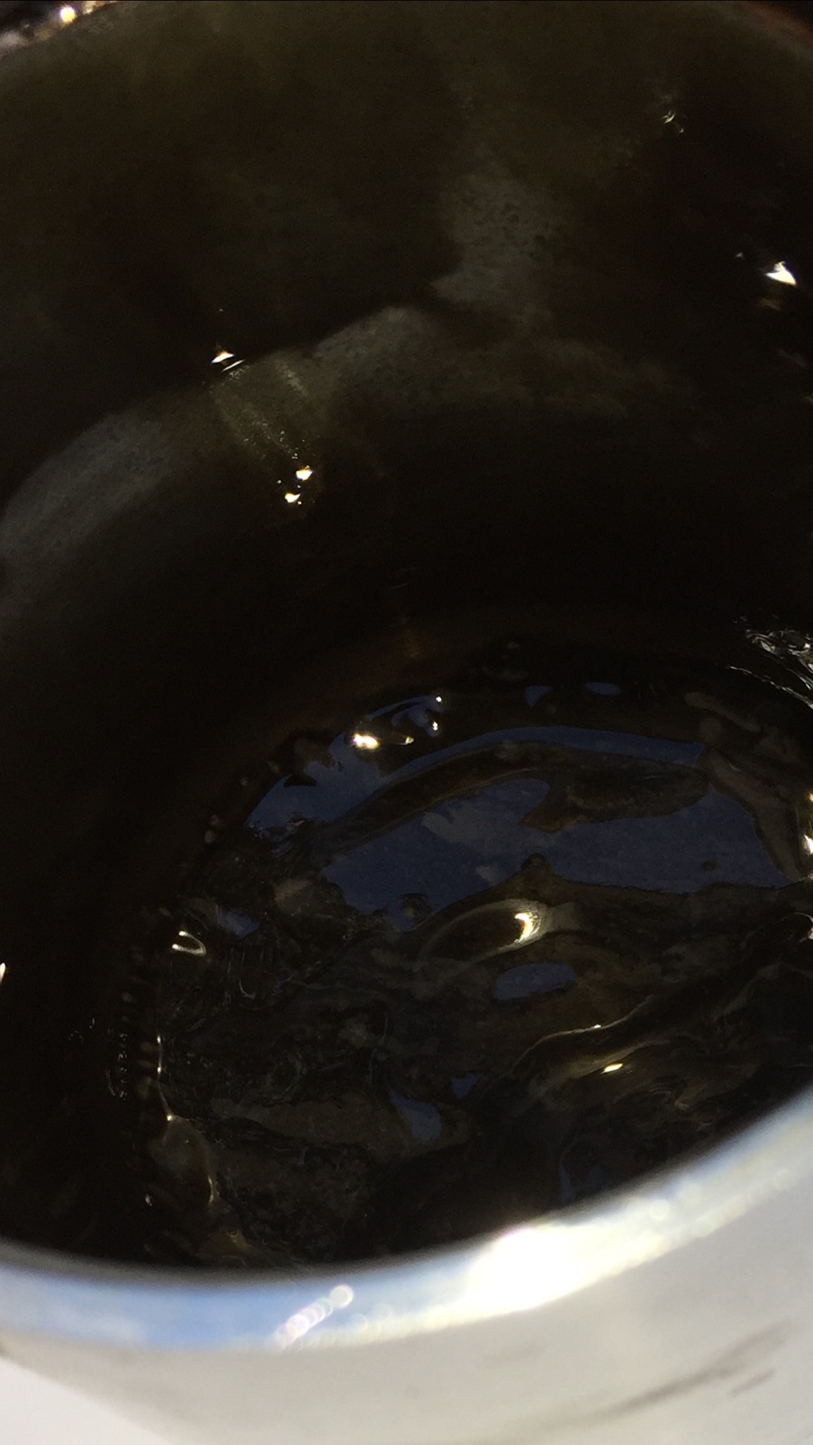

At 10,000 km there was nothing showing on the dipstick (although it does not go right to the bottom of the can), car is about to go in for its 20,000 service and this is what was in the can - more so, of interest there was a fair bit of sludge at the bottom that clearly had moisture in it - must be from short trips but good to see that non of that is going through the turbos

That has collected about the
Mon, 2019-03-18 12:25
That has collected about the same amount of oil as mine did after installing HPD catch can for 20,000kms.

the first 10,000 it didn't
Mon, 2019-03-18 13:10
the first 10,000 it didn't seem to have any in it (although as said, the dipstick on catch can does not reach the bottom so it might have) the car did use a bit of oil however on the (engine) dipstick. From 10k to 20 it has not used any oil at all.
It does do short run city driving Monday to Friday but it goes Perth to Dunsborough every 4 weeks and a couple of Exmouth/Karratha trips a year - THe car has a DFP gauge and i do notice that the dunsb trips clear that out

 Well your saving yourself
Mon, 2019-03-18 17:27
 Well your saving yourself some pain down the track by not having that shit go through your manifold. Unbelievable how much carbon builds up in the manifold over time, Good investment.
Keep any eye out for soot buildup in your exhaust, seems afew are having dpf problems, not just hilux.

I think you will find
Tue, 2019-03-19 06:28
That the problem of “sludge” or black sticky stuff in the intake, is all EGR related (exhaust has recirculating valve)
The ultimate is to have the egr deleted, with a catch can also fitted to trap the oil vapour. Oil vapour also means uncontrolled burn, running on of engines, potentially detonation in the cylinders (pinging) etc etc. in summary, 200 series are hard to cure the black sludge in the intake pipes (like all common rail diesels) but it can be done with a bit of homework.

200-300ml per 10,000
Tue, 2019-03-19 10:46
I have the DPF model 200 and get between 200-300ml of oil in the catch can over a 10,000km period. I thought this was excessive after looking on LCOOL its pretty normal and not excessive at all.
at 5,000kms I deleted the EGR, DPF and installed a catch can. Its now done close to 50,000 and I opened up the intake to have a look and it was reasonably clean. I know there is no way it would be that clean if I hadn't done the mods.
