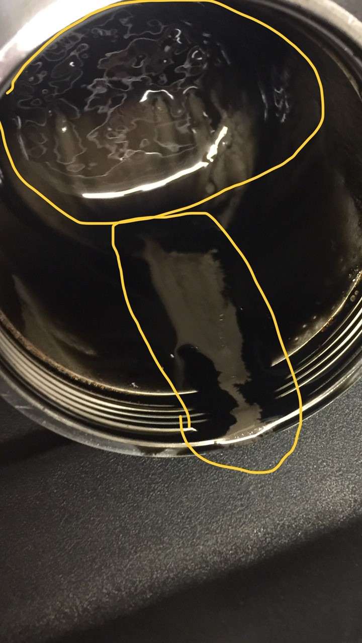

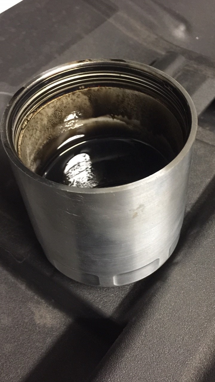

I posted a similar thread a few months back at 20,000 on my LC200, i fitted a HPD catch can at 10,000km and was surprised at how much oil had accumulated over the 10k period and in particular that it had water in it.
I just hit 30,000km and ahead of its service gave the can a clean out - more oil than last time and more water contaminated oil - second pic highlights this - it looks like reflection but that is just water based sludge, and its a lot thicker than it looks in the pic - anyone else experiencing this? i assume it is formed as a result of short trips?

 why did you draw a willy on your oil sludge picture?

haha - i missed that - if i
Fri, 2019-09-20 13:46
haha - i missed that - if i had my time again i could make it better!

 My hpd catch can collected
Fri, 2019-09-20 13:28
 My hpd catch can collected about half a can in its first 25000kms then since then bugger all. but all oil no water contaminents.

hmm - on one hand i am glad
Fri, 2019-09-20 13:47
hmm - on one hand i am glad it is catching it - ie better than all that cr@p going through the turbos but on the other wouldnt mind knowing if that is normal......

Bit of info
Fri, 2019-09-20 17:07
Bit of info here
hpdiesel.com.au/catch-can-faq.html

As far as ive read thats
Mon, 2019-09-30 10:16
As far as ive read thats normal with stop start trips, im running a provent catch can and get about a 100ml per 5000km in my 4.5 V8 cruiser. 2012 model but dont really see the water in there do plenty of stop start around town too.......coming up to my 5000 service so will double check for water.
