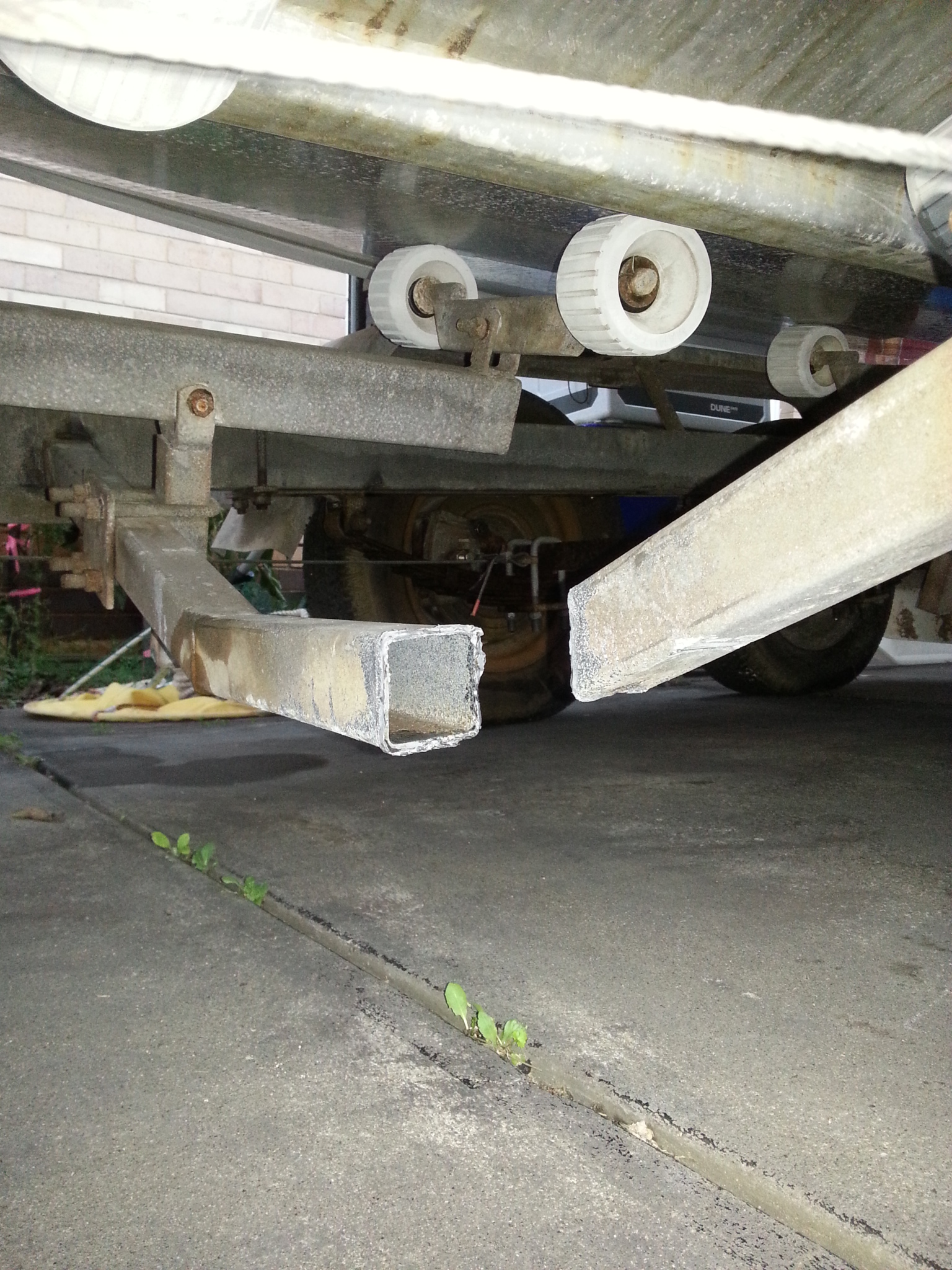

I recently used the above ramp and found that it was damaged as it was missing about 6 concrete blocks in the middle at the back of the ramp.
Has anyone else used the ramp and found it to be in this condition and if so did you happen to advise the Mosman Park council or has it been this way for ages.
Does anyone know if there are plans to repair it as it wasn't that much fun getting a 6.4m boat & trailer back out even with a 4WD.
Note the drop off in the section missing the blocks was about 15cm but if someone has driven onto trailer recently this could easily blow out to 25 or 30cm which may be enough to bottom out your trailer frame or axle/s and duplicate the result below.

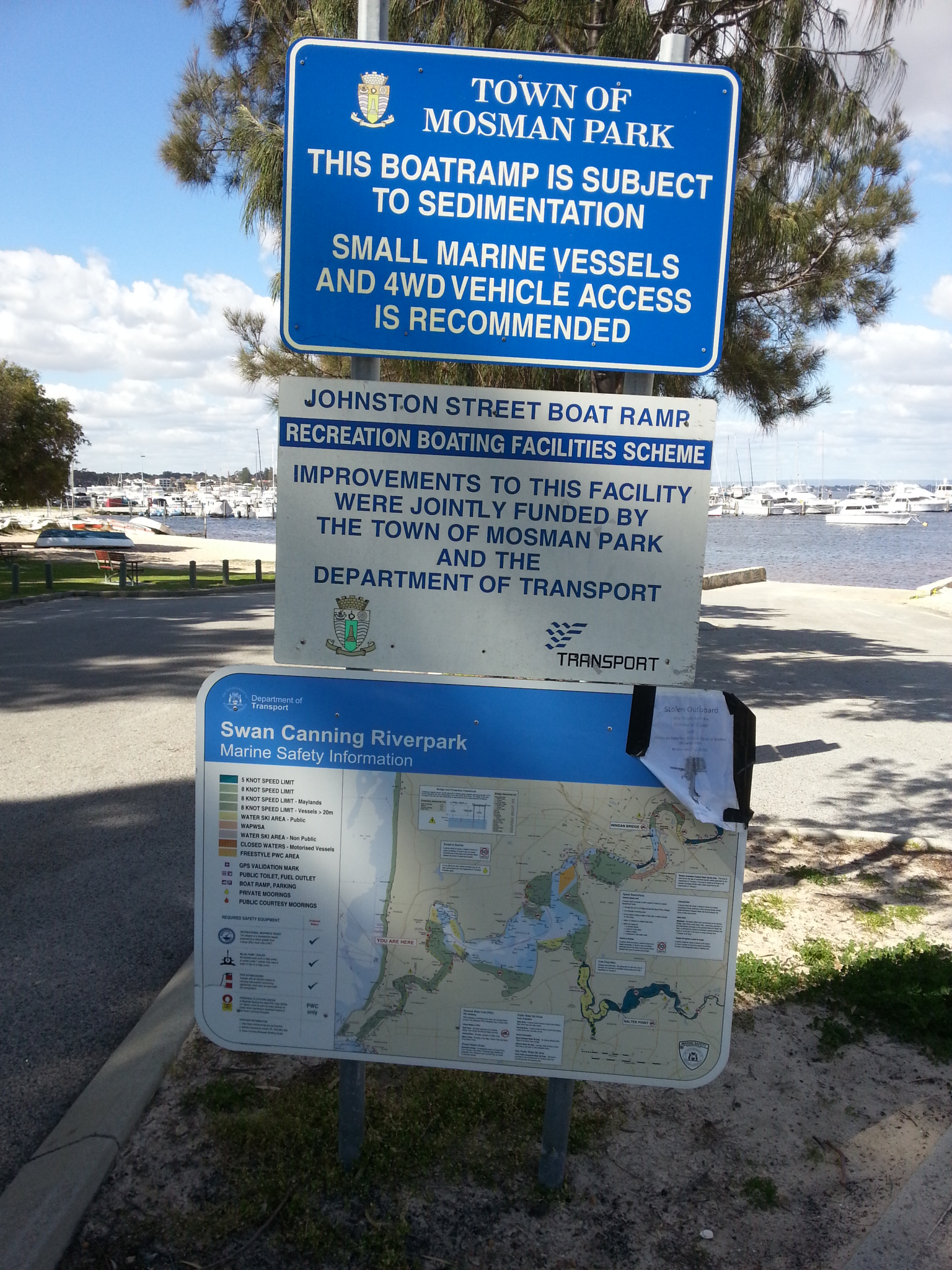

You may find, as the sign says that your boat is a little big for that ramp.

What is a small vessel
Thu, 2016-09-22 15:16
It is only a plate ali boat and when compared to the ones in the background at Freshwater Bay YC it is small.
How does one determine small?

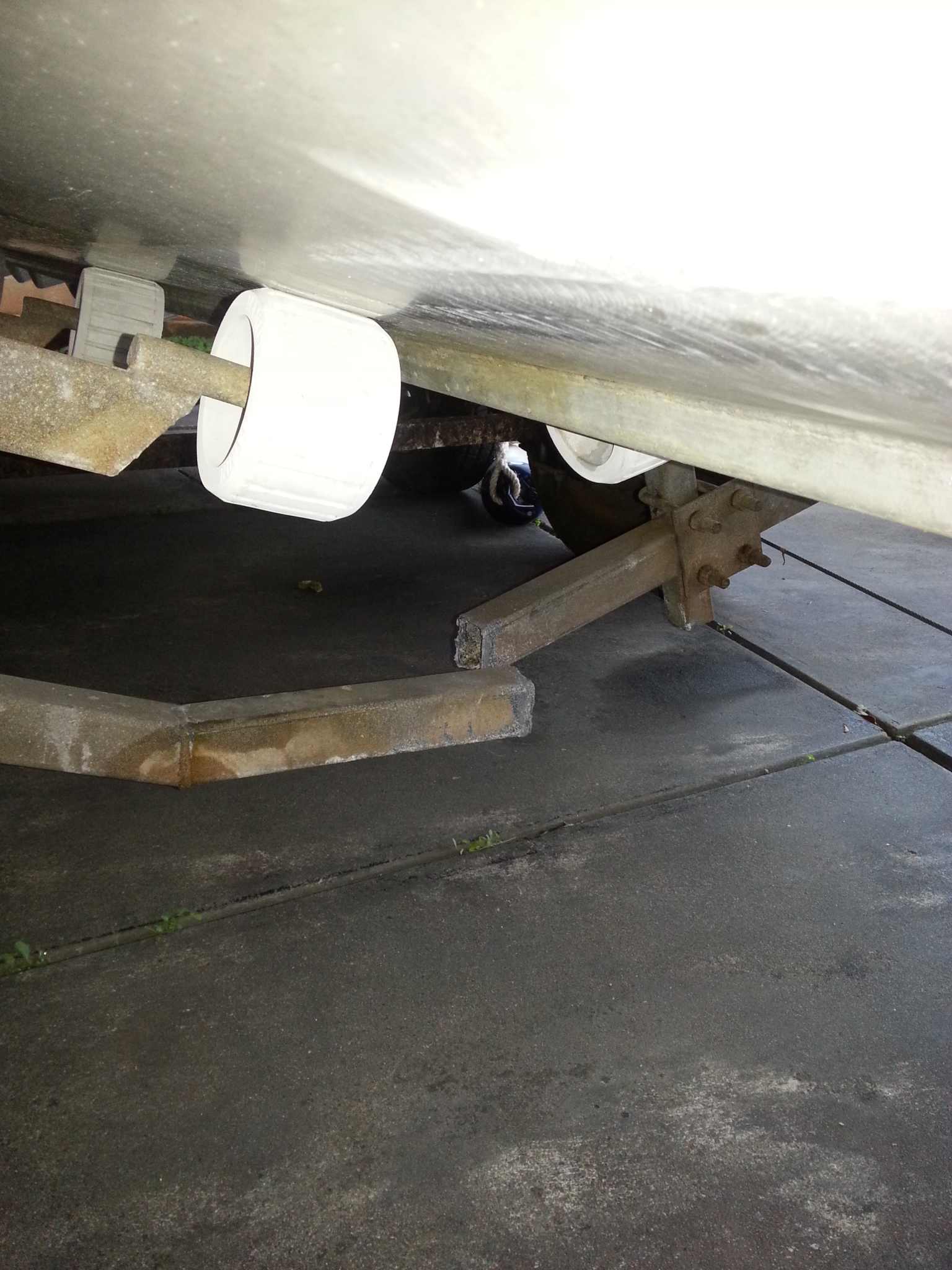

I have added some new photos of ramp and what happened to my trailer due to falling into the hole in the ramp.
Ouch!

 i dont think you can blame that little pot hole for your trailers undoing.....
Posts: 15129
 Yep I think your trailer was
Thu, 2016-10-06 19:02
 Yep I think your trailer was already cactus before that. Proably a good thing breaking there than somewhere remote. No penetration in those welds either so you were losing the race from the start. Not sure if they were an after market repair as most of those cross memebers are cold formed.

The trailer is in fantastic condition for its age as determined by my remote camera inspection of the trailer frame prior to me purchasing the vessel. The cross members were made that way back when this trailer was made by the manufacturer as all three are the same and the manufacturer has confirmed this was their manufacturing method. The cross members were mitred and then welded together. Today most manufacturers now cold form their cross members as confirmed by my trailers manufacturer. I can assure you it was the hole in the ramp as I heard it go bang the day it broke.

 Honestly mate, that ramp is not suitable for large trailer boats.

It was, until I used the ramp
Tue, 2016-11-01 21:03
The trailer was fine until I used the ramp. It got busted at the ramp due to the condition of the ramp.
Thanks for the offer.
There is no point just welding it and cold galvanising it as it will just rust out from the inside in a few short years due to the exposed steel.
Nobody gets out of life alive, so make the most of it.
Posts: 15129
 Yep, you don't have many
Tue, 2016-11-01 21:10
 Yep, you don't have many options apart from repairing with a new section and regalving the whole trailer if you want it to last.
