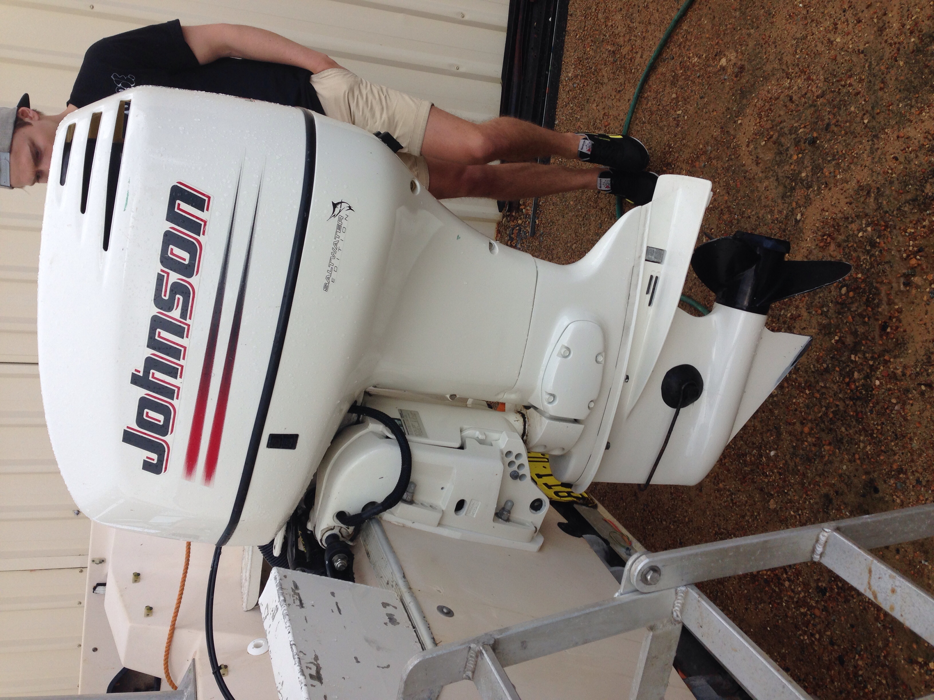

I've got a photo of it
Wed, 2014-05-14 20:23
I've got a photo of it because I don't thinks it's 2002. How do a post  photos on here?

The specs plate you can see
Thu, 2014-05-15 07:27
The specs plate you can see (just next to the loop of black hose) will have the year on it (may be coded but from memory these have the actual year).
The black hole on this side about half was down the mount is the hole for the manual release of the tilt/trim as per the post above (all motors should have this around this spot). If you look into the hole you'll see the screw inside - good to know where it is before heading out.
Thu, 2014-05-15 07:26
My first guess would be around 2005/6 model (at the latest but they could have done the same ones earlier)
Edit - just found one which appears to be a 2003 so possible they were building them in 2002 and up until 2006
