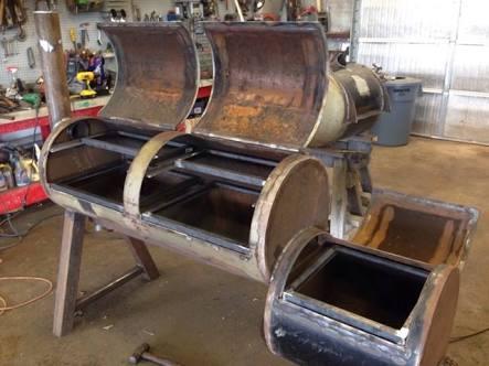

 Im thinking about building an offset smoker for the patio was thinking pizza oven originally but a big meat cooker would probably be more suited. we love our bbqs and do quite a bit of entertaining.
Anyone on here have one or made one before.
And what woods have you experimented with.
Pic attached is similar to what im thinking

As far as building an offset, you want to use Feldons Calculator for sizings to get the best airflow etc. And choose between standard flow or reverse flow.

 Thanks for the info on the feldons calculator i wasnt aware something existed looks like i was pretty close with my rough plans anyway which is good.

Another option is the UDS or Ugly Drum Smoker, basically a modified 44 drum that you convert into an upright smoker. There is quote a few cheap conversion kits available and someone with welding / cutting knowledge should breeze it in.

That's a cracker of an
Tue, 2016-09-06 08:55
That's a cracker of an offset!
