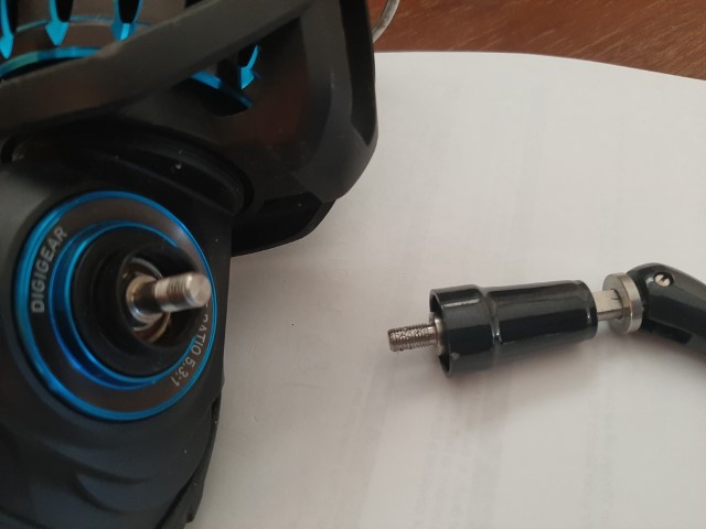

Hi all.
Somehow I've ;ost the handle to my Diawa Saltist 6500. I went online and got a replacement. Unfortunatedly the replacement handle is male. as is the reel. Can anyone tell me the right part to get and where?
Anyone know where I can get the carrect part?.jpg)
.jpg)
.jpg)
.jpg)
.jpg)

2016 Saltist
If your reel is the 2016 version then the schematic is here:
https://cdn.shopify.com/s/files/1/0060/3770/0678/files/2016_Saltist_6500.pdf?14131
Part#: 6J422801 Handle Asssembly
Order direct from Daiwa Aus here:
https://daiwafishing.com.au/pages/spare-parts-order-form
or to get it sooner, contact Daiwa (Adriano or Shaun) here:
Adriano Fulnari
Customer Service & Logistics Coordinator
Service Department
Daiwa Australia Pty Ltd
www.daiwafishing.com.au
P: 02 8644 8644
E: service@daiwaaustralia.com.au
Mark_M
Posts: 222
Date Joined: 10/04/15
USA schematic
is here:
https://www.daiwa.com/us/service/manuals/image/spinning/SALTIST%204500_5000_6500_8000.pdfPart# for 6500 is: J42-2801
one on ebay here:
https://www.ebay.com.au/itm/1-Daiwa-Part-J42-2801-Handle-Assembly-Fits-Saltist-Sa5000-Sa8000/174028568063?epid=27017566786&hash=item2884e935ff:g:dFgAAOSwRNhbz0Dr
Check that it is the same as your model.
