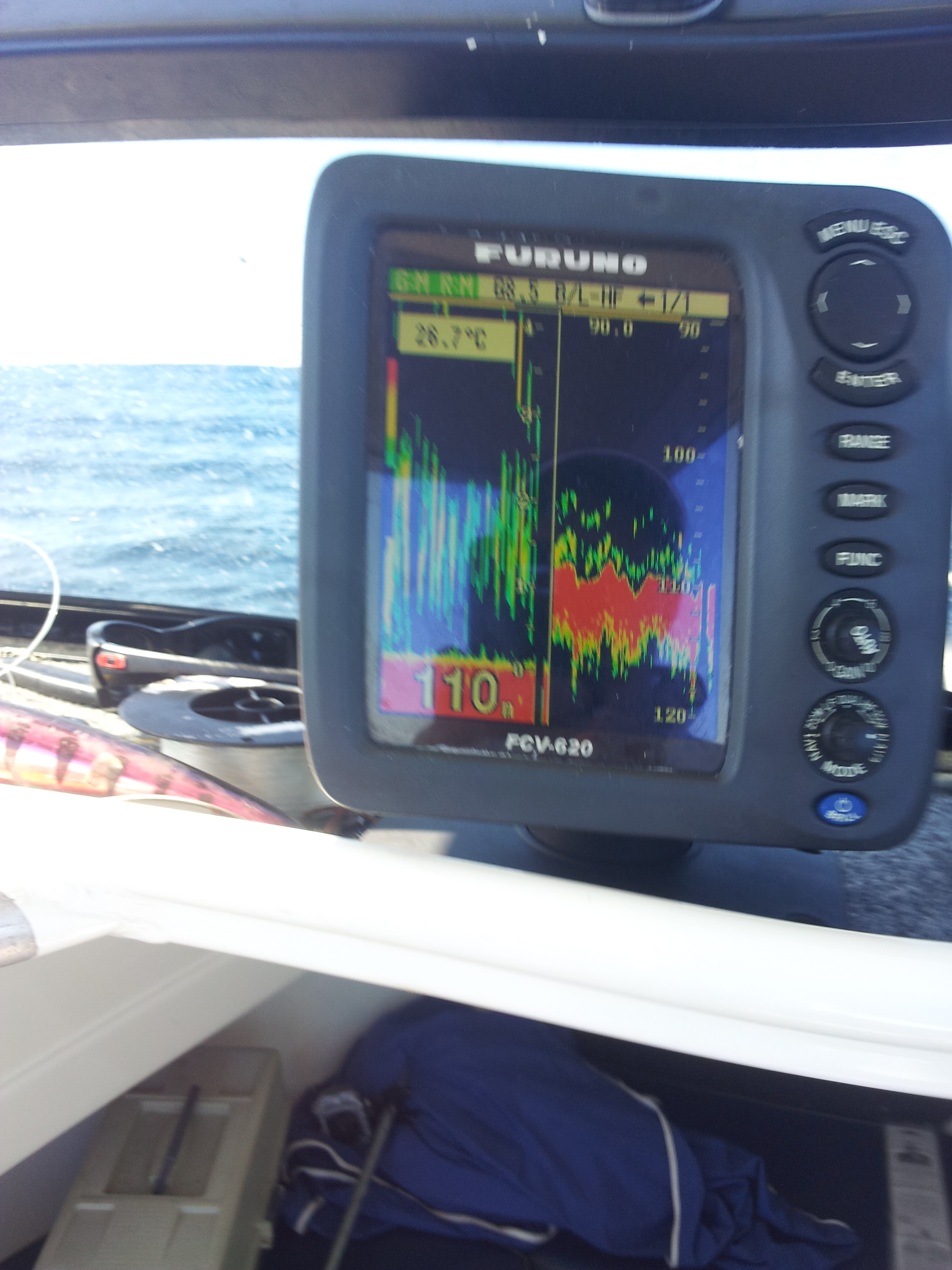

Goldband Snapper on 620
 Shot from goldband spot in Exmouth.

 Is the left hand side bottom
Tue, 2014-09-16 20:37
 Is the left hand side bottom lock?

 Irons out the illusions of a
Tue, 2014-09-16 21:00
 Irons out the illusions of a lumpy bottom eh Randall. Good sounder shot btw.

Yes
Tue, 2014-09-16 20:45
Correct, thats the bottom lock set to 5m.

Can anyone confirm that the
Wed, 2014-09-17 06:41
Can anyone confirm that the bottom lock function on Lowrance units is simply a zoom function? there for can still create "lumps" from the swell?

 On my hds10 the bottom lock
Wed, 2014-09-17 07:36
 On my hds10 the bottom lock still produces lumps from the swell, only use the hds10 for GPS and 587 for sounder

Bottom lock
Wed, 2014-09-17 09:46
BL causes a flat line to the second half of a split screen and is flat no matter what the surface conditions are like.
Some models like the JRC FF series have bottom differentiation on their BL which enables you to predict bottom type by the length of tails on the trace.
Whatever the case, it is a flat line which project fish as "flare ups".
As far as I know (not 100% sure), only the Japanese sounders have a true BL - Furuno, JRC, Koden.
I think Garmin are tapping into it now with their new models. Furuno had BL from the start even with their basic B/W sounders (LS4100 and 6100).
Its not "bottom zoom" as some people get confused with.
Hope this helps.

Nice pic
Wed, 2014-09-17 10:12
Yep, bottom lock on the left, bottom zoom on the right
