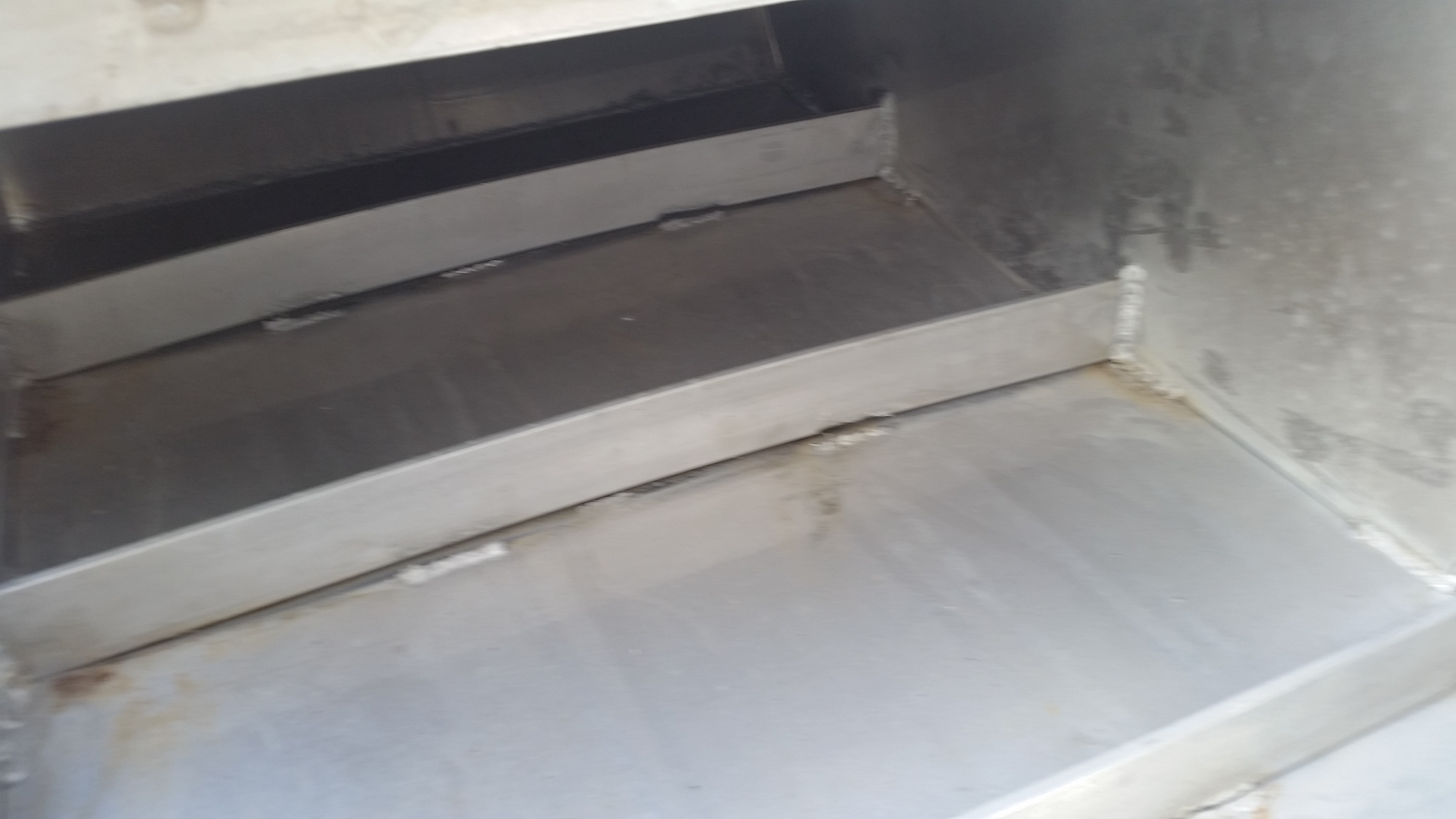

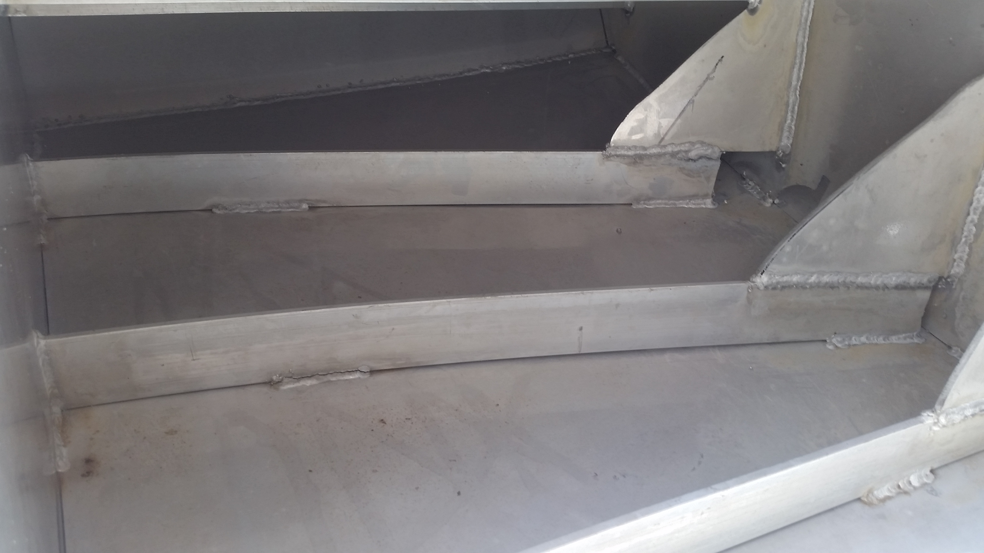

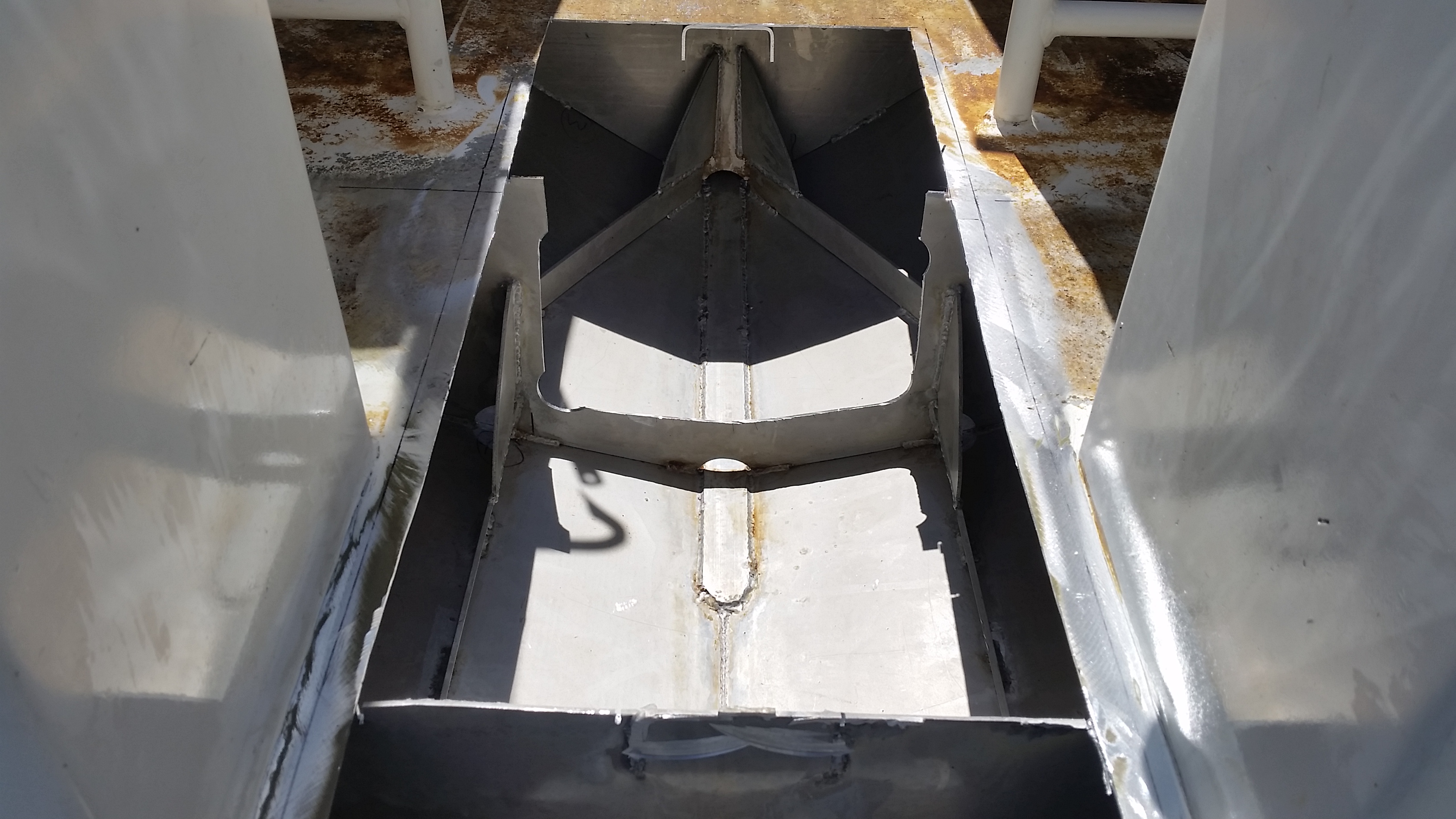

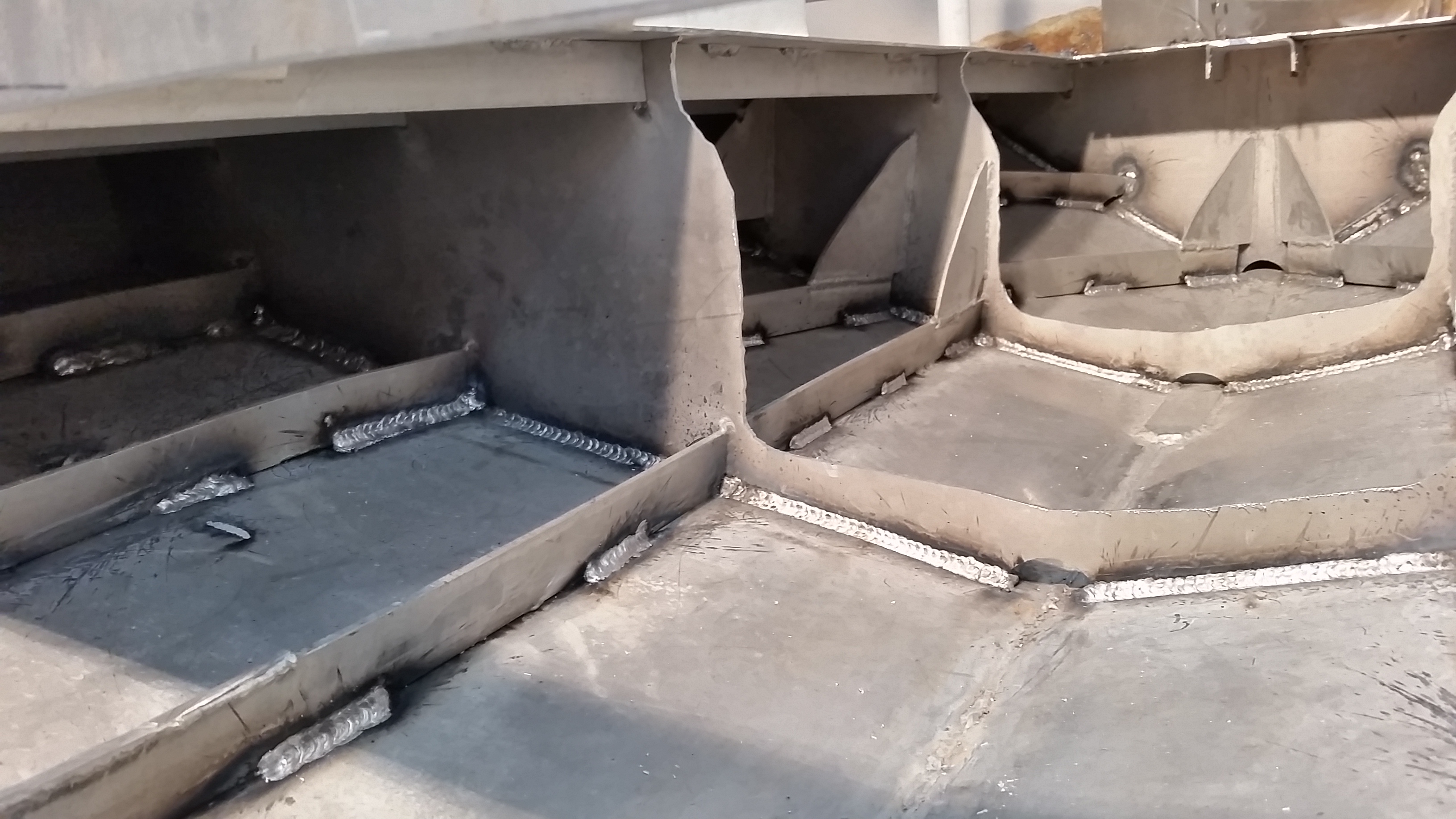

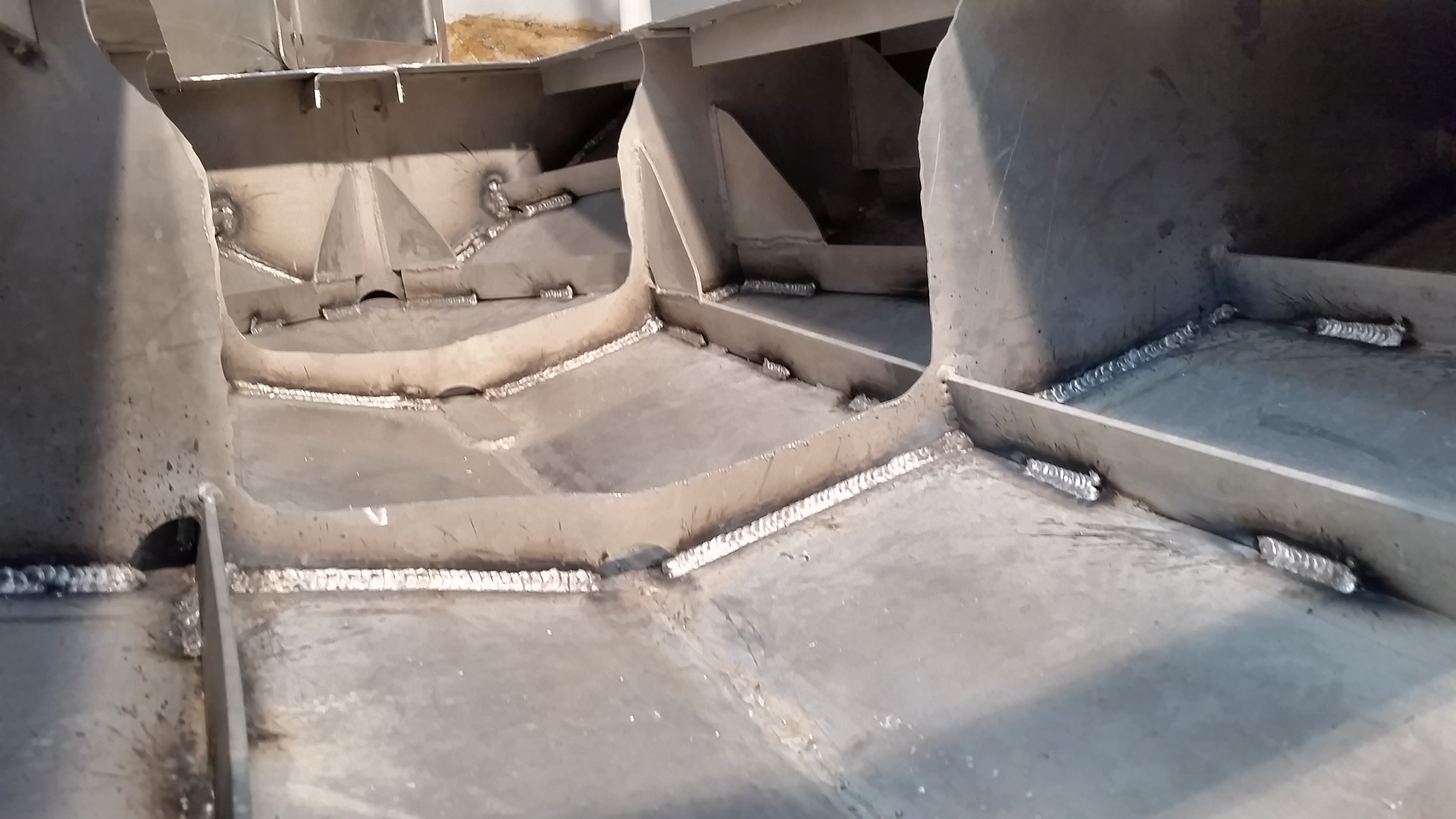

 This is why I tell people to get involved in construction of there product very well known boat will not name and this was their idea of a welded out hull no wonder its cracking up so thought I'd actually fix it properly

I'd be naming them.
Thu, 2015-12-24 12:11
 That welding is crap, no penetration for a start and not enough material. Suspect it was done by someone who had no idea of aluminium welding. One of the aluminuim crayboats I skippered was badly built, I spent the next  8 years or so in the bilge every off season watching blokes who knew what they were doing, gradually overcoming the original poor workmanship. Had to do it that way, the owner wasn't that keen on spending the money to do the whole job properly in one hit.

your welds
Thu, 2015-12-24 18:11
 look thick and strong and plenty of length in them  cheers Pete

 Didn't want to really
Thu, 2015-12-24 20:54
 Didn't want to really comment on the shitemanship. But that is very average to say the least, fillet size, not enough stitching , lack of fusion , and general lack of quality to say the least. Basically someone who don't give a F&^(k!

 almost every defect that can be in a weld is present. well almost. Anyway, when it comes to quality and quantity these builders need to compete with the foreign market. Something like 10hrs per foot is what i have been told. The foreign builders that we all say have minimal standards are actually coming to the top of their game. I am not involved in boat building but work directly with a few reputable boat fabricators. 1 of them built a 24ft x 60ft ali cat in his backyard in mandurah, I have alot of time for him and his knowledge and his information is invaluable!
Sad to see a customer has to find this crap quality on what looks to be decent boat.
