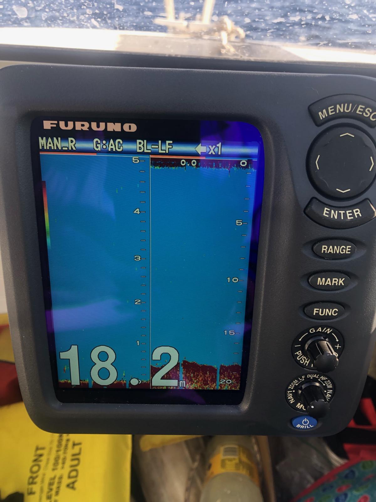

Need some help with our new Furuno FCV 628 (2019)
Does anyone know how to move the Metres info from the bottom of the screen to the top?
Can't seem to find how to do it
Thanks

Make it smaller
Mon, 2019-06-10 17:53
 You can drop the depth size down to small. Menu/display/depth size = small

As above...I've seen it up
Mon, 2019-06-10 17:57
As above...I've seen it up top but not sure if possible on all models...this is from 627-587 manual

Shifting depth reading
Mon, 2019-06-10 19:12
Asked the same question on the Boating Electronics Help and Discussion Settings page on Facebook today (good page to keep tabs on). Mark Reid who is a Furuno guru gave me this information (I haven't tried it yet), Turn off depth in display, press menu go to data, selact data box 1 or 2, enter and then select. This is for our Furuno 588 should imagine the 628 would be the same. Making the numbers smaller do as Jason P advised. hope this helps, but do join the Facebook page as I've mentioned as you get a lot of help and suggestions on settings etc.

I've done it with my 627 but
Tue, 2019-06-11 20:03
I've done it with my 627 but can't remember how. I'll try remember to hook it up this week and check the setting

Thanks to all you guys info
Tue, 2019-06-11 22:22
 Thanks everyone, Paul D your a champion, worked perfect! Thanks heaps
