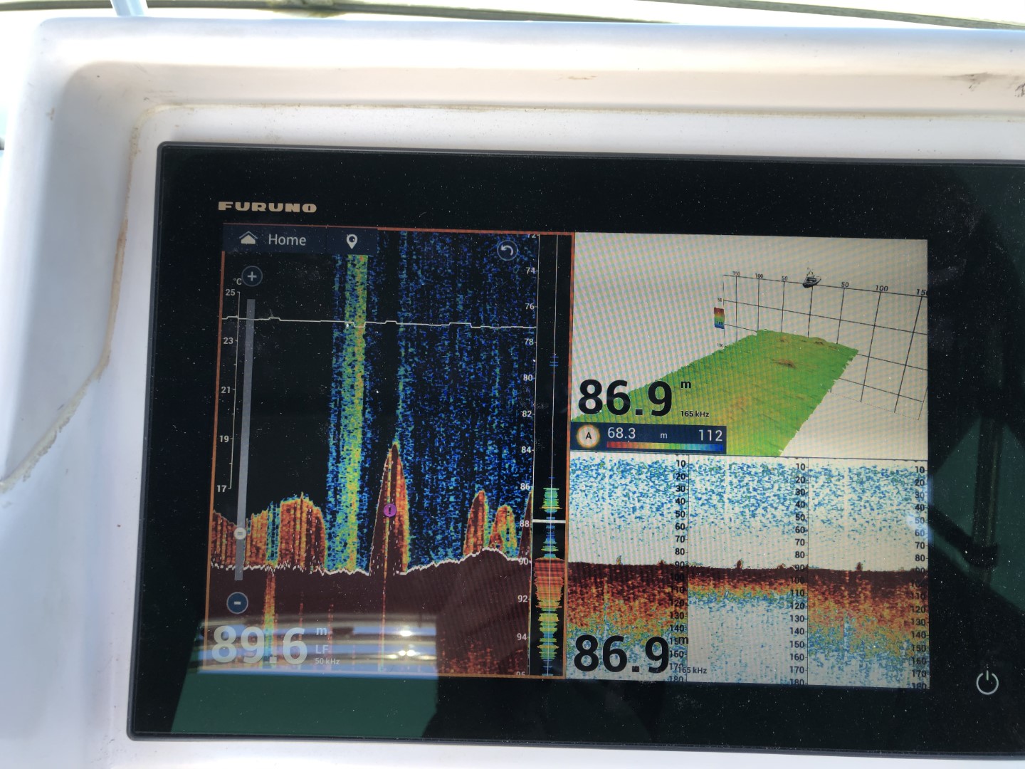

After a number of setbacks with the boat and installing a new fuel tank I finally got out to play with the new Furuno DFF3d setup.
Is a really different look and takes a bit to get used to after using the traditional Furuno sounder.

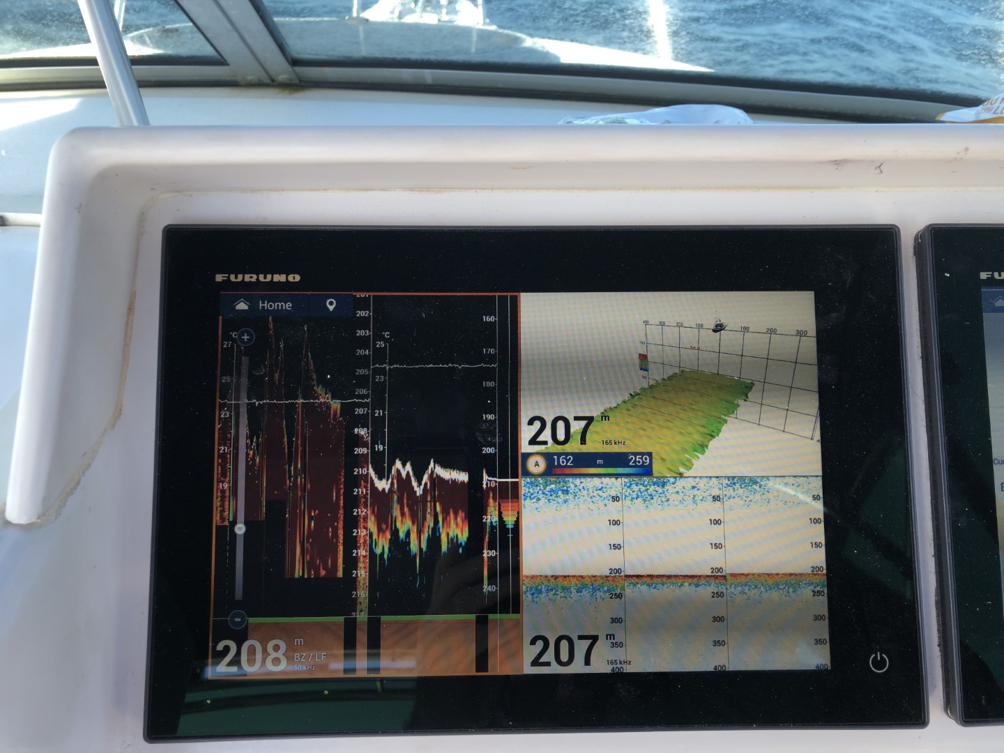

1st pic is the 3d view and the 2nd is the same ground in traditional sounder view.
The 3d view really lets you understand where the boat is in relation to the structure.

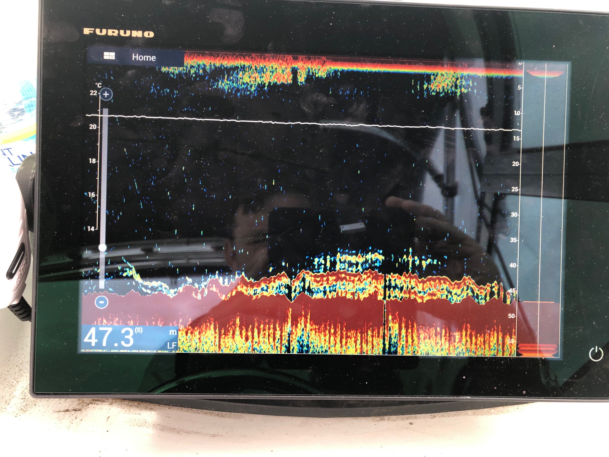

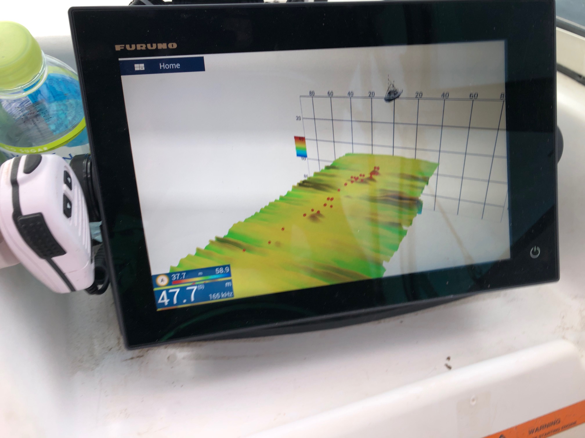

Picture 3 really highlights this with a mix of traditional, 3d and triple beam.
You can see the lumps on the traditional screen but the 3d shows that the lumps are positioned in different lines to the boat.
The triple beam gives you 3 differrent cones and allows you to tell if the better return is on the port starboard or under the boat.

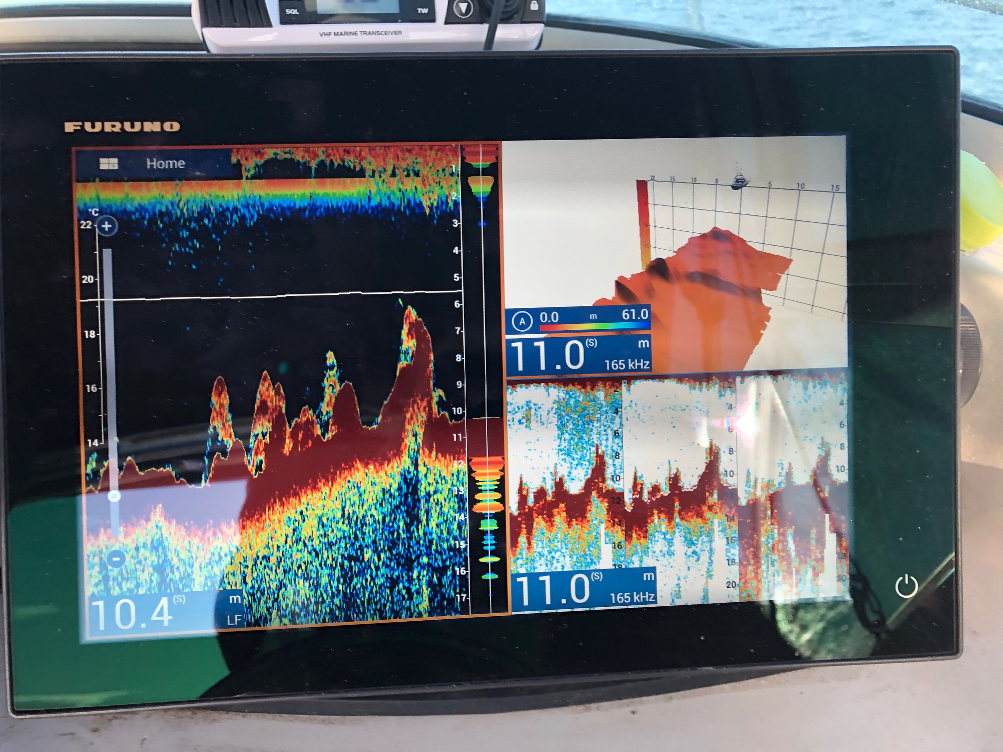

Thought I would share some pics from the weekend. Finally got out deeper after a heap of rework on the boat and electronics.
The furuno DFF3d was working in 200m+ at 20 knots. Very impressed with that as I still need to worek on settings.

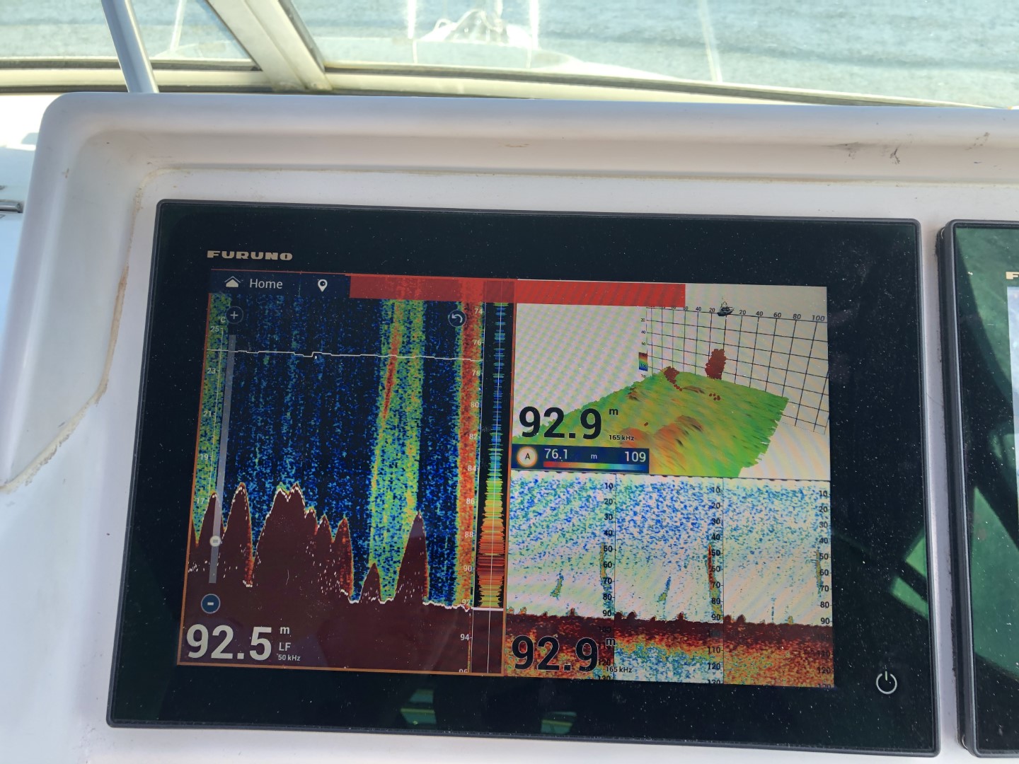

Finally got some pics of the 3d deeper. You effectively have side scan in 200m+
Is interesting to compare the traditional pic to the 3d and how you may interprate the bottom.
