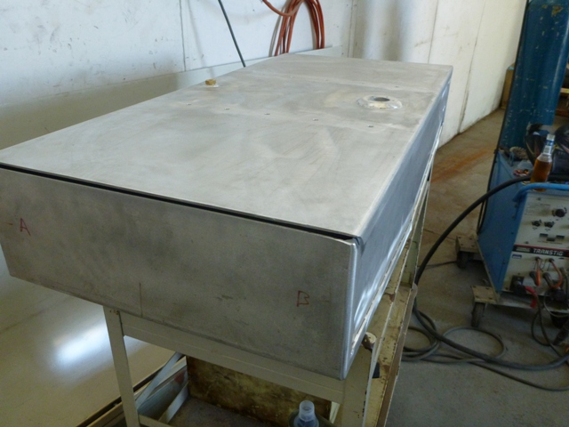

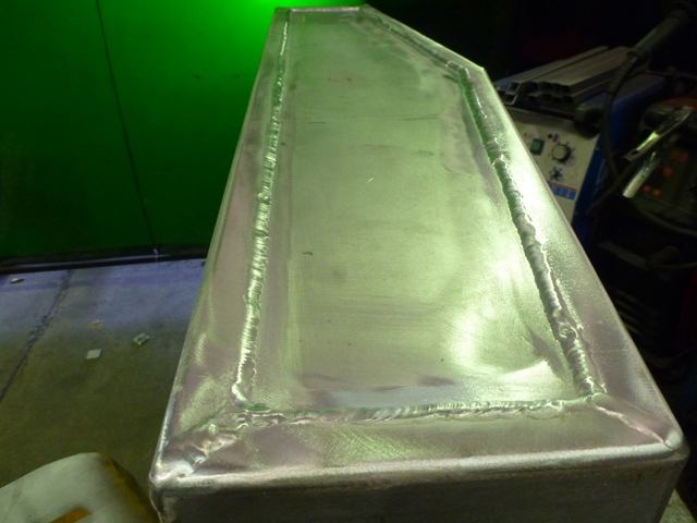

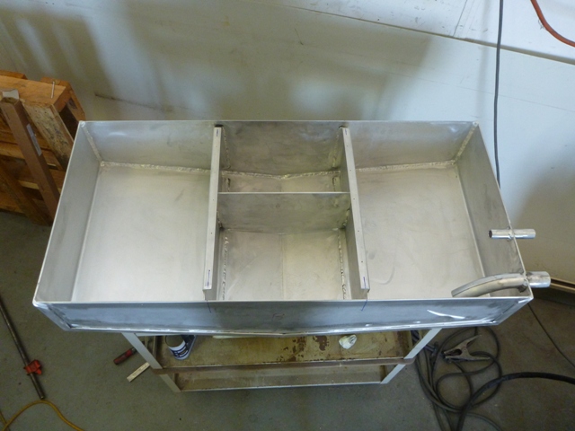

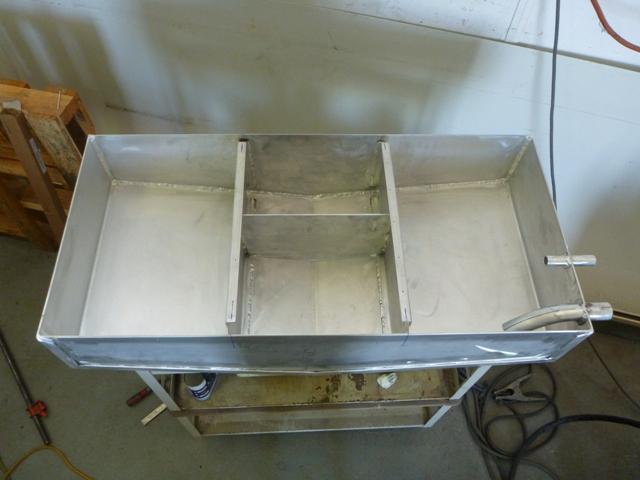

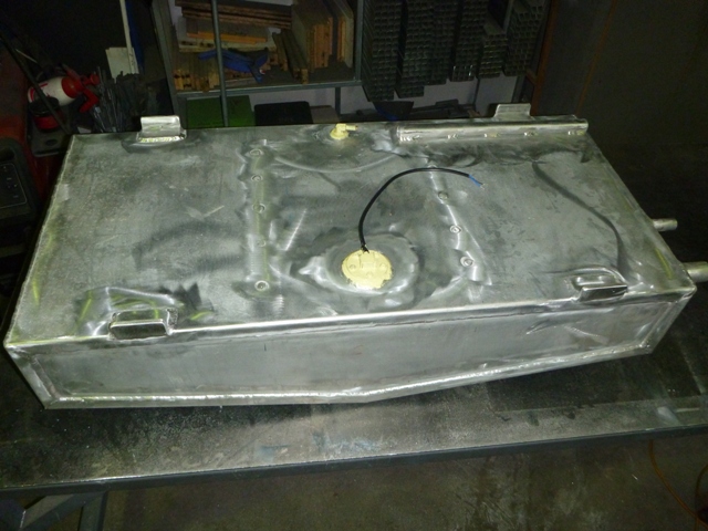

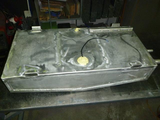

The fuel tank was in bad shape with holes and pitting so i decided to make a new one . I had to stay with the same shape to fit it under the floor but made it alot thicker using 4mm alloy .
Fuel tank in progress

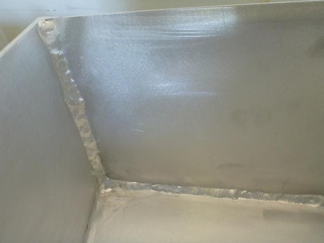

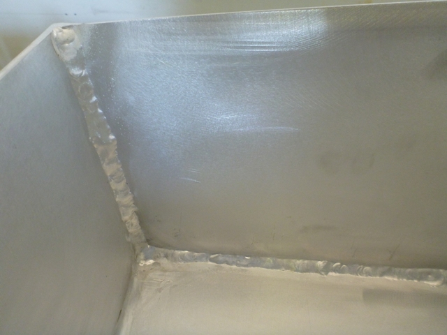

All the inside joins were welded on the bottom section
The top section was welded from the outside only , the bottom section was welded from inside and outside.

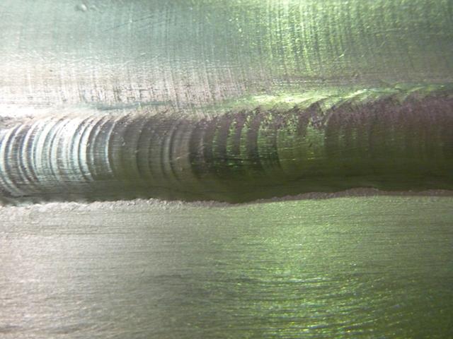

The lap joins welded
By the end i was getting some nice welds.
Here is the tank with all the fittings in place,Sender unit and pickup . It has been preasure tested and ready to go in the hull.

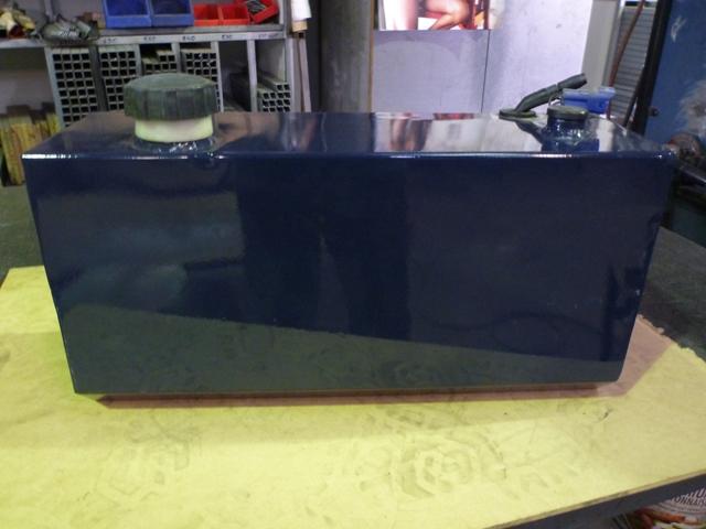

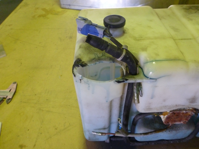

I cant aford to replace the motor yet and being a 2 stroke i realy needed to sort out the remote oil tank. It was broken and the plastic was too brittle to do a cheep fix up.
So i went to get a new one. Found one at a dealership and got the price. At $980 complete, or $280 just for the plastic container , i prompty told them to go f@ck themselves and returned to my factory to make my own. Now i know boating parts cost alot, but that was just taking the piss. IMO

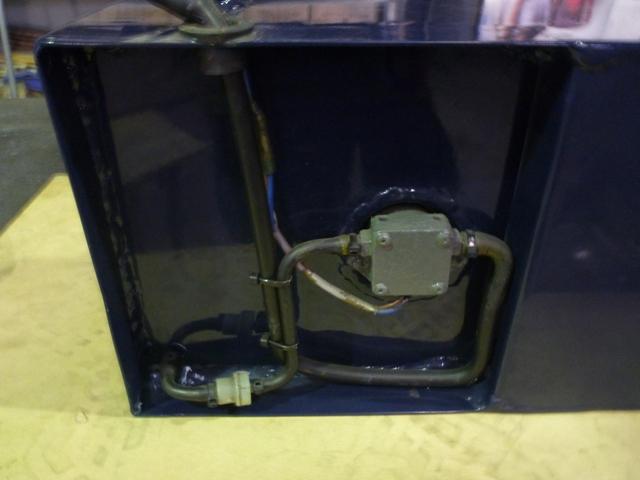

I removed the pump and fitting to see how bad they were. Just surface rust on the pump so applied a rust convert and paint. Then came up with a design so the tank would fit into the side pocket on the boat out of every ones way.
I fitted sender unit , the filler cap, and the pump went into the back of the tank exactly like the original. 4 hours later i was glad i still had a grand in my bank.

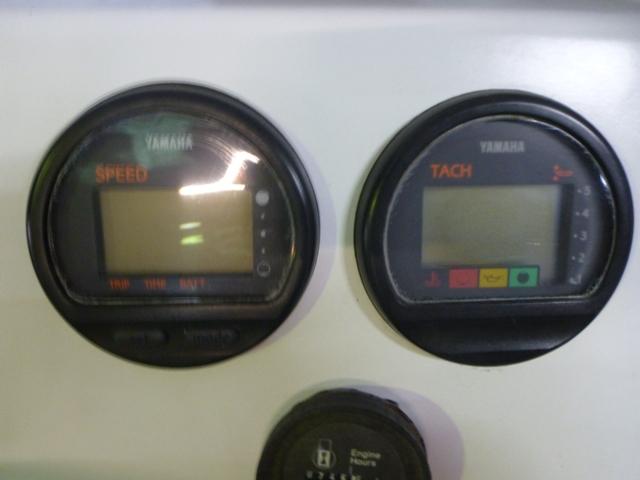

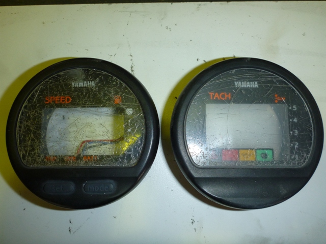

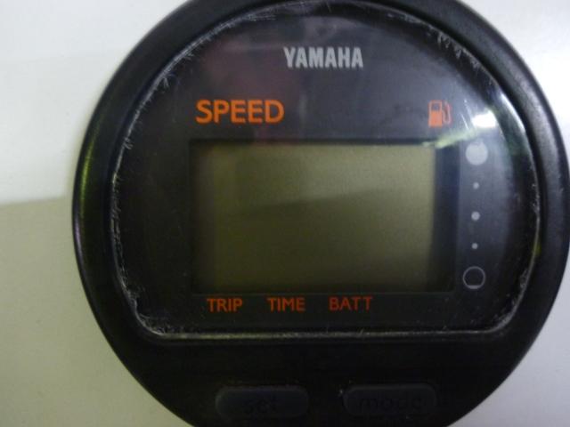

Another problem to over come was the gauges for the motor. They had sun damage and scratches so bad you could hardly read them.
Again i thought , I'll just replace the covers. No you cant get them, you have to buy new gauges. Ok so i'll price them up, $700 thanks mate. Again, I not so politely refused their mates rates offer and bought a lense pollish kit from an auto shop. A couple hours later and some elbow grease they were good to go. Not perfect , but good enough for me to use for a couple of years.

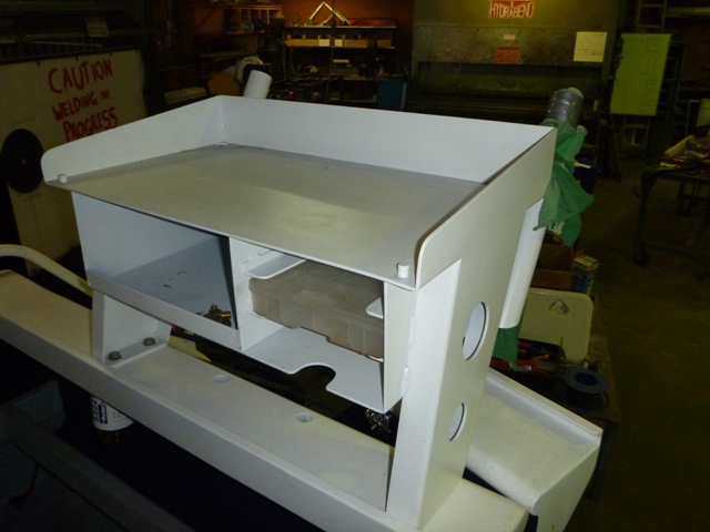

Went to buy a bait board, again came back and made my own complete with a 3 tackle box rack.

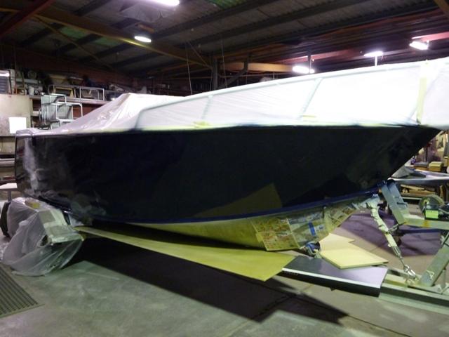

I repianted the hull last Xmass . For my first try at this ( I got alot of advise first ) It came up pretty good for and old boat.

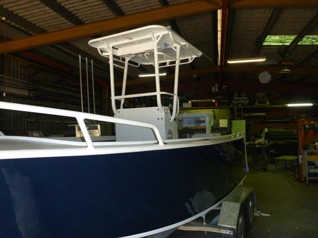

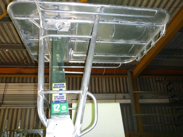

I now started on the T-top. After looking at ideas online i got the frame work in place . I made it bolt on, so i can remove it if needed. I reinforced the console inside to prevent it moving around and tearing the aloy.

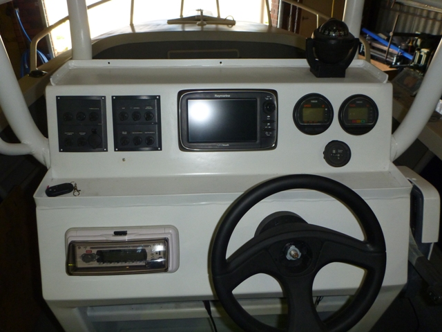

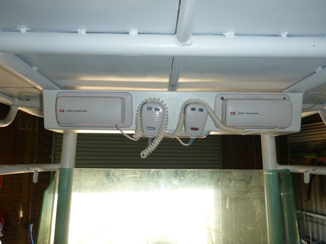

I fitted the marine radios up high and gave it a lick of paint.
The console is starting to look good with the in struments in place.
Many other items done ( too many to list ) but she is starting to get close to the final fitout.

 did you know tooth paste works great for polishing gauges as its a very fine cut and polish and i dosnt cost $50 like that stuff they sell in the shops

the design of the bait board, very cleve idea of shelving underneath.  Old fart put a couple of holes in his fiberglass one so the water could drain out and also a ledge so the bait knife wouldn't go into the ocean if a bit rough,  just a thought.

Yeah Roberta , got to have a good bait board. Yes each compartment has drain holes , i know how water finds its way into everything . I have built a few dry storage areas too for personal items., will post some pictures later.

 that looks great Grant, the
Mon, 2014-06-02 15:30
 that looks great Grant, the baffle setup is good.
Goes to show that NOONE will ever take as much care in their work as you do yourself.
Most mass manufactured tanks dont have a good setup, even my Cruisecraft one I'd like to modify as it is quite long so sloshing as it gets lower is a problem.
Either a much better baffle setup or better split it into 100/200 litre compartments.
grantarctic1's picture
Posts: 2546
Date Joined: 03/03/11
Most tanks
Mon, 2014-06-02 15:49
Most tanks i looked at ( and the one i removed ) only had 2 baffles splitting the tank into 3 sections. Like you said this can still cause problems. A few people i talked to had very simular problems when the fuel level got below 1/3 . As they powered forward the fuel would move away from the pickup causing it to gulp air .
Thats why i added the 3rd baffle. It is not quite centre, but more towards the pickup. I am hoping this will reduce the fuel moving away from the pick up too much when i give it some throttle.
I would have liked a bigger tank, but had to work with the room i had . I worked it out at aprox 130L . Should be enough for most metro fishing and i will always carry a spare 20L for safety.
