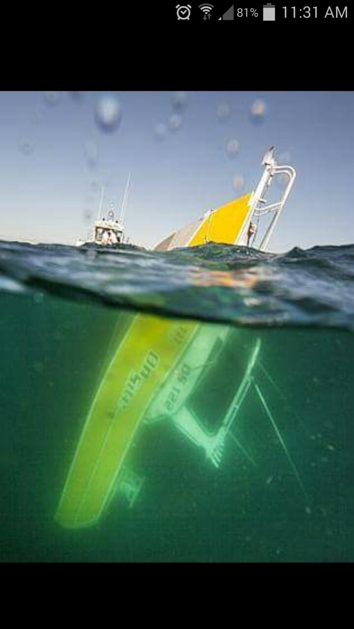

Forgot the bung?
 Forgot the bung?
 oh dear

Bung?
Sat, 2015-02-21 12:02
 Could have been all sorts of things but most likely is bungs or the plastic inspection hatches they put on the motor pod

 Dam, looks like the outboard
Sat, 2015-02-21 12:03
 Dam, looks like the outboard is missing too.

My thought
Mon, 2015-02-23 13:33
Maybe something happened with the transom first causing the flooding!!!

Posts: 128
Date Joined: 09/12/09
 Got two bilge pumps
Sat, 2015-02-21 12:41
 Got two bilge pumps separately wired up. Pumps twice as fast plus redundancy.

Bit more then faulty pumps
Sat, 2015-02-21 12:48
 There has to be a root cause, poor bugger, hope he's got insurance

all going well the pump
Sat, 2015-02-21 16:32
all going well the pump should not be doing much work at all.

How does a wave swamp a boat like that
Sat, 2015-02-21 18:16
 9 news report

 backing down against the
Sat, 2015-02-21 20:17
 backing down against the slop and catching one over the transom?

sunk boat
Sun, 2015-02-22 09:27
 read this: “The wake washed up into the back of the boat and we couldn’t power on to clear it,” boat owner Nathan Colgan said."
Well then, what I would have done is put out a sea anchor so that the
Boat is facing into the waves to give me time to get the motor going.

shows you how easy a boat
Sun, 2015-02-22 12:05
shows you how easy a boat without true flotation can sink......

Funny how many think a self
Sun, 2015-02-22 13:44
Funny how many think a self draining deck makes a boat more seaworthy (it does but only to a point).  it is a great way for clearing water quickly however once those scuppers go under the waterline the water will come in rather than out and it becomes self sinking - particularly if combined with cockpit hatches that don't seal properly.
Not to say I wouldn't have or go on a boat with a self draining deck

How does someone not notice
Thu, 2015-02-26 20:27
How does someone not notice the sluggishness and instability that amount of water would cause?
not very tuned into their boat and it's behaviour I would say.
